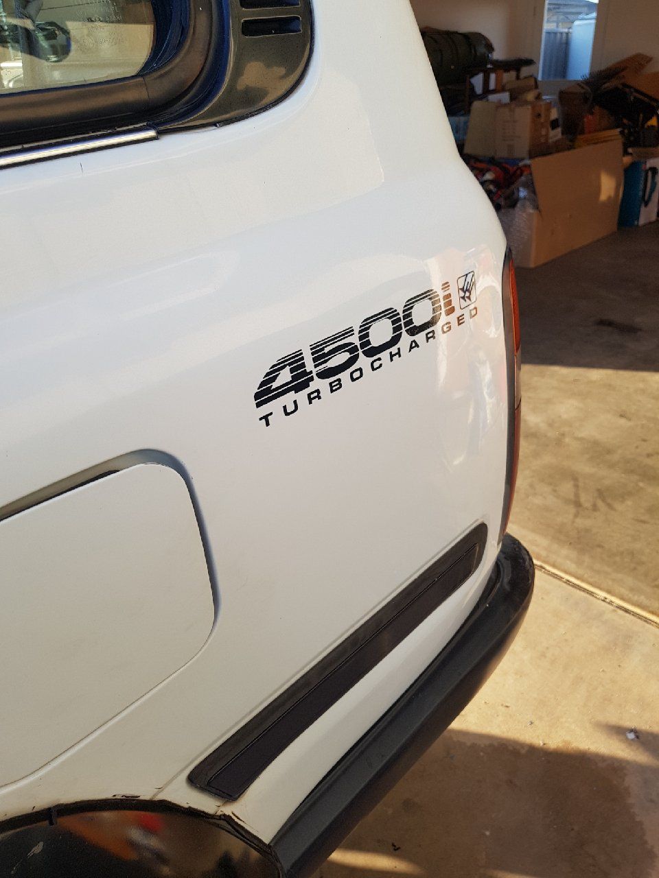

A bit more bling this afternoon - getting the old stickers off was painful.
After a bit of messing around it ended up a bit of a process:
1) Soften/heat sticker with heat-gun and steam
2) Use old bank card as a 'scraper' to assist the softened sticker off
3) Wipe off residue with turps and isopropanol
4) Clay and Polish area where sticker came off to clean up any oxidation and anything else on the paint
5) Final wipe with isopropanol and then put on new sticker
