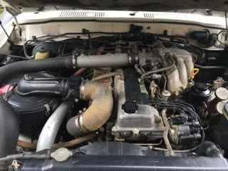

2) So, since HDJ80s are expensive for what I want to do with it, and 1HZs are slow it was necessary to step into unexplored territory - petrol (Gasoline) powered cruisers. After a bit of research, it seemed that 1FZs seemed to take boost well, so seemed like forced induction was a good way to go. There aren't many turbo or blown 80s around these parts so had to be patient. Anyway, long story short, I just missed a green 95 with a well-executed 'home-made' setup on it - cast manifold from I think it was Turboglide, GT35, W2A intercooler etc, and lo and behold, Gumtree suggested another 80 which so happened to have a Safari Turbo kit on it. So, after having a look, I am now the owner of a 95 FZJ80.

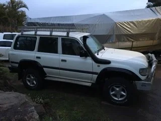

The truck as she sits is an Australian Market FZJ80 GXL so RHD, 1FZ-FE, H151, HF2A full-time case, 4.10 diffs, factory CDL and rear LSD, cloth seats, power windows, and so-on She's got a couple of mods already, namely:
2" lift - seems to be Lovell's springs and Koni shocks
TJM alloy roof rack

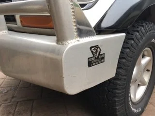

Custom made Herd alloy bullbar
3" exhaust from Safari
Snorkel
