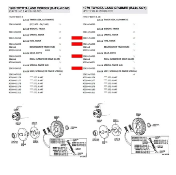

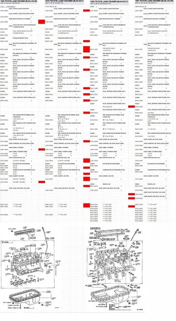

I compared late B diesel (March 1980) with 2B (early and late) and 3B early version. I attached files with comparison but as it was already mentioned early 2B diesel (1979) is very close to late B (before 08/1980).
Result of comparison (B vs 2B):
Head - no difference;
Camshaft - no difference
Block - Cylinder Liner (sleeves 11401-59046 vs 11401-59056) external dimensions for sleeves are identical (ext diam 102.00; height 190.00, ext diam of upper part shoulder 107.60, shoulder height 3.50)
Diesel pump - no difference (only minor washer 22119-77020 vs 90201-12109)
Crankshaft - Pistons (13101-56021 vs 13101-57011) and Piston ring set (13011-56013 vs 13011-57010)
Automatic timer - changes are visible
Both engine have the same valve clearance (hot) Int 0.20mm, Exh 0.36mm and Injection timing 14 BTDC
But different parameters for pneumatic governor & injected volumes for Injected pump.
Am I correct that B to 2B upgrade is possible by 2 steps:
Replacing Liners (sleeves), Pistons, piston rings, Automatic timer
Adjustment of Injection pump parameters?
Thanks for your feedback
