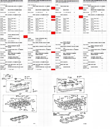

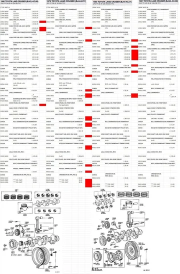

Hi, I restore BJ43 03/1980 close to OEM standards and try to discover opportunities to overhaul B diesel with slight upgrade in hp but without visible changes (so no 3B, 13BT, HT, HZ etc).
So the only theoretical invisible solution is upgrade to 2B diesel.

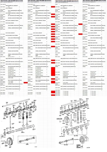

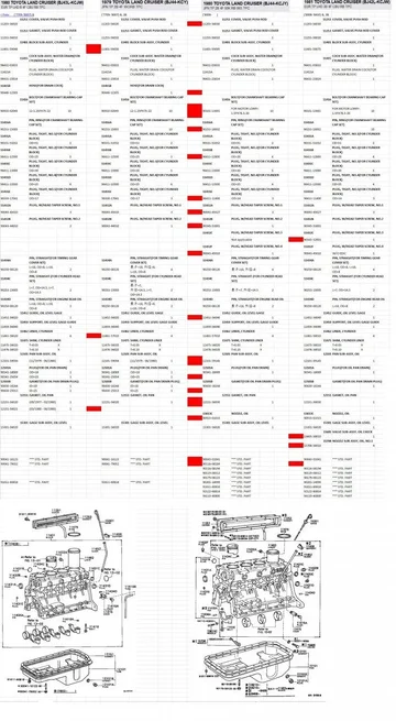

I compared late B diesel (March 1980) with 2B (early and late) and 3B early version. I attached files with comparison but as it was already mentioned early 2B diesel (1979) is very close to late B (before 08/1980).
Result of comparison (B vs 2B):
Head - no difference;
Camshaft - no difference
Block - Cylinder Liner (sleeves 11401-59046 vs 11401-59056) external dimensions for sleeves are identical (ext diam 102.00; height 190.00, ext diam of upper part shoulder 107.60, shoulder height 3.50)
Diesel pump - no difference (only minor washer 22119-77020 vs 90201-12109)
Crankshaft - Pistons (13101-56021 vs 13101-57011) and Piston ring set (13011-56013 vs 13011-57010)

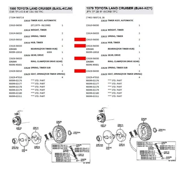

Automatic timer - changes are visible
Both engine have the same valve clearance (hot) Int 0.20mm, Exh 0.36mm and Injection timing 14 BTDC
But different parameters for pneumatic governor & injected volumes for Injected pump.
Am I correct that B to 2B upgrade is possible by 2 steps:
Replacing Liners (sleeves), Pistons, piston rings, Automatic timer
Adjustment of Injection pump parameters?
Thanks for your feedback

Thanks. I will anyhow overhaul B engine and it looks like new sleeves&piston&piston rings for B or for 2B cost the same, so I will not spend extra money. Used 2B automatic timer should not be an issue too. All 2B plans for Inj Pump are visible in manual, if repair shop overhaul IP then they always need to adjust all parameters - I assume B or 2B - price prospective should be the same.
Invest the same amout of money but get +10% hp - looks attractive
Invest the same amount of money but get +10% hp - looks attractive

Just to sum up the findings regarding B/2B/3B upgrade
Main parameters are on the picture (hp European DIN).
From B to 2B an upgrade is possible without a block boring. Just sleeves, pistons and piston rings from 2B. Plus you stay with a B cylinder gasket.
From B/2B to 3B an upgrade requires boring and 3B gasket.
Here we talk only about the volume of the engine, but not about other modern features of 3B.

Short update of the tread.

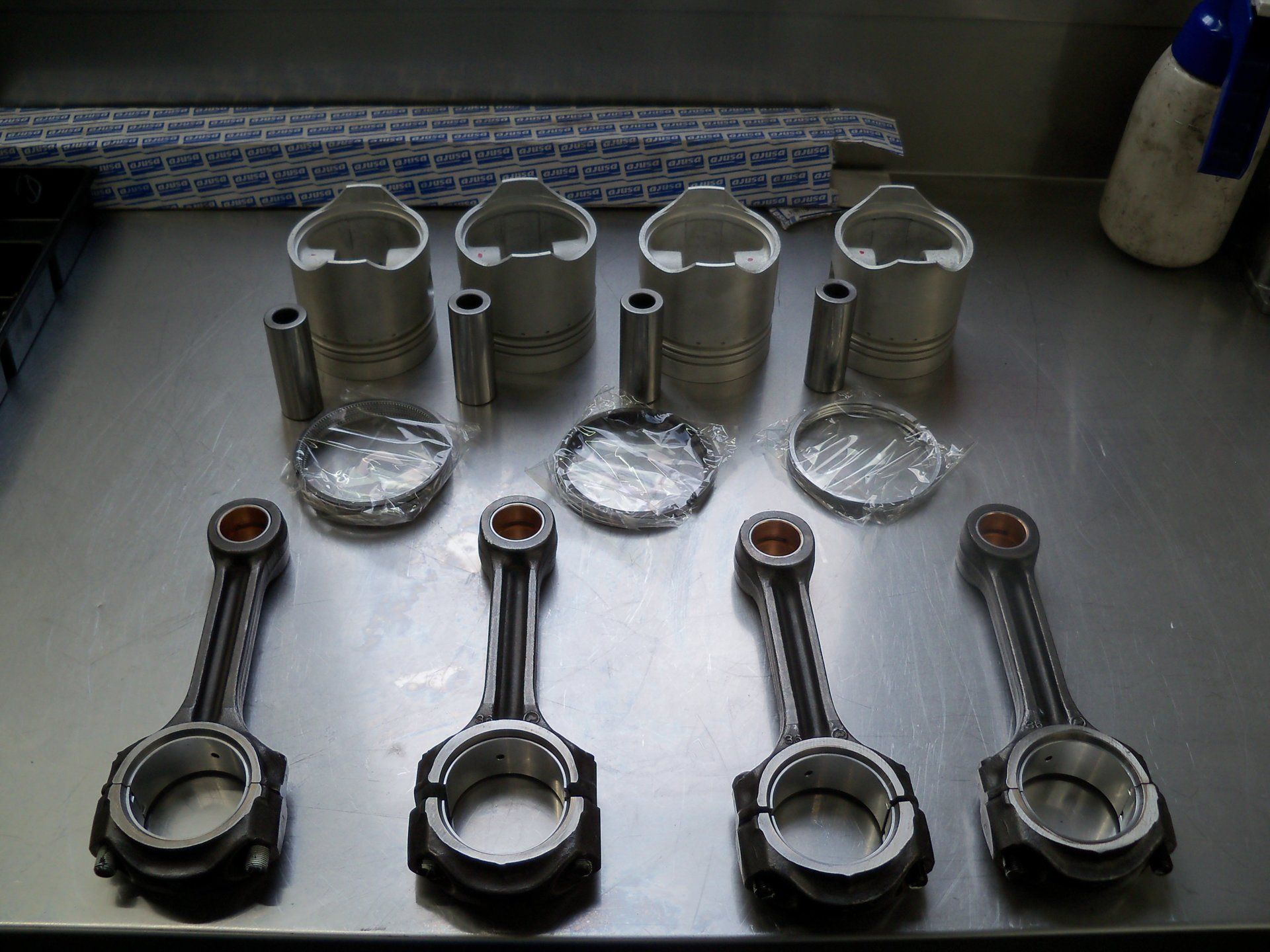

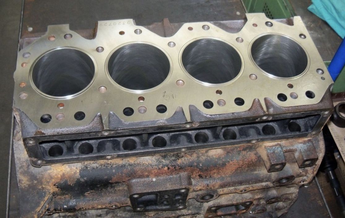

Finally I‘ve upgraded my B diesel to 2B volume.
Originally I planned to use 2B sleeves. When we removed the sleeves the block around sleeves had some wear. In case if we press the 2B sleeve it would take the ellipse form of the cast iron block. It’s not very useful for a long life of the pistons.
We decided with the overhauling company to press the “thick” B sleeves and bore it inside of the engine.
In order to explain - there are two types of the sleeves with the same external diameter B and 2B.
B sleeve has a thick wall (3,5 mm), 2B has a thin wall (2mm). When you press B “thick” sleeve it takes the ellipse form, then you bore it to the perfect round of 98mm.
So we did it.
Thick B sleeve
Pressing
Boring to 98 mm
Honing
New 2B pistons & rings
Assembling
Ready
There is no problem with automatic timer and diesel pump. Plug & play.
As a result. This upgrade brings extra 7hp. Not much to feel when you drive. I assume it worths if you plan overhauling or would like to refresh the engine. I would not recommend to do it if your engine is in a good shape.
