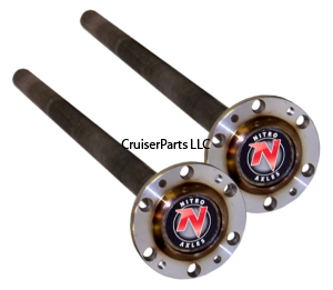

For aftermarket, these are the only ones I know of
I think they cut the splines long enough so they will work on factory e-locker models also, but not sure. Buyer should verify.

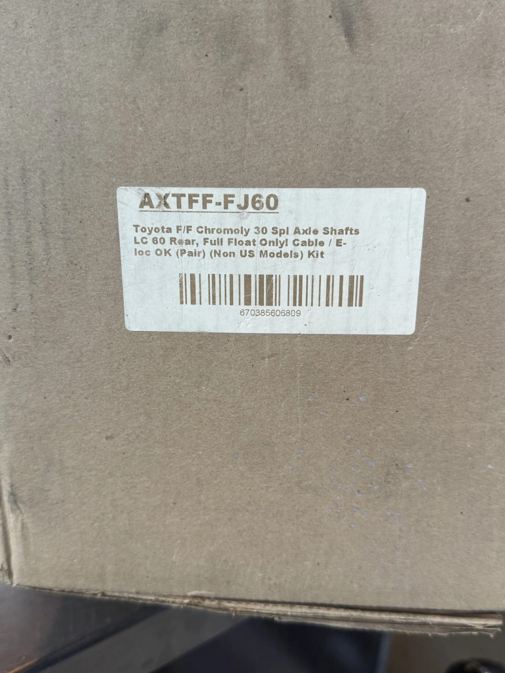

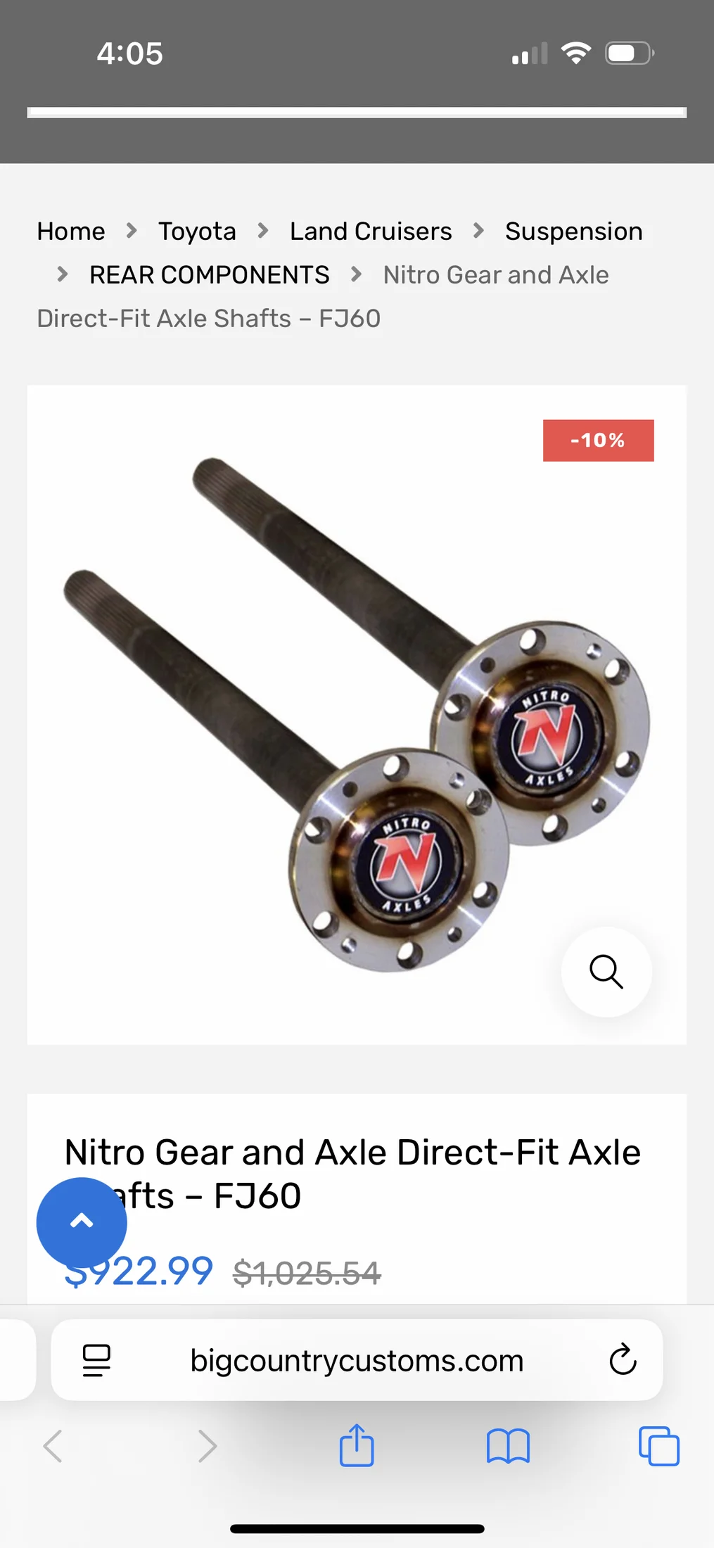

Luck of the Irish! As they say. Local shop in Abbotsford has them in stock. Couldn’t believe my good fortune. Picking up Friday before. Cruiser Days and a 3 day backcountry trip into the mountains. Price is good. Thanks for everyone’s help. Lucky in Canada in BC there are 3-4 new shops with really smart guys and good work. This is one of them. Big Country Customs, Abbotsford.

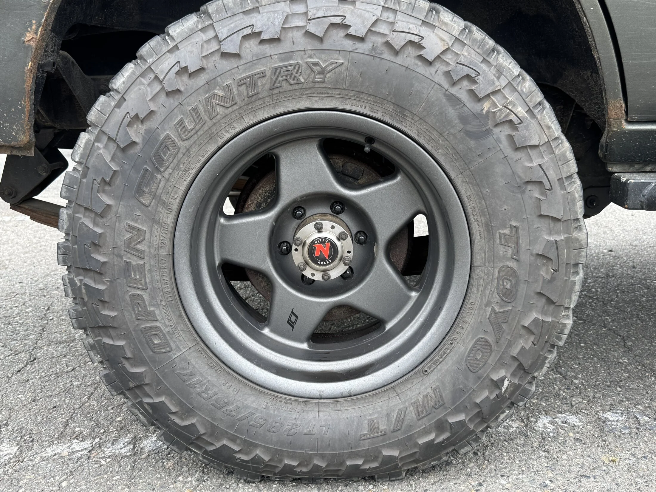

They’re in! Fairly cool exploration trip this weekend after Cruiser Day up Harrison Lake so test track this weekend. I’m submitting the part number. I have a friend who now wants a set, any help would be appreciated. Glad to hear about RCV above. Thanks. He has emailed them to ask as well. Ironic as he is the guy who found these for me.
