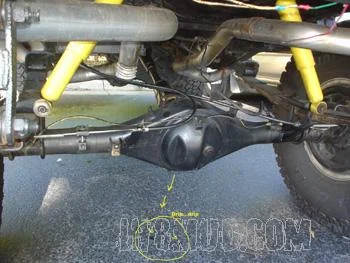

mdjohnsen said:What type of brake shoes should I get? They need to be replaced pretty bad. Also, I am looking to replace all of my fluids. What type of gear oil and weight should I use?
isotel said:looks like a late (Wide) one, i can tell by the way it necks down between the pumpkin and spring perch, Im guessing 86-94... WMS-WMS would be 58"
55" for the SAS Trucks Pre-86
Pretty strong axle, and relativley cheep gears/Upgrades..
