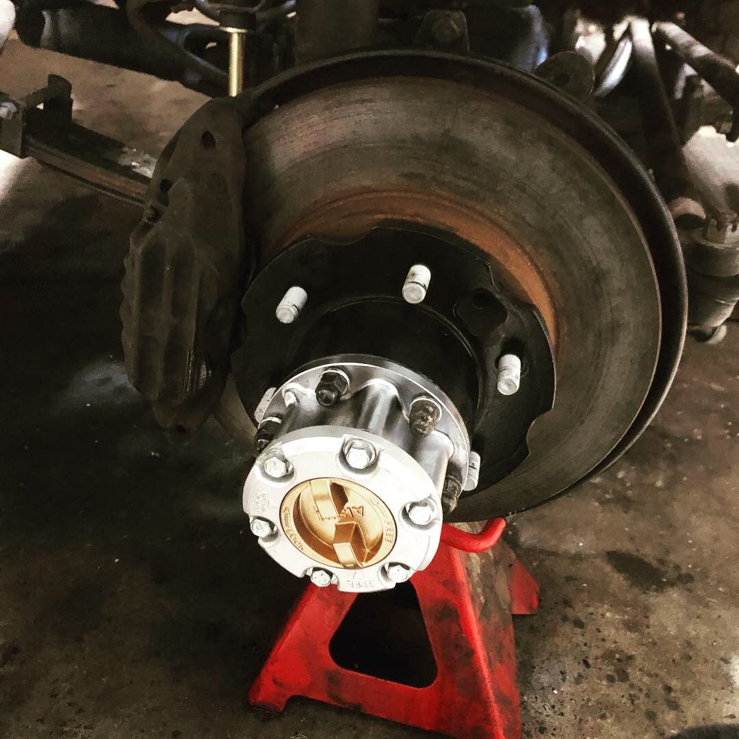

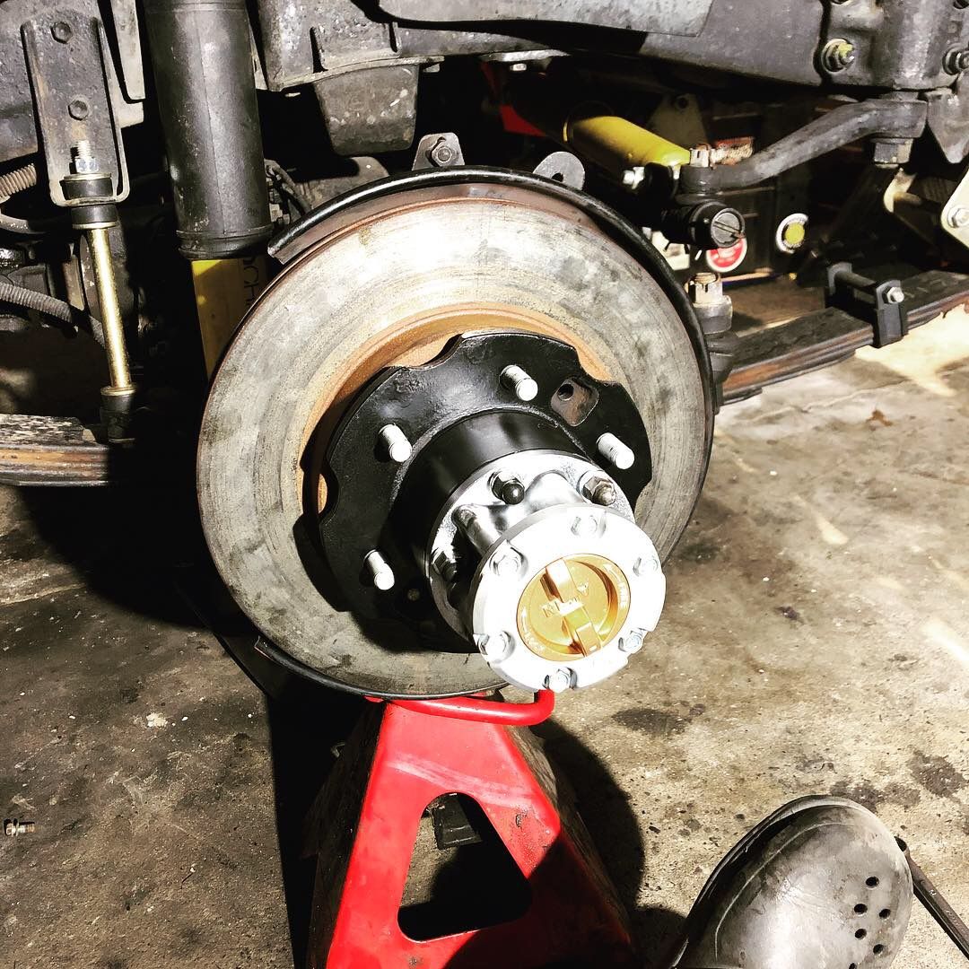

Just did this on an HZJ77. This is what the outcome will look like.
1902514
1902515
I'm probably wrong, but on an LJ78 you either need a spacer or a manual hub with the spacer built in. there is only one I've seen and it's an ADM Not as pretty and not as robust as the aisin that beno has from what I understand.
Or get the correct parts to do the conversion and not mess around with spacers and the like.
Do what Beno did.
Keep an eye out for a 79-85 Toyota mini truck/4Runner front axle. Get one as complete as possible. Should cost between 250-500 (Canadian funds).
Rob the steering knuckles, spindles and freewheel hubs. Time it around the time you decide to rebuild your front axle to save money and time.
Sell off the striped axle for 100-150. Sell off your one working hub for 100(?) sell off the mini truck birfs for 25-50 bucks a piece. You will be money ahead and have a stronger set up than anything else out there.
I did this exact thing on mine as well. Never looked back.
