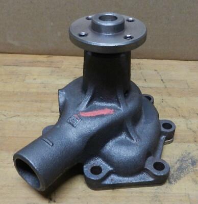

The F135 water pump in NLA. I think the most common solution is to adapt a water pump from the F155, you can still find those. Here's a link to some oem pumps that work, I just put one of these on my F135.

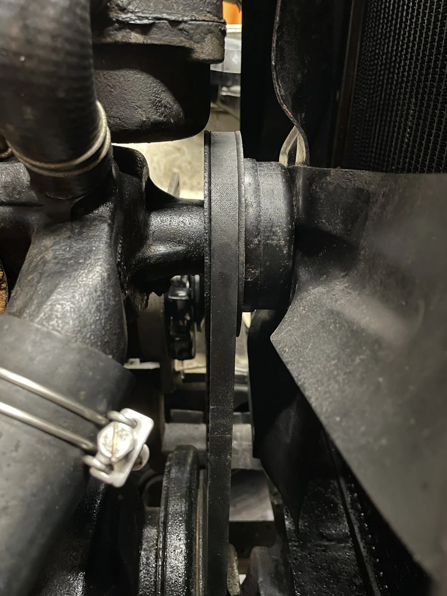

I believe that’s what I already have and the fit isn’t great. The pulley is damn near touching the thermostat housing and the whole thing is misaligning the belt as far as I can tell.

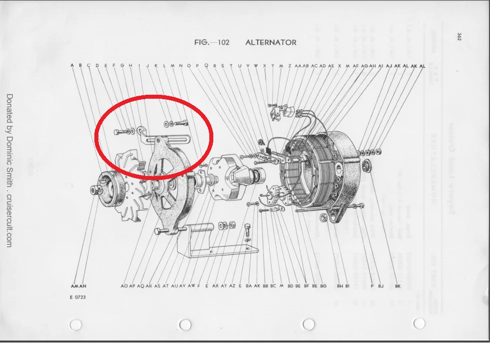

Also, the later style pump it about 1/4" thicker that the early style. Your alternator bracket hasn't been banged on, so what's with the stack of washer on your alternator bracket? That would put you way out of alignment by quite a bit with the washers in there.
Actually, it looks like you have the alternator bracket on the wrong side. It's supposed to be on the back side, with the bolt going through the bracket into the alternator from behind. But to get this to align with the later pump, you'll need to beat on that bracket to find 1/4" of room.
Good call out I actually just realized this the other day reading yours or @VA Mountain FJ40’s thread.

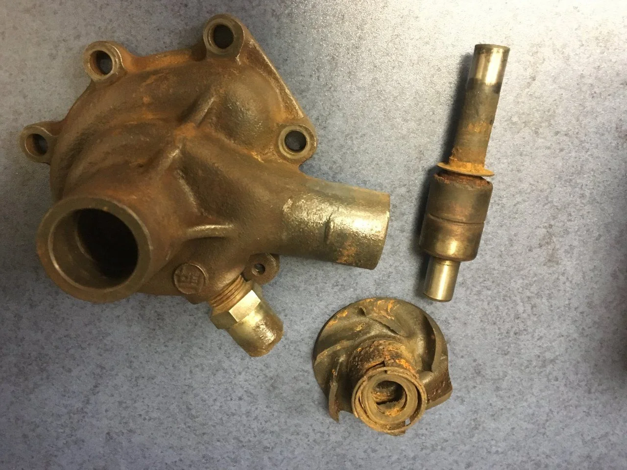

Bump. Still looking for one of these.
Found one. Got an old GMB unit from @red66toy! Now I need to find a rebuild kit or an affordable rebuilder... Anyone know if there is an existing kit that will work?
Keep us posted on how it goes.
