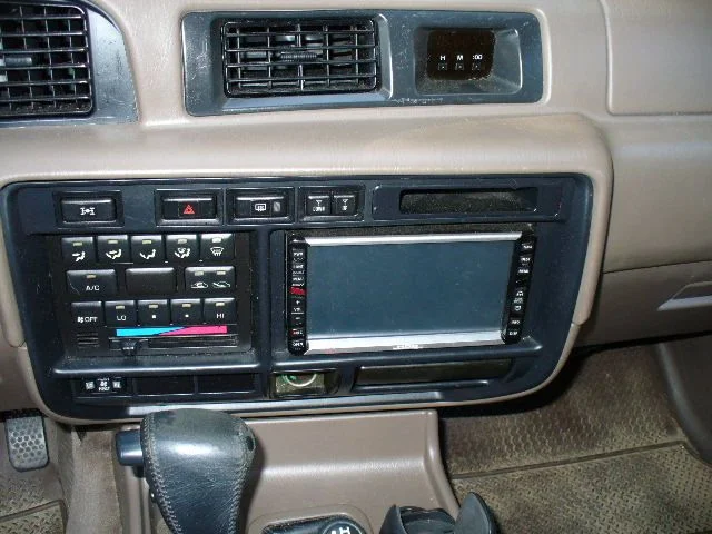

Here's mine, it's an Eclipse model double din. As you can see it fits perfect, but NEVER BUY AN ECLIPSE NAV! It was in the truck when I bought it and the maps are old and the only way to update it is too mail the entire unit to the factory pay 300 plus return shipping, wait 3 months and get it back with updated 2006 info (originallly 2004). They may have changed they're newer models but I wont buy anything from them.
That being said, having in dash nav is wonderful, I hate pulling out the window stick on unit and waiting 10 minutes for it to boot up in my other vehicles. Always on is great, and I would recommend Alpine, there is no better head unit hands down!

My head unit did not require any modification of the dash whatsoever. However, when I was doing some research on past threads before my install, I remember reading a few that had to modify the dash to fit properly. I did not want to deal with cutting up the faceplate on my dash, so I was happy I did not have to resort to this process. My head unit has the ability to tilt in order to see the screen better, so that is what you see in the picture instead of it in the factory vertical position. It actually has about 8 different angles you can view from.
Wow nice clean looking install, as is the rest of your interior.
That's the look I want..!!
double DIN will fit .. but it's tight behind it for cables and connectors ..
No doubt about that. It took some wizardry to get all of the cables I have hooked up to fit back there. I was able to position a few over to the left of the head unit which freed up some space behind it - still a tight fit though. I definitely had to do this for the video bypass module.
