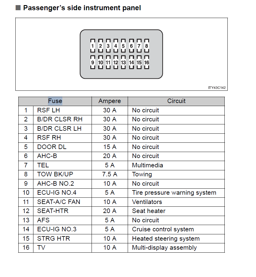

Did you check the fuses in the passenger side panel. That also caused a non audio output for me once. I think it was the multi-media fuse marked TEL
Yeah I checked that one and 16. Im going to pull the cd player out tomorrow. When I did function check the steering wheel volume worked but the rotary volume and tuner did not. However, I can load and unload cds. When I removed the head unit I didn’t touch the cd player. I don’t know why I didn’t but I didn’t and will take it apart again tomorrow.

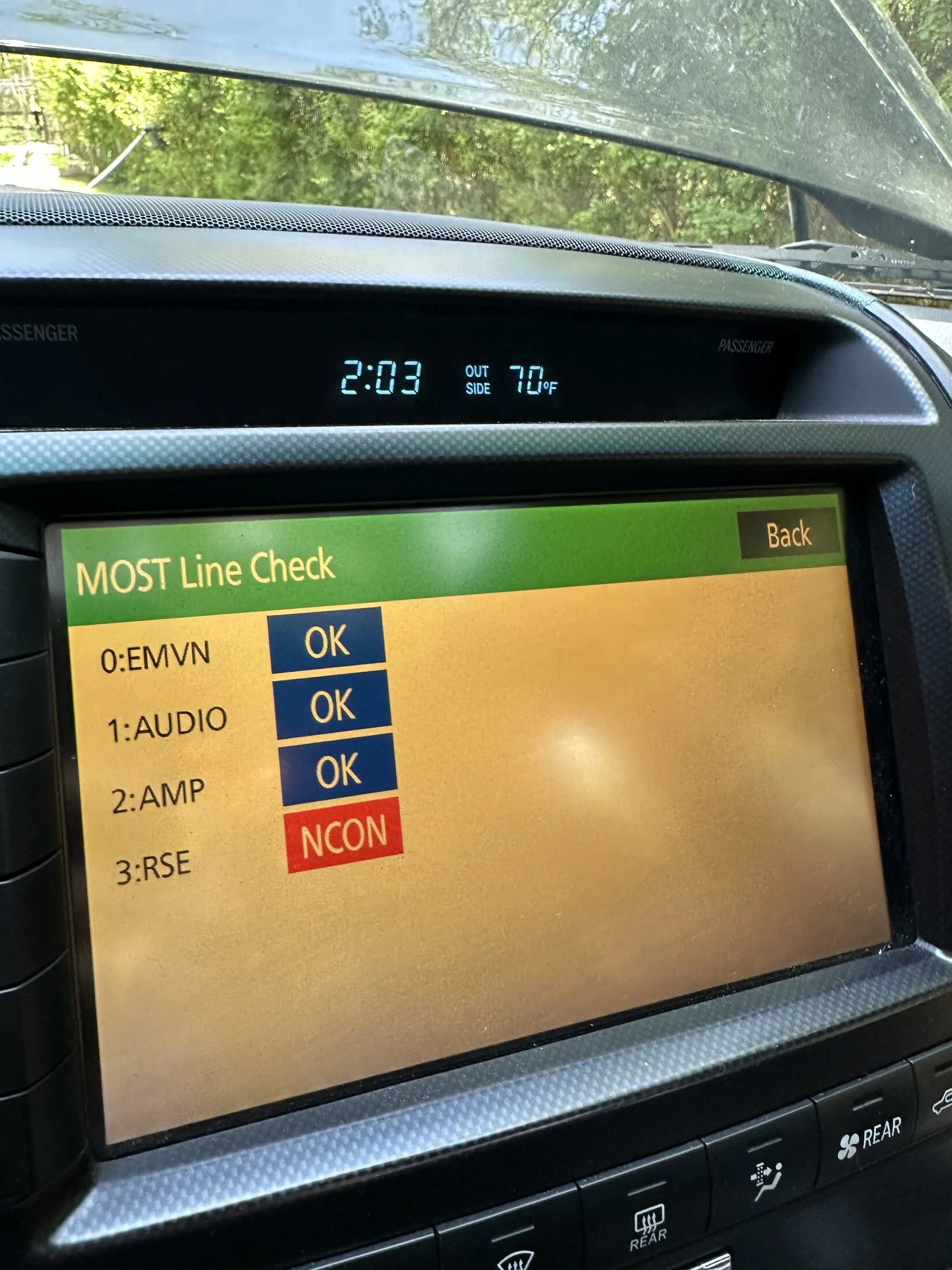

Everything else works on the head unit but when you go to audio it just says Audio Off and I can’t click on anything. I would make the assumption that there is a problem with either the CD player/ radio or the amp, but I’m not an electronic expert and have no idea what I’m talking about.

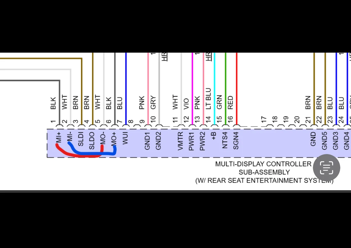

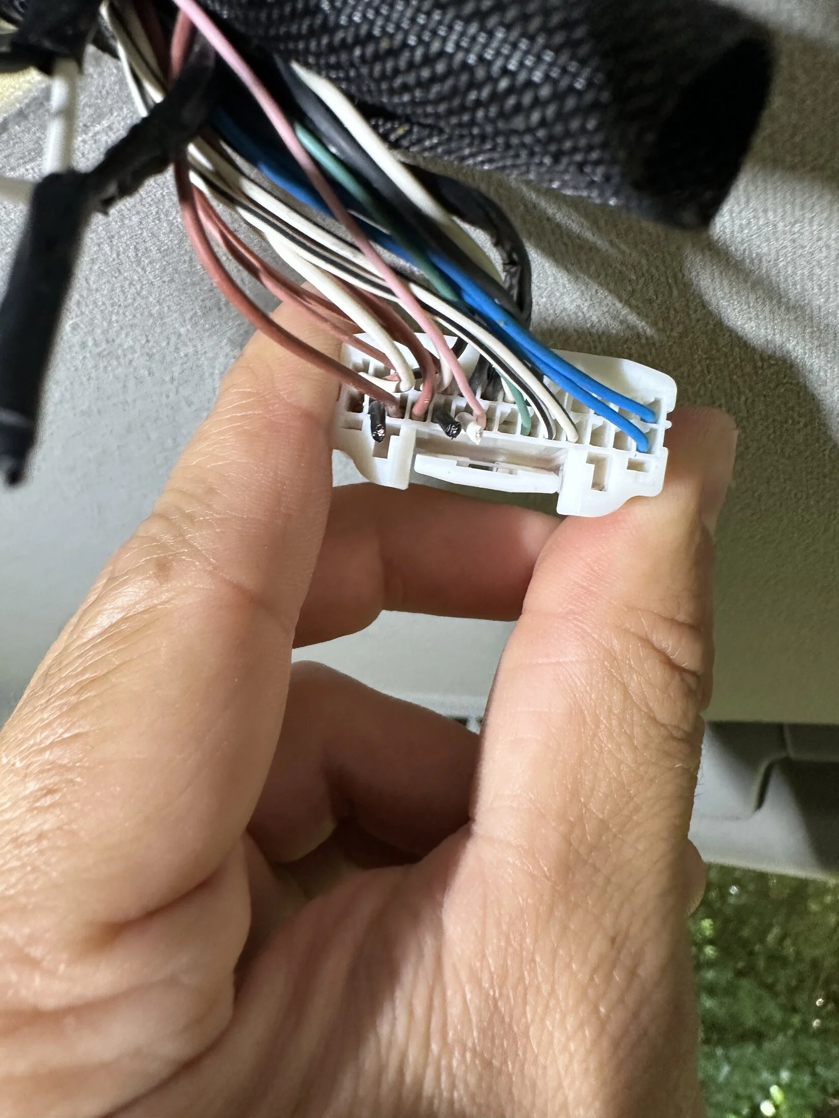

The dvd unit that must be bad. The stereo, amp and dvd all need to be working or you will receive the audio off message. I sent the stereo and amp off to get checked and they told me they all work. They only charged me for shipping. The owner reached out and told me the dvd must be bad and you need to make it seem like it’s working. You have to cut 4 wires off the dvd connector and connect them together. Shout out to OEM Auto Audio Inc out of upstate NY.
Below is a diagram of an newer LC connector but it’s close enough to my 2011 that you will be able to figure it out. I just twisted them together and taped them and plugged everything back in. When I started the car it said audio off and I was majorly bummed out. I had ripped the dash and stereo out probably 10 times at this point. I did the diagnostics and it was just a cluster **** of codes. I backed out of the menu and pressed the Bluetooth tab and to my surprise everything worked. CDs work too. Oh, I tried for 2 hours to depin the wires because I really didn’t want to cut them and I finally gave up and cut them.
