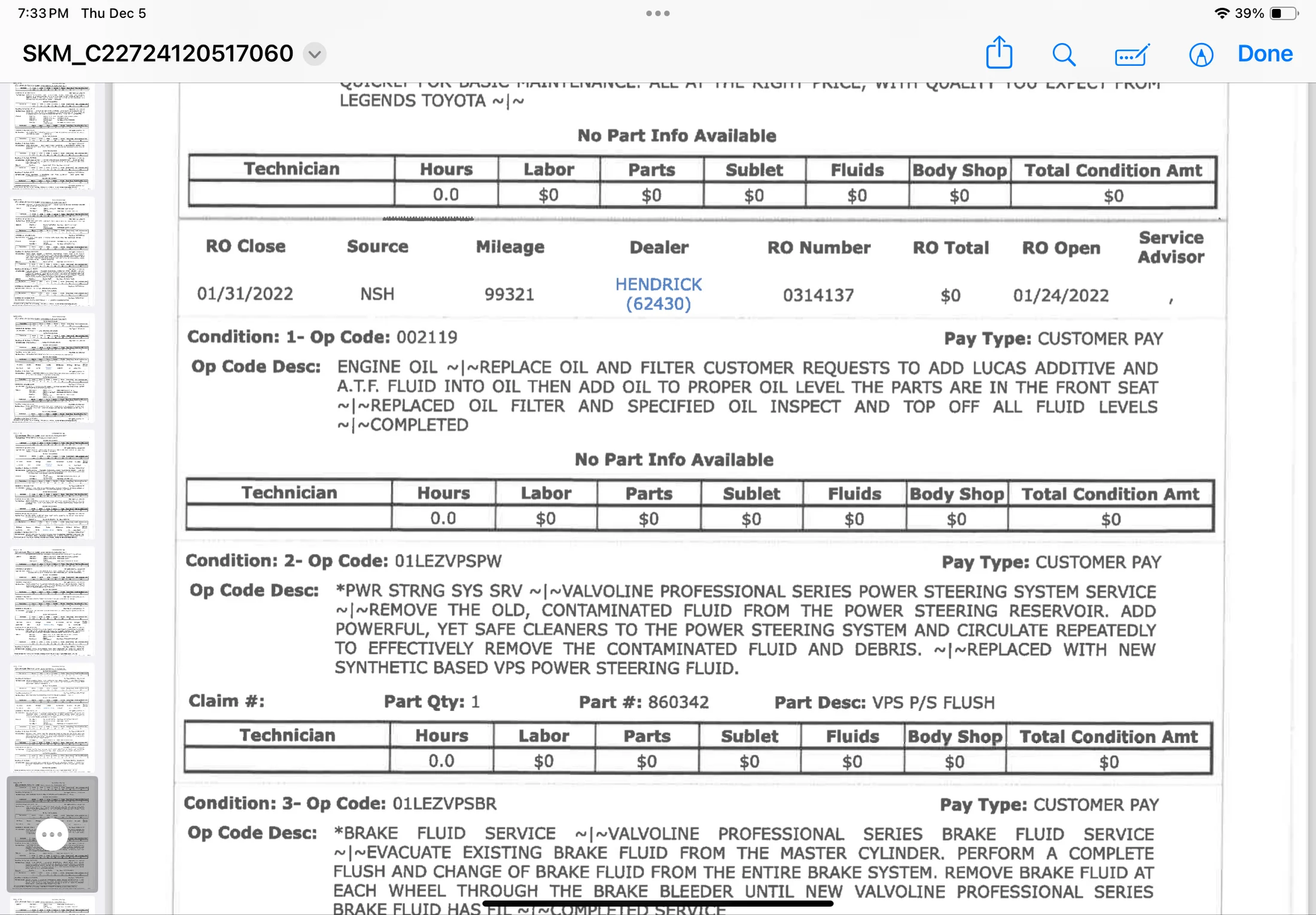

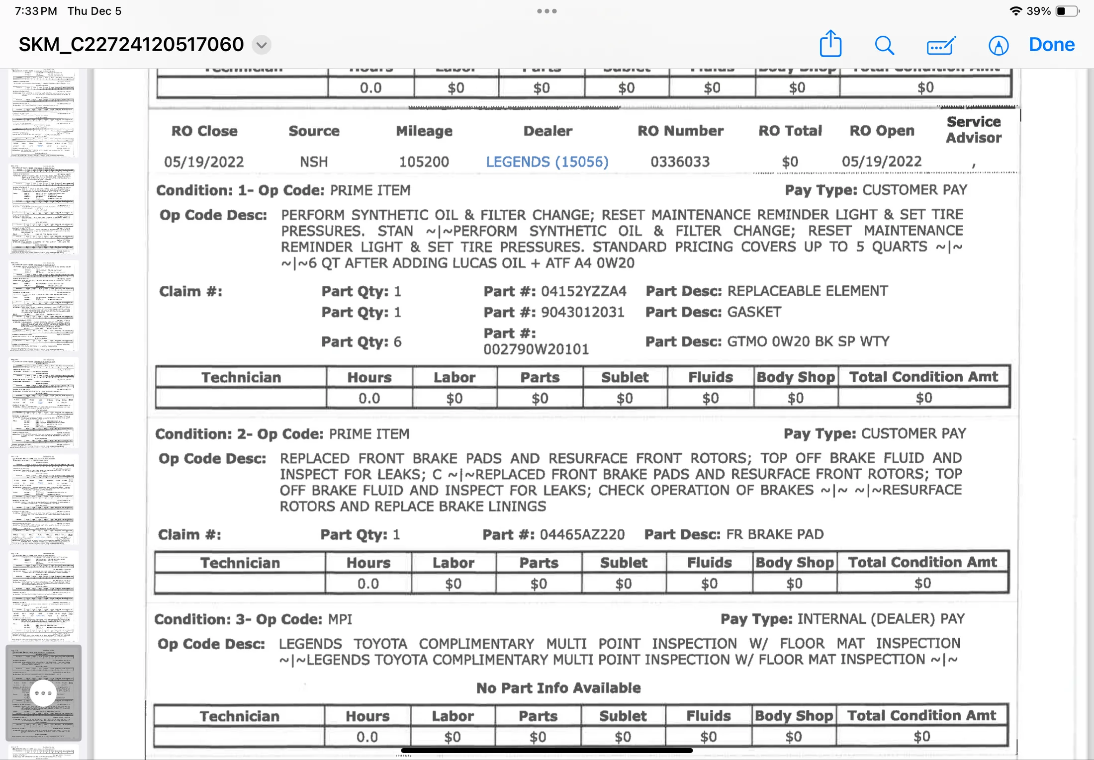

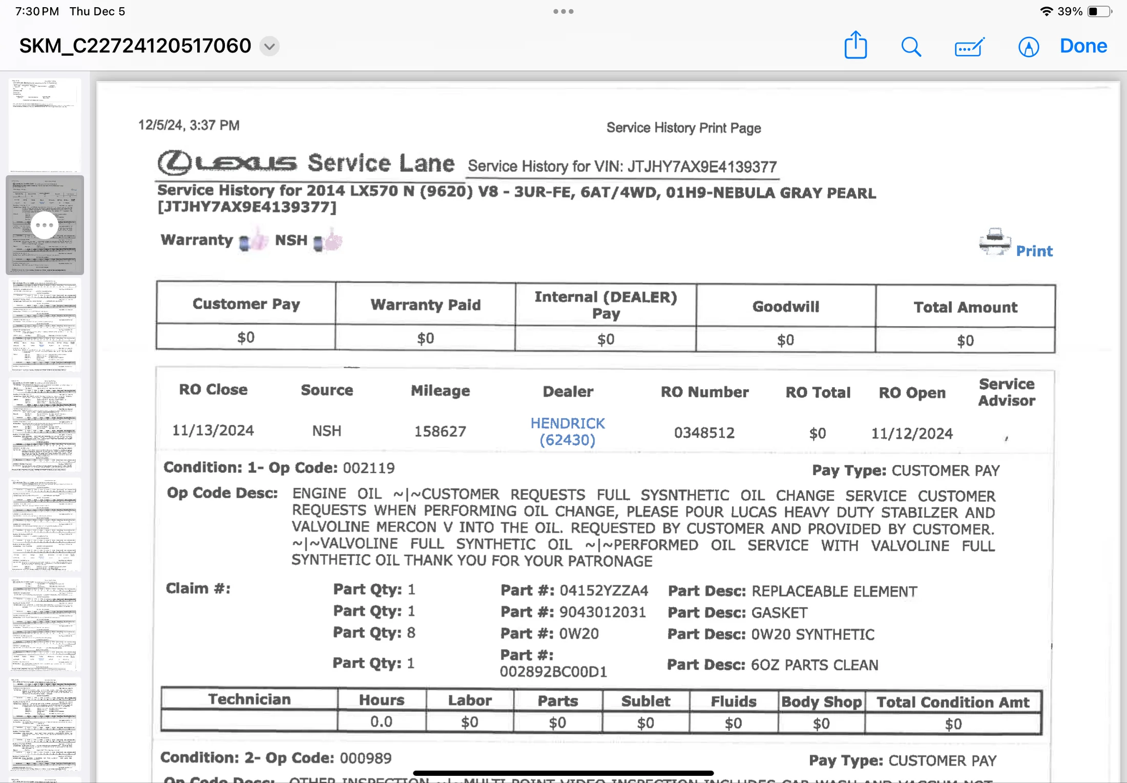

I nearly bought a 2014 lx570 from my local dealer, then found the strangest thing.
Lexus dealer servicing its entire life, including a few post warranty years.
Lexus dealer printed off the redacted records, and check these out.
Customer demanded lucas heavy duty stabilizer (1qt) and mercon V atf (1 quart) be added to engine oil
Why would someone do this??
engine flush

I walked away from the purchase of it.
Frustrating as it was the first LX/LC I've looked at out of +-30 where the frame was clean.
Everything has been changed on it, multiple times - coolant, power steering, brake fluid, etc.
Unfortunately the prior owner felt need to put his own little cocktails in the front seat to dump in.
