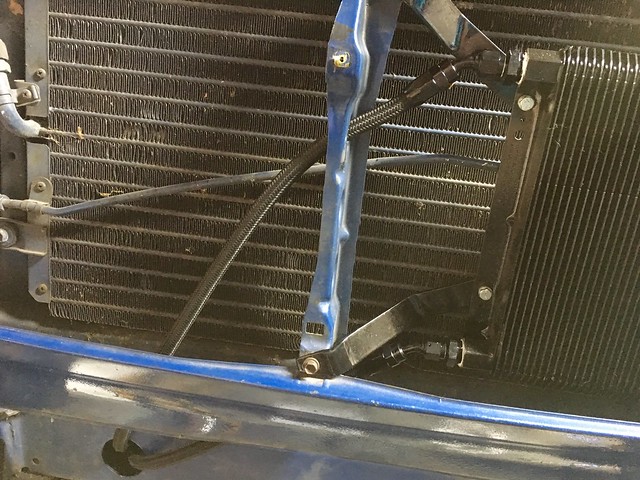

@red66toy That looks great! are you running a temp. gauge? curious if that one is big enough? Love the 6 AN set up, are you running that all the way to the transmission? I'm thinking of replacing all that hardline with high quality 3/8 6an hose.

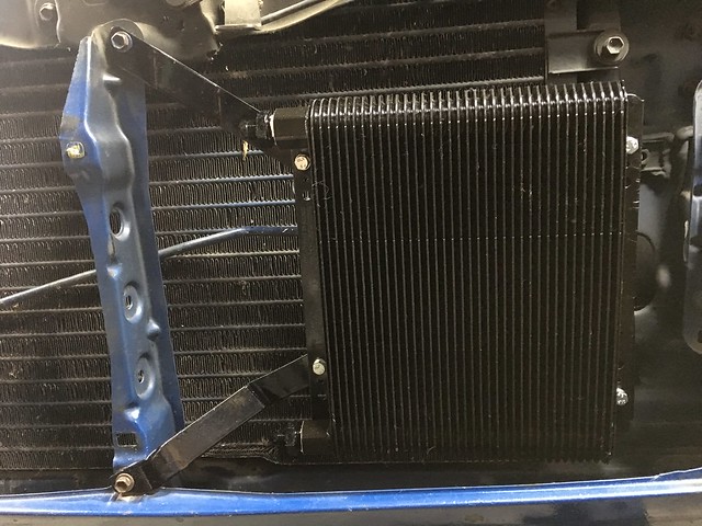

I dont have a temp. gauge, one of those projects on "the list". :)
I have it in line with the the factory cooler so it goes from the radiator to the aux cooler, then the AN braided line to the factory hardline. I probably should have just replaced all the hard lines but they are in good condition so I didn't want to mess with that. That style of aux cooler is supposed to be more efficient and cool better than the standard tube and fin so even though its a little smaller it should cool just fine. I have never had my temp light come on. Even fully loaded going up highway mountain passes. That being said, cant hurt to go bigger. :)

Gotcha @red66toy, I think I might go with the largest stack and plate I can find/fit that is made for 3/8 trans hoses flow / 6AN and make it fit.
