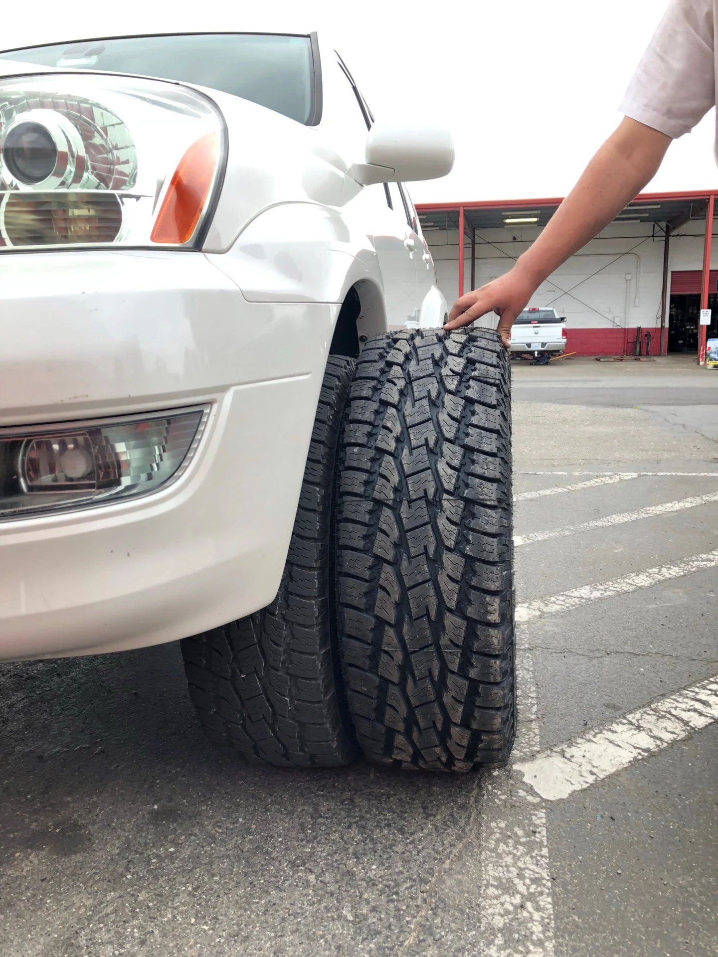

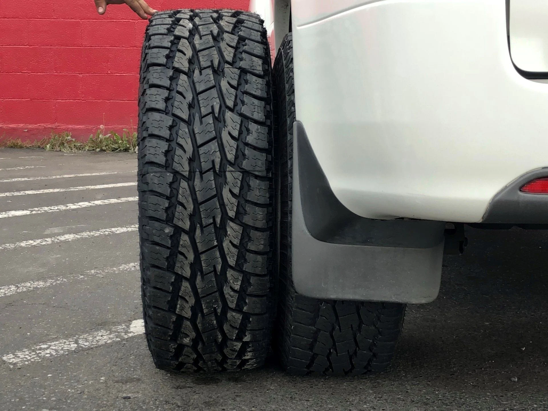

I have had my siped 265/70/R17 Toyo AT IIs (stock wheels on some spider trax spacers) for a while now and really like them, they have been quiet and perform well on the highway (dry and in rain), get decent mileage (around 19 mpg) got me through mud, ice, snow climbed over rocks and on most fishing trails without missing a beat...but I want something a little bigger. Part of me wants to buy the next size up (285s) of Toyo AT II, the only shortcomings I have with these tires are...
Just seems I need a little bigger tire to look better (my opinion)
These tires are kind of heavy (this size is E rated and I can really feel it in braking)
they can lose grip and spin in deeper snow
lug spacing is a little close
but mostly they are great and I just think the GX will look better with a little more tire with the space created with the Radflo lift
So...I went to my local Les Schwab and looked at the 285s and then they looked at my tires... He said your tires are still pretty good and I thought "dang it"...but then he added some key words, "...but they ARE showing some wear and you might want to start thinking about replacing them in the next year or so". So you can probably picture me silently saying "Yesss!"

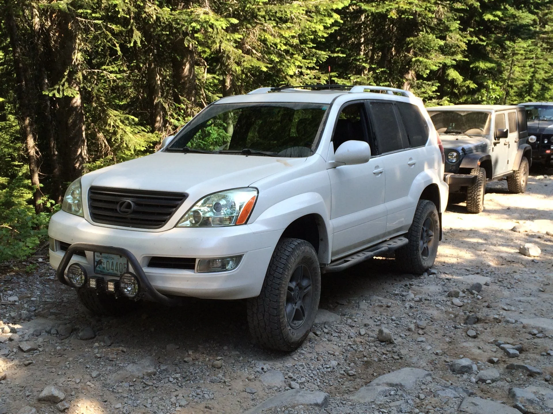

I have 285/70/17 KO2s and and I love them. Excellent all around tire that is actually snow rated.
I have a 2.5" Icon lift and the rear required no trimming. The front required the bottom inner corner of the bumper to be trimmed as well as some of the wheel well inner plastic trim. Nothing significant.
I did a body mount chop about 3 months after I did my lift and wheels because I was doing one for a buddy and had the pieces so I figured, why not. It was not necessary though.

thank you for the answers already... love to see a picture of the 285s on a GX. Also thanks for the description of the trimming BrnArSnpr.
I was just looking at the Toyo site and I see the comparison in weight between the 265s that I have now and the 285s (in both LT and P rated). Weights are 49 lbs for what I have now and for the 285s the weights would be 44 lbs for the P rated and 56 lbs for the E rated. Also the tread depth for P rated is only 13/32" while the E rated is 16/32". Maybe I should consider the P rated version (but not sure if it is a less aggressive tread or the thinner ply sidewalls would be not so good in cornering).

I have ridge grapplers and couldn't be happier. 2 1/2 cross country round trips, all weather conditions, moab (2), Ouray (3) ,SE trails, and the Rubicon (1) and still going strong
I bought 4 285/70/17 Nitto ridge grappler and put 10 k on them and they still look brand new they look so aggressive and tough yet very quiet and make the GX look awesome
I highly recommend them
