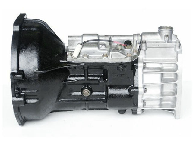

Insight needed- looking to swap from the factory 4 speed to a 5 speed. Truck already has the 22R instead of the factory 20R. I’ve read several threads about some years being easier to swap but also gotten some conflicting information as well. Would even prefer to just buy a complete trans/t-case combo. Also if anyone has a line on one or where to check please let me know. Thanks!
That escalated quickly. LOL
Marlin Crawlers has good writeups on transmission and transfer case swaps.
I'd reccomend whatever swap you do should include a new clutch, a good onceover of the internals, and the shifter bushing kit.
I bought my 5 speed from Marlin Crawler. I got the Heavy duty version, not sure what that means, haha. I also went with the 22RE turbo fly wheel (twice as thick as the stock one) and heavy duty racing clutch all from marlin crawler. You will have to send yours to him or pay the core charge. Also, expect a 2 month wait. You can get the T case from them as well or a rebuild kit, or from trail gear.

This is the trans that I bought from marlin. I know you started another thread in the old truck section but decided to post here.
keep in mind that now marlin is requiring 12 weeks to build and ship you a trans.
the same link has a chart with all years and trans with gear ratios.
my truck already had the L52 5 spead so that’s what I stuck with becasue it was predicted right and I didn’t want to deal with fitting issues with another type trans behind my 22R.
I would buy this trans again and plan to do exactly that when I build up the red truck.
