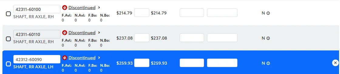

Well, the table has flipped. These were available as recently as 2 months ago.
42311-60100: Discontinued
42312-60090: Discontinued (but superseded)
42311-60110: Discontinued (but superseded)
42311-60110: --> 42311-60111 (3 available)
(Heritage Parts program part)
42312-60090--> 42312-60091 (seem available from overseas)

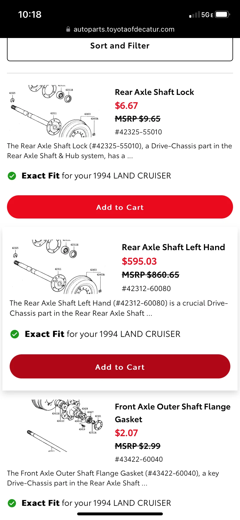

When I type in my vin number on Serra Toyota website who I’ve bought a lot from before it shows this part number for the rear LH axle:
42312-60080
Is this incorrect part number (94 LC no factory lockers) not sure if it even makes a difference.
I appreciate the info sir.
42312-60080
That's for a semi-float axle with drum brakes.
