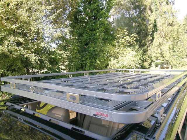

I just bought an African Outback full rack with the goodies. Looked at the ARB, but it was way too heavy for my liking and it sat up too high from the roof. The adjustability of the AO rack is key for my useage! Very Nice Rack and worth every penny!
Note Sunroof Hatch

I have an INTI rack and the sun roof tilts and opens. No problems there. Another nice thing about roof racks like the African Outback and the INTI rack is that they reflect a lot of the sunlight that hits the roof of your rig, thus making your car cooler in the summer.

Yes it can tilt just fine with an ARB rack sitting there.
I will admit that the rack is VERY, VERY stout. I have jumped around on it, and loaded it up really full with tires, gear, coolers, power tools ect...
