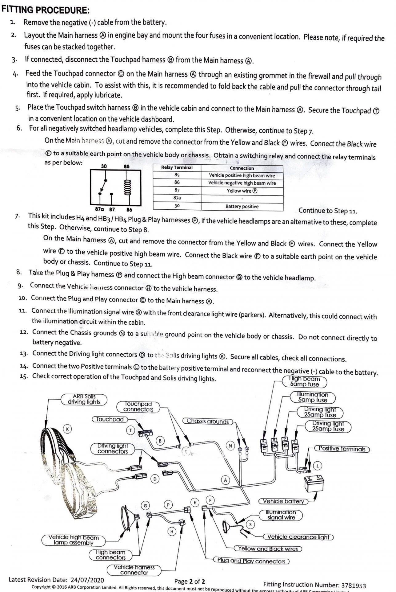

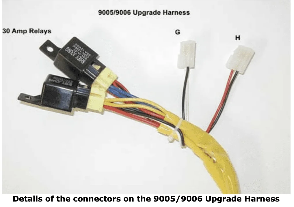

Has anyone connected ARB led lights to the Slee upgrade harness? The ARB Solis Intensity lights come with their own harness. Has anyone done this connection and can provide any guidance? The ARB instructions are attached as well as the image of the auxiliary connectors on the Slee upgrade harness. Any help would be really appreciated.
My first thought is that the connectors on the Slee harness will act as the high beam connection(Connector G in the Slee Harness image) and I need to follow step 7 in the ARB instructions to cut the connector and mate it to Slee connector G. I am not the best in wiring so want to test my hypothesis.
