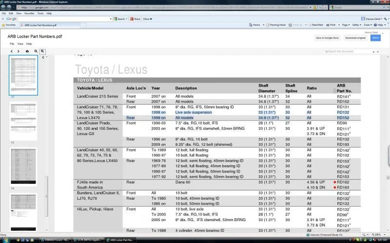

Hello all. ARB international air locker application chart shows that there are two front air lockers suitable for the GRJ71; the RD131 (IFS 8inch 50mm brng) and the RD132 (8inch 50mm brng but not IFS). Some suppliers opt for the first, others for the second!
I'm confused. Please help

Yup they're different. As far as the LC71 is concerned, ARB Air locker RD152 is designed for the rear axle.

Here you go...RD132 for front and RD152 for rear
Hi Jimy2,
ARB offer these airlockers seperately. If you are interested in a front airlocker then RD132 would seem to be the right airlocker to buy. However, if you also want a rear airlocker then you'll have to buy airlocker RD152. Along with the airlocker, you'll have to get air compressor 12V and air pump kit. Now, to confirm that all of the above is 100% correct I have sent an email to ARB for clarification. I'll let you know of their reply once recieved.
