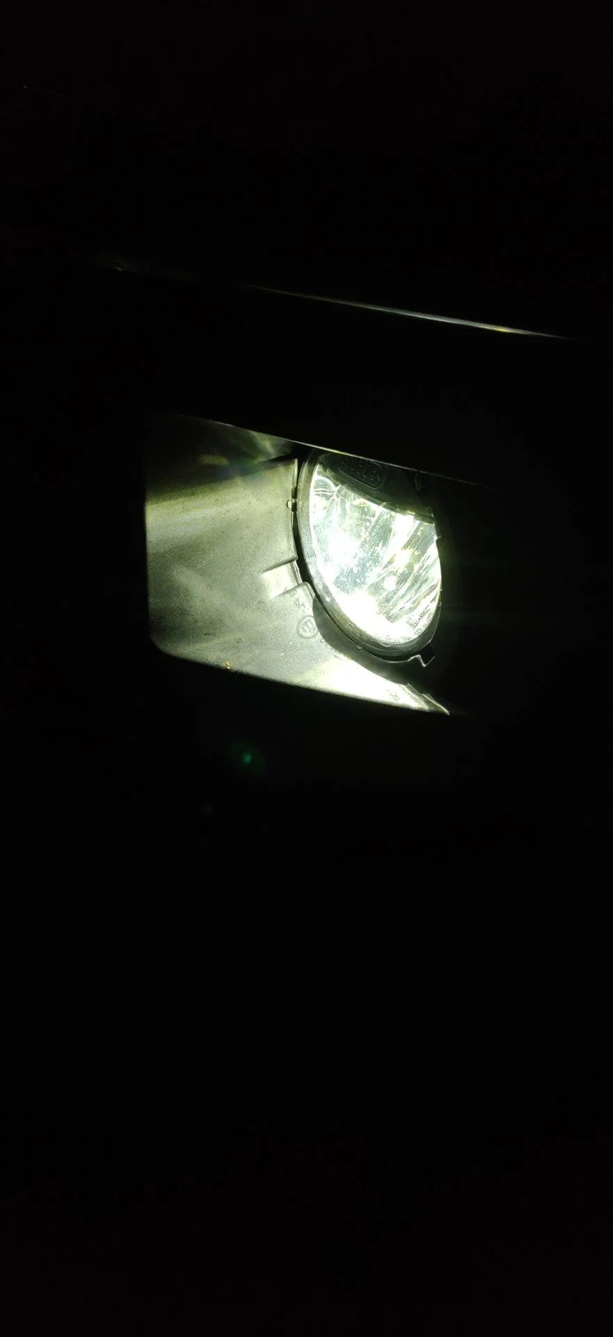

Hello hello,

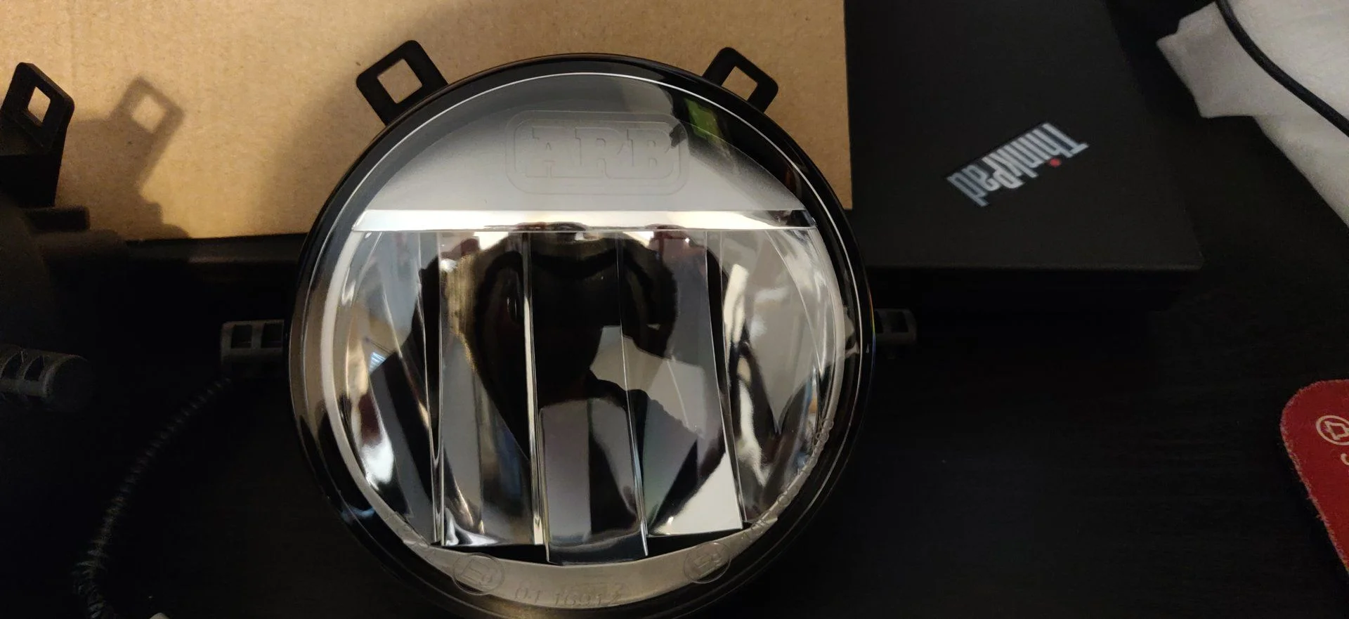

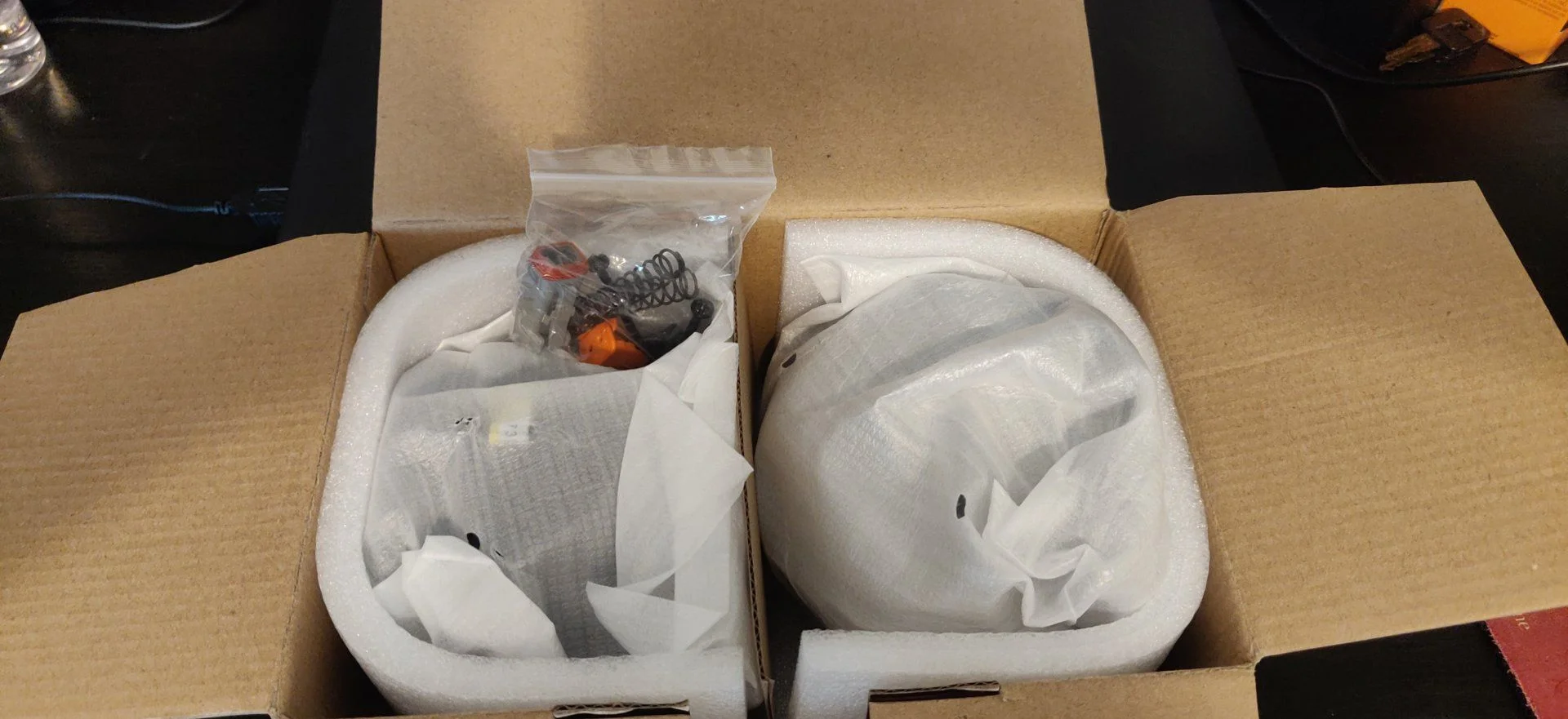

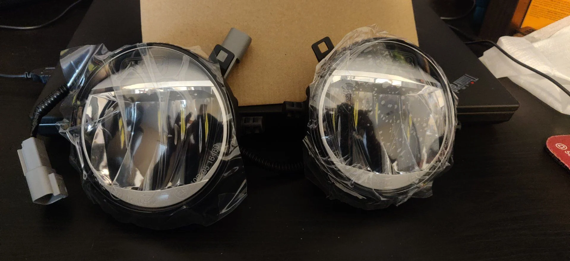

Finally I got the ARB fog lights for ARB bull bar.
Here are some pictures of them.
So as a description, I can say very well made product, made in China, I didn't check the to see how strong they are (I mean lumens output) but they are 4.7 watts on 12V which I believe it's enough for pair of fog lights.
I think the lens is made out of polycarbonate so probably less risk of broken lens in compare to older generation from ARB(halogen one) so you can count it as more durability.
As soon as I did the wiring will post some pictures of clarity, strength and of course color temperature which is really important for me.
The other point that I can mention here which is making these lights more demanding for me is if you check the last picture, you can see ARB logo on top of the lens which is absolutely high quality and beautiful.

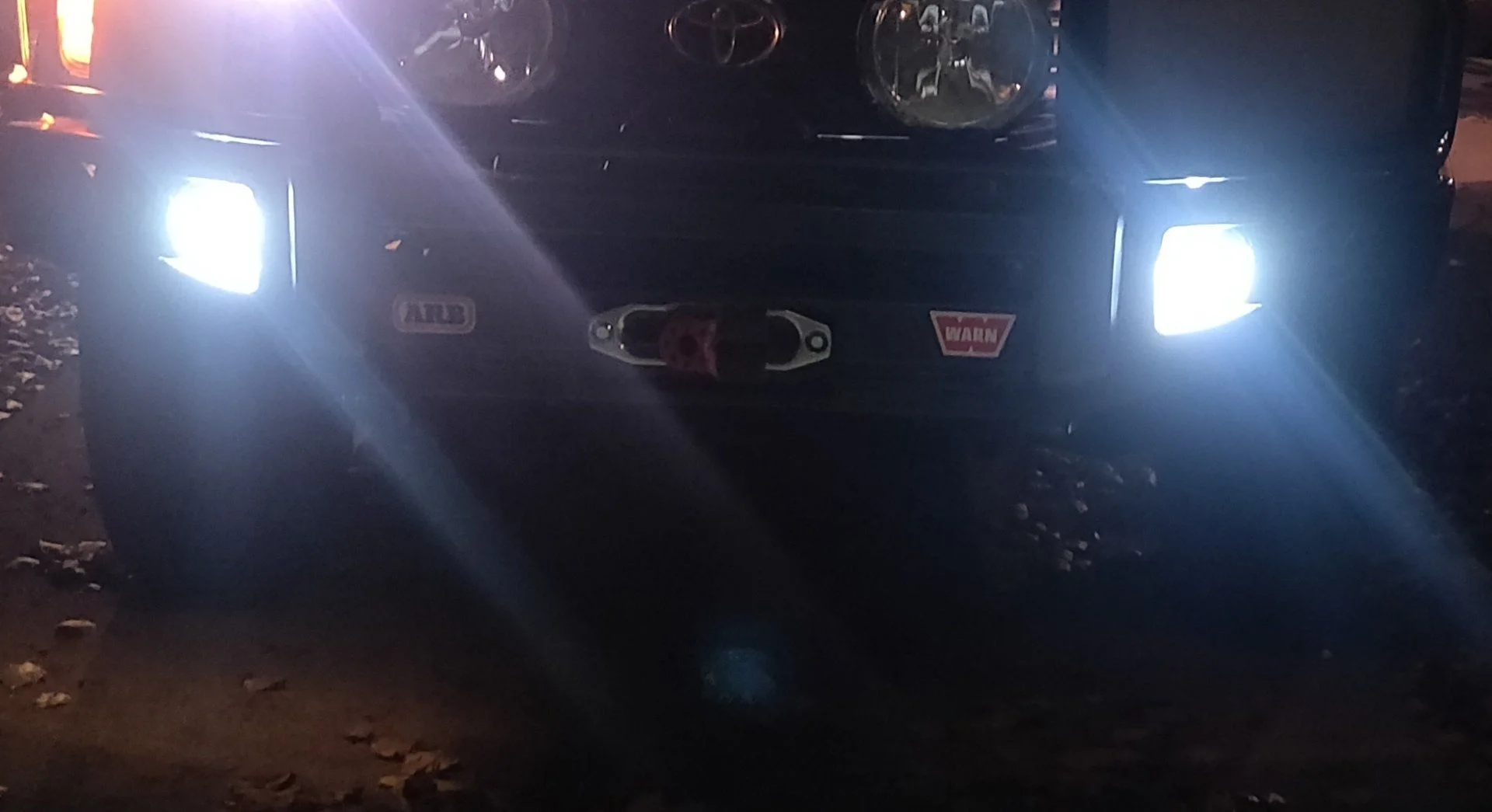

@Sal Dianat, Any pics of them mounted and output? Just curious how different the led fogs will look compared to oem headlights. Im sure it will be brighter but dont want to run the risk of completely different looking color temps.
Hi
The color temperature is something between 5500k-6000k , I will take some pictures for you tonight.
Sorry for the delay. I just adjusted the fog lights to get a deeper and wider light out of them. Also I tried to cover the headlights to just show the fog lights light. Hopefully you can get a good idea about the color and patterns.

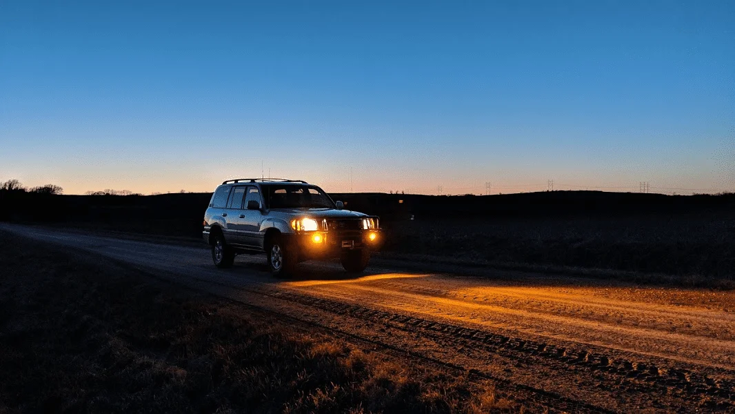

The amber Xprite's have been great fog and snow lights for me. You wont light up the next mile of road like the Stedi or Baja Designs, but you get usable light that can be used on the street since they are DOT stamped.
