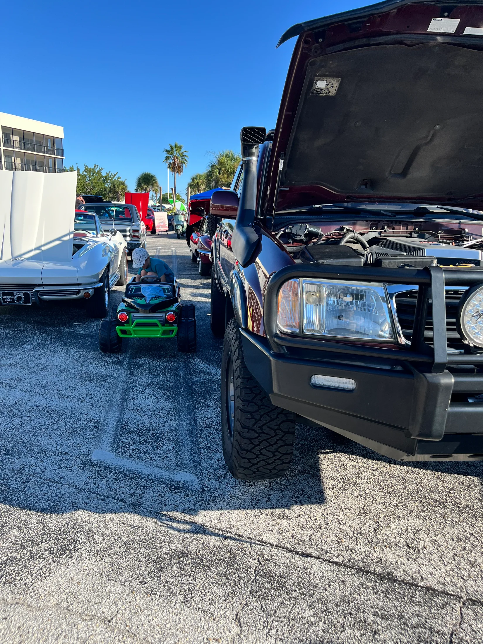

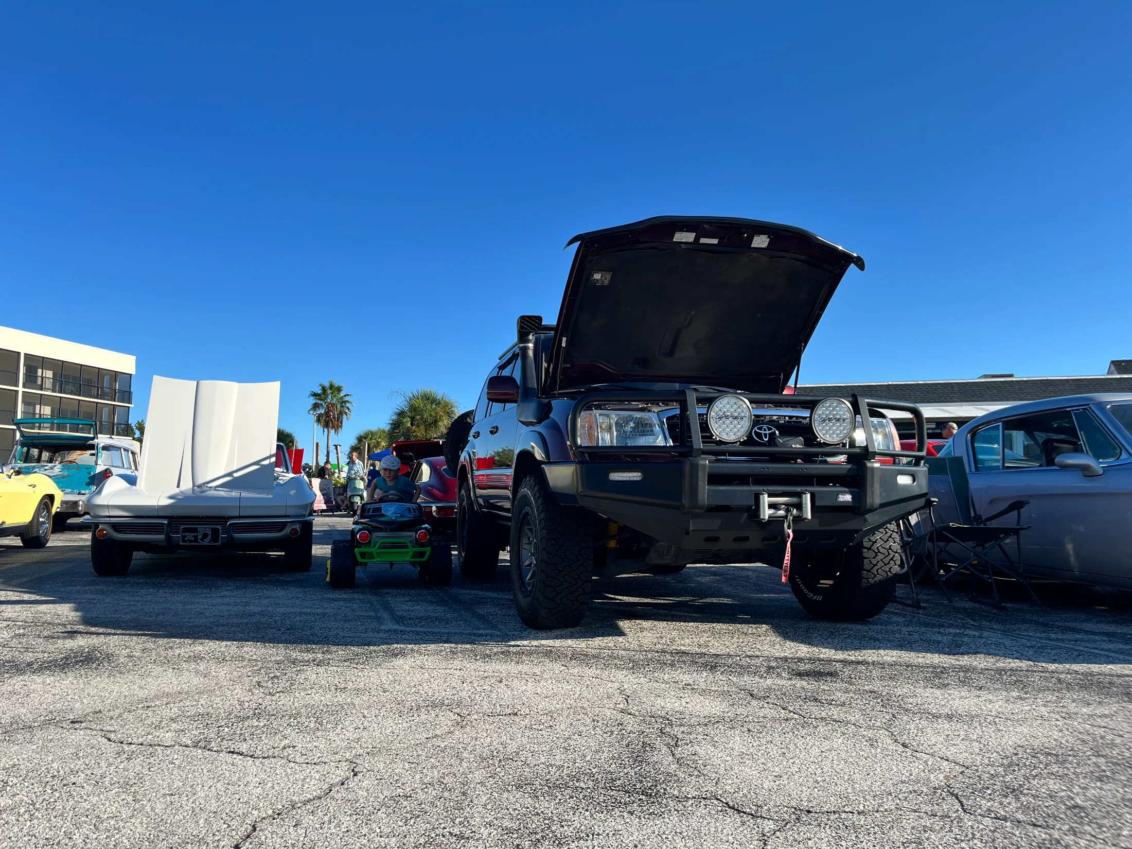

Does anybody have the original Dobinson’s bumper that only came LED pill shaped lights on it? This new to me LC100 came with this bumper as it is, and my brother had a similar bumper, but his had fog lights built into it. Has anybody modded these lights or found a fog light that drops in? All of my off-road rigs have rocked yellow pod lights and I’d like this to have the same. I live in Florida with heavy rain and the yellows helped me driving at night time in that as well. The current spotlights on the bumper are great for off road but would be terrible on the road and get me pulled over extremely quick…. They seem too nice to switch out and I like their look…. So my next obvious choice is to find a way to retrofit pod lights where the LED pills are take - or at least that’s my thought process!
Ideas?

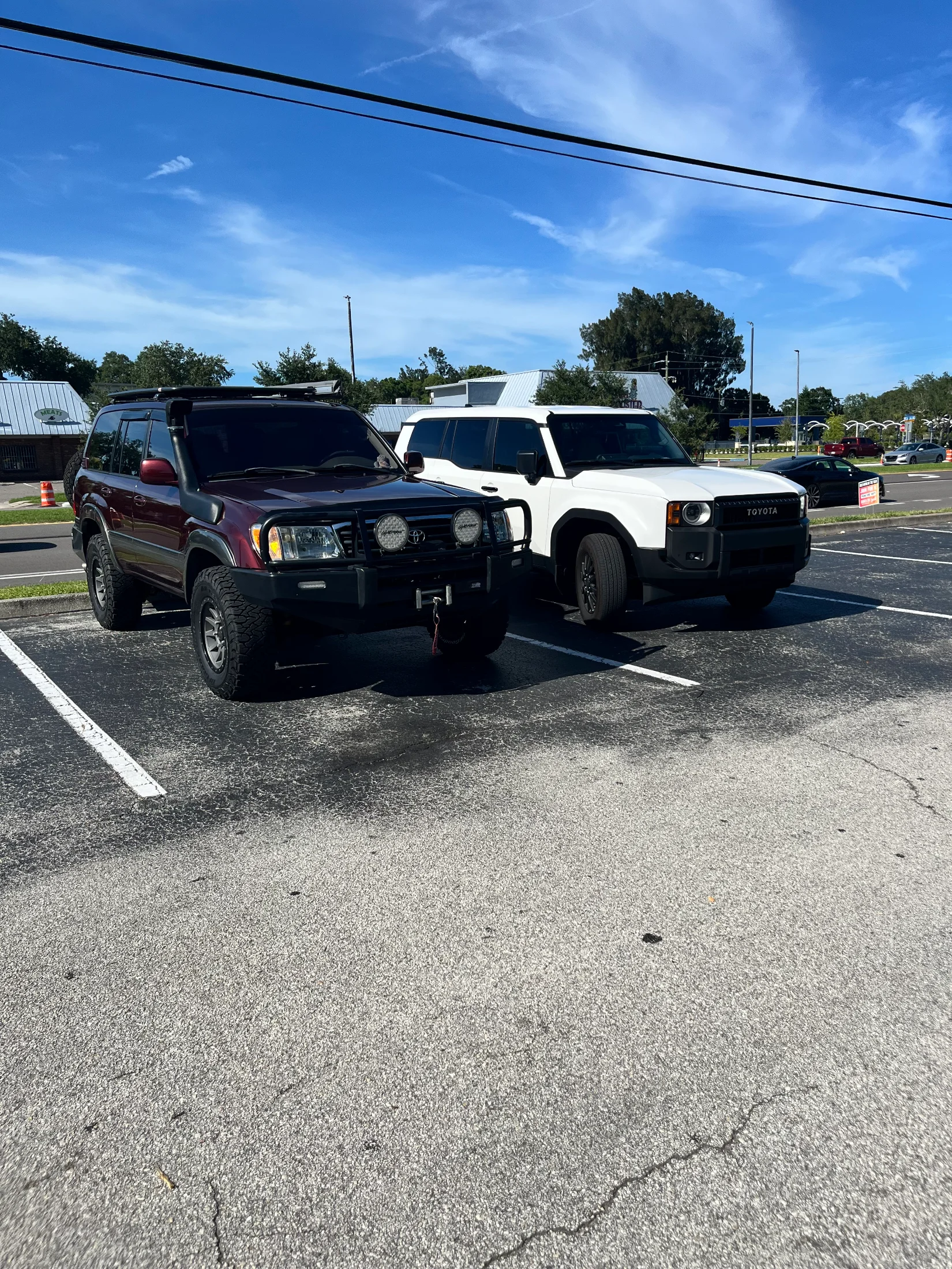

I’ve added a few photos of my truck at a car show and next to a new land cruiser for fun and so everybody can see what bumper I’m specifically talking about.
Fabrication? It shouldn't be too hard to cut out a clean opening and mount a tab that would allow you to mount upgraded yellow fogs, and some of then are available with their own sunken mounts (although it might be difficult to aim them then). You could also do an amber lightbar in that slot that sits above the winch fairlead? There's some nice quality slim bars that could sit in there nicely, I have one from CoLight on my white 100 that I love.
Yea fab would be good but I was hoping to not drop too much money on it. That may be the best way though.
I didn’t think of the light bar, I have never had one but that might be the best option, I saw where they have “pods” built in and have some amiable ones versus just huge flood light bars.
Got any pics or links for the slim bar that will fit in that’s spot? I’ve got the arb version of that. Any mount fabrication that needs to happen?
Im in a similar spot - looking at inserting an amber flood/spread bar in the slot above the winch. Baja designs and diode dynamics have some options that should work
