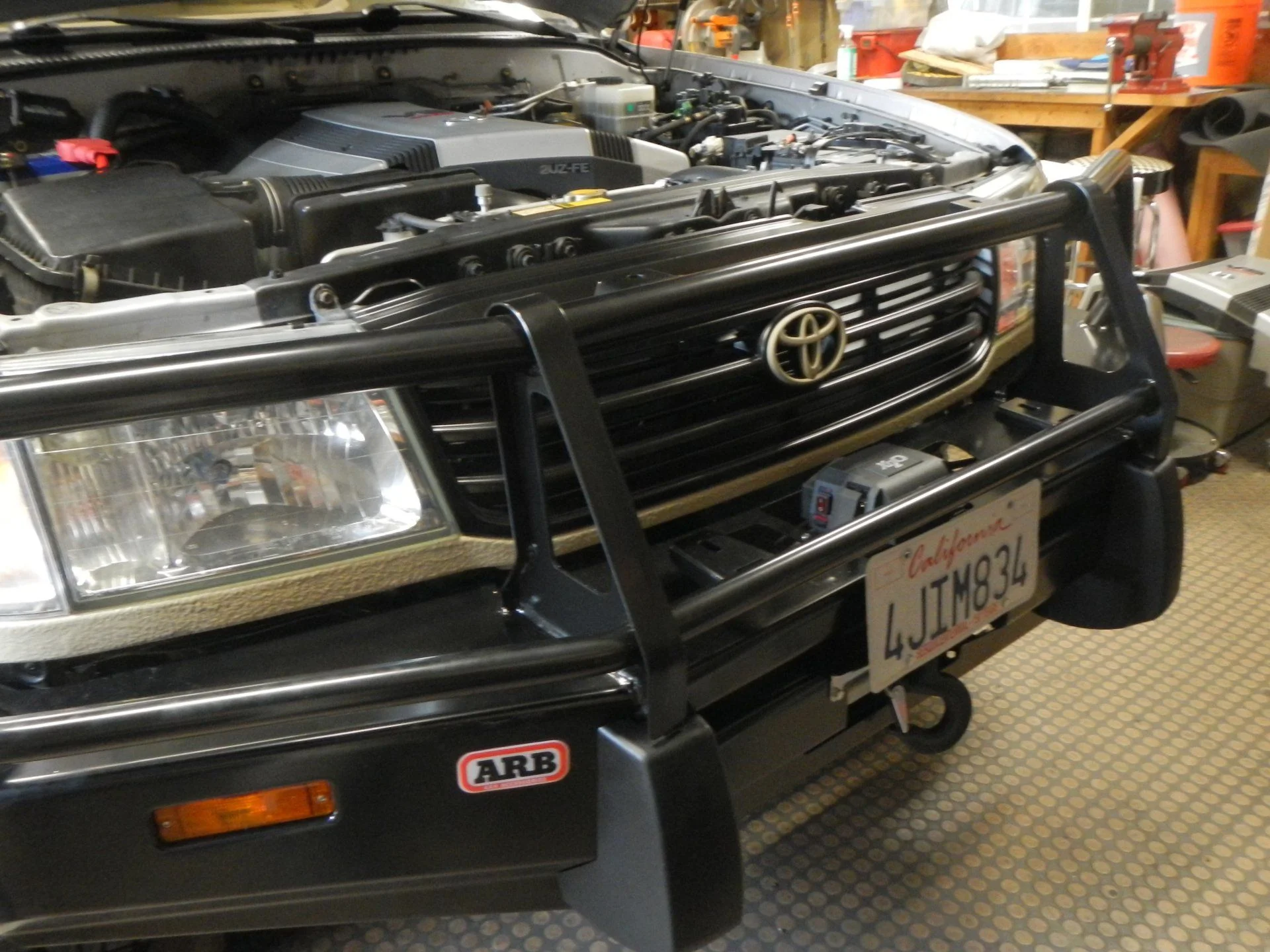

I had a similar shaped winch (Engo 12S) in my ARB deluxe on my 80. I had to make 3/8" spacer plates out of 316SS and get longer bolts to make it work. YMMV

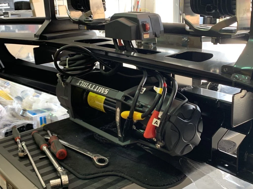

Just installed a Smittybilt X20 10K winch on the ARB bumper. No problem. I believe the 10 and 12K are the same dimensions-according to Smittybilt website.

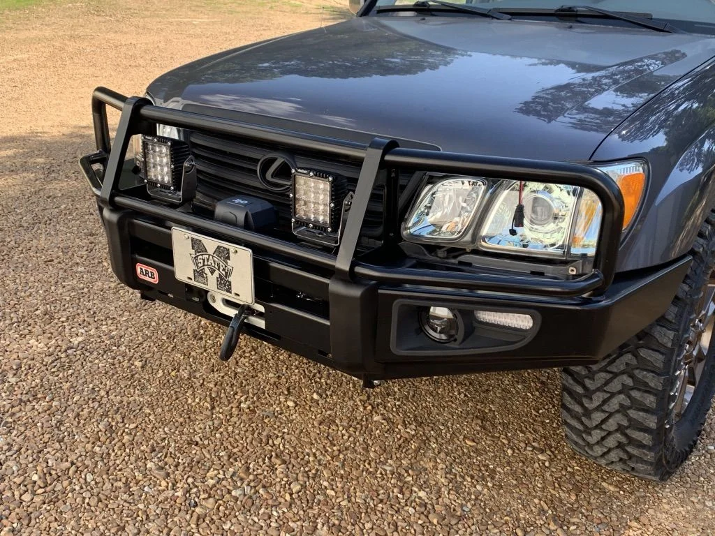

I have the +03 ARB with a WARN VR 12k Gen 2
Direct bolt, no modifications.
I did rotate the clutch end for easier access
Bought the mounting plate to install solenoid box on top of bumper but could have easily mounted under the hood with a little creativity
HTH

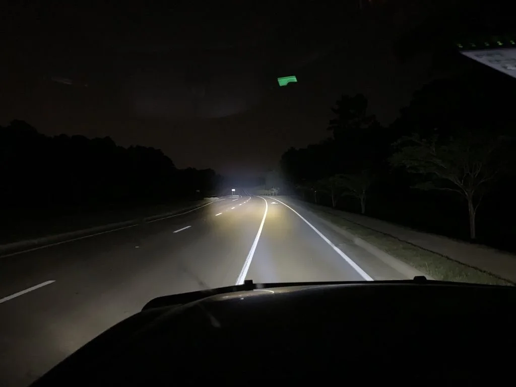

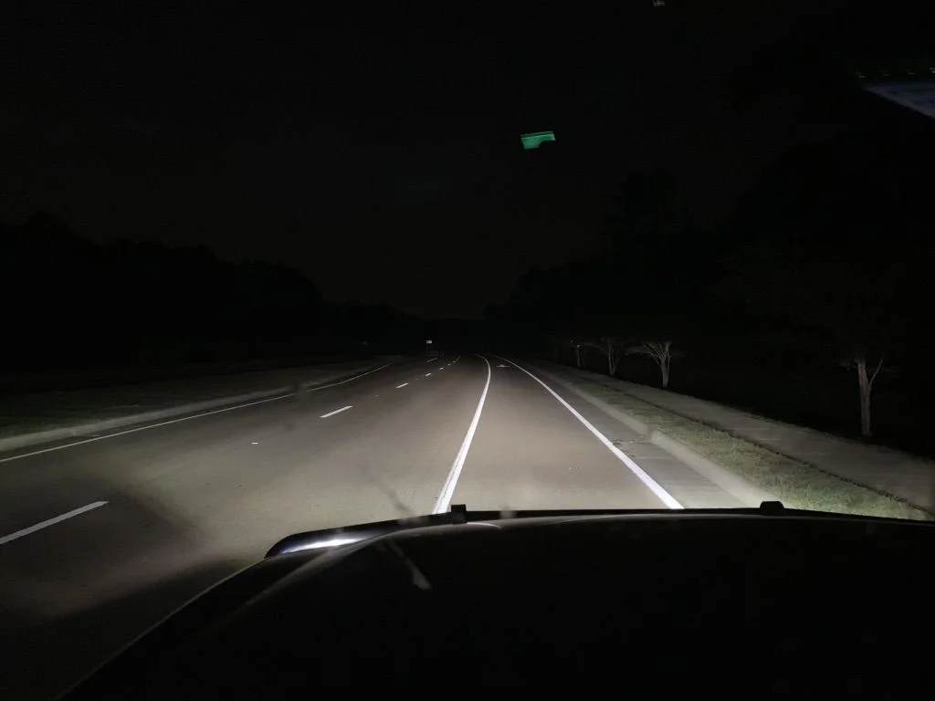

They are pricey, but very badass! It is amazing how far these can throw light in a straight line which is perfect for my setup. My HID lows, LED highs, and LED fogs take care of everything up close, and the Rigid's take that intensity within your field of view and casts it further than you can see. Most light bars, which I have on the rear, cannot produce the quality and intensity these lights provide. Of course, light bars are designed to to illuminate a broader field of view at shorter distances.
I have been meaning to document the light output, so I will keep you updated.

I've been considering running 2 Rigid Pro Cubes hyperspots off my roof rack with the 9" driving lights on the bumper. Figure the higher up I have the hyperspots, the better it would be.
Very nice! That's exactly what I'm looking for: focused light cast downfield with little to no bleed. Guess I'll be placing an order for mine this week.
