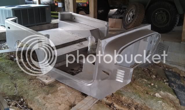

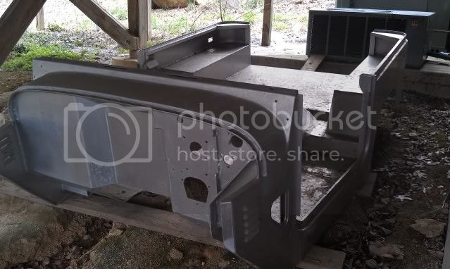

Aqualu tub and cowl up close and personal- thought some of you might be interest
For cowl + tub you are looking at $6.5K...add another $1K for shipping. More for other options like tailgate or fenders. Excellent quality product and customer service. Beats the price on steel reproduction tubs hands down and is lighter and rust free. If you're not doing a 100% OEM restoration it's the best choice in my opinion. Link over to my screen name and look up my build...not far from being done.

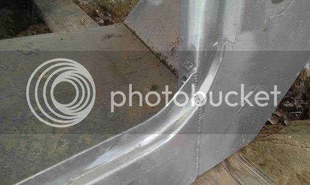

I've got a 27" stretched Aqualu tub and the workmanship is excellent. Takes a good hand to weld up that much aluminum. When I bought my tub 4 years ago, Dominique (sp) was on the phone lines doing customer service and she was great to deal with.

That's certainly good to know. Here is mine the trans tunnel and windshield frame are stored away. I bolted the tub and cowl together and also had them welded together.
