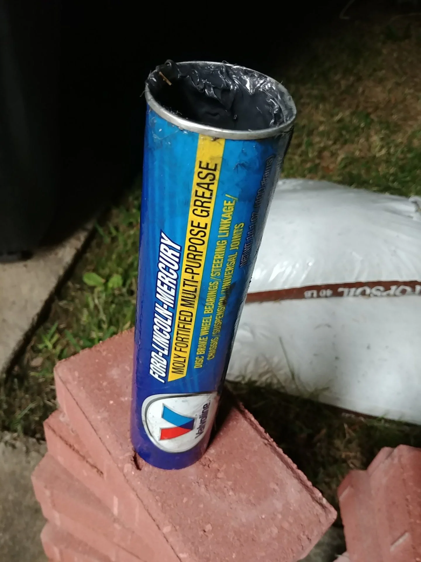

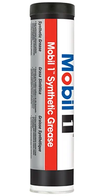

Perfect timing. I just ran out of Valvoline grease that i use for my u joints and shafts and got some Mobil 1 synthetic today, should i not use it? No issues with the Valvoline, just wanted to try something else.
I also used some master pro grease when i packed my bearings as it was the only thing available at the time. Did i mess up on that?
This sounds like it's more complicated than it should be.
I've attached pictures of what i used. Lmk if anything's going to explode.
