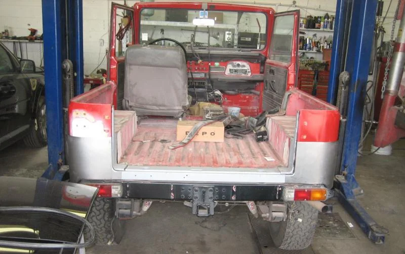

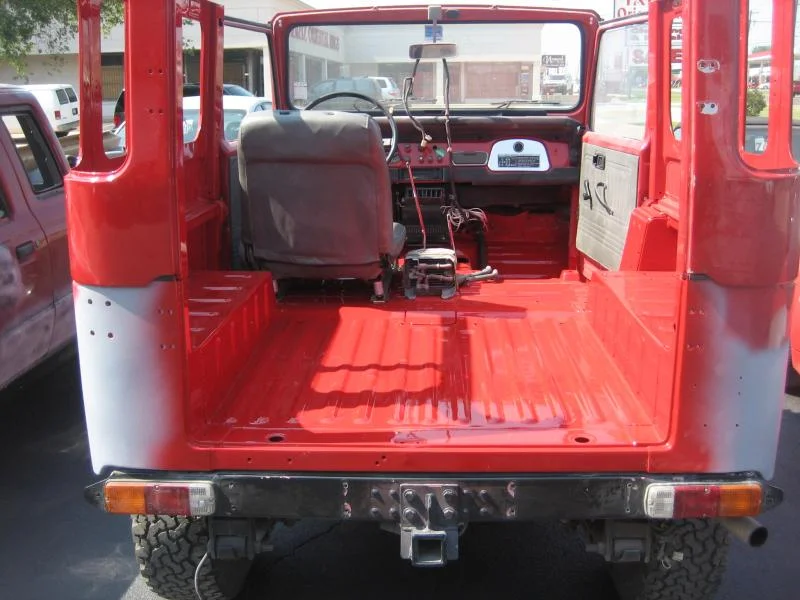

I used Real Steel quarter patch panels. Fast service, perfect fit, high quality 16 gauge steel. Absolutely no complaints.
After fabbing a few on my own I bought one and well worth the $$ I thought. I didnt cut out for the whole quarter but fit good and saved a ton of time.
Those look really good Sea Knight. I guess I could buy the whole panels and cut out just the stuff I need. Never thought about that before. Today I asked a couple body shops here what they'd charge me to weld in the quarter panels and rear sill I'm buying to replace the rusted ones. One of them quoted me 50 hours of labor charge! I don't even want paint or body filler, I can do that myself. I just wanted them to cut the old ones off and weld in the new ones... Might just spend that money on a welder and do it myself.
