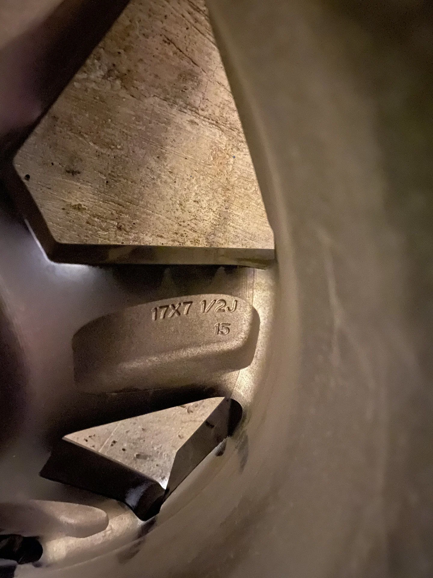

Hey all, I picked up a good deal on a wheel/tire combo locally that were take-offs from a new 2020 "TRD Off-Road" trim 4Runner. I apparently didn't do all of my homework because after some post purchase research I'm feeling less confident these guys are going to fit as expected. The wheels are 7.5" wide, whereas I expected them to be 7". I did a quick glance at time of sale but it's stamped as: "17x7 ... 1/2". Apparently I stopped reading after 17x7. Also it looks like the offset could be quite a bit different on these 7.5"s but I'm still trying to confirm. I assume the part number must be stamped somewhere (?) but I did't see it immediately.

OEM is 17x75 also.
+25 mm OEM Offset and this are +15
It will fit fine. Might rub a bit depending on your alignment. Worst you have to do it trim a bit of running board and move the fender liner forward.

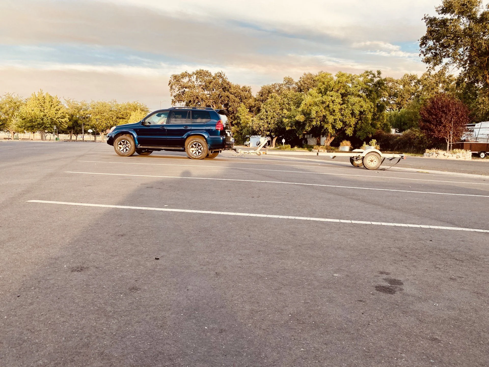

I think that these wheels are the best wheels ever. I am running stock suspension with stock tire size for a 2020 4runner but with falken wild peak AT3s and so far have been unstoppable off-road. I do have some slight rubbing at full lock at ”high” speed. But i have 188k with stock suspension that is pro sagging a bit.

Looks really good...are you running spacers?
