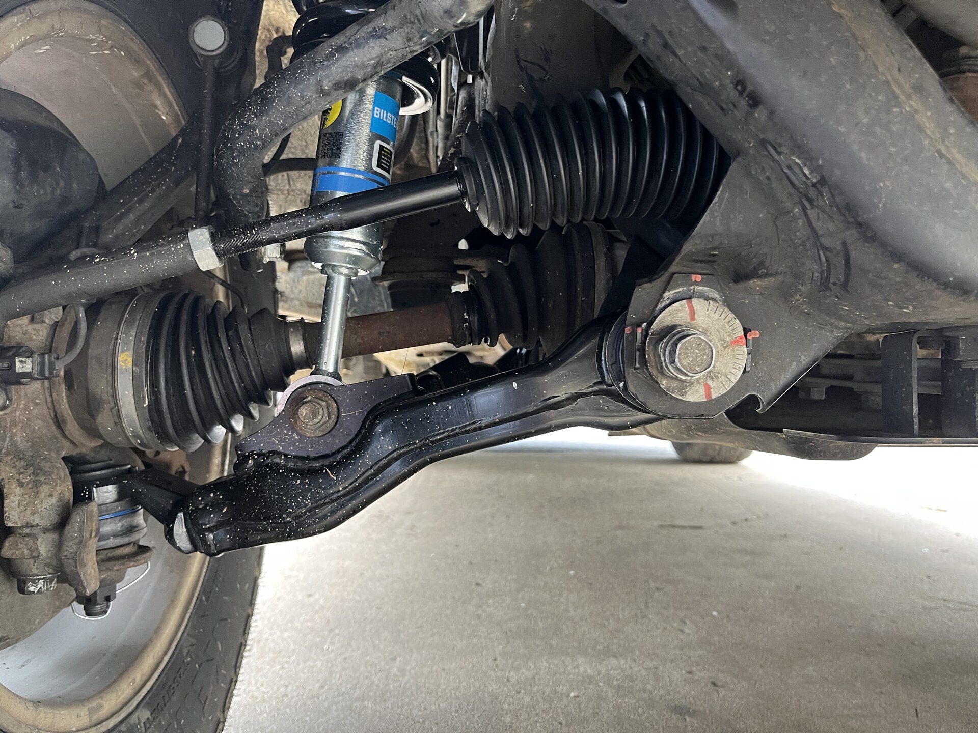

Finally got it back yesterday, it seems like more than 2 inches of lift. Front end is tight/ firm and quiet over bumps. I still have to put the rear shocks on and do the airbag trick with the washers . Right now it’s a little higher in the front. I’ve had an intermittent misfire, but no cel ( I was worried about torque converter lock up issues). Well yesterday on the way back it was really running bad and cel and both vsc lights on. I was really ill thinking the shop had caused it. Scanner just shows misfire cylinder 1. Got a new set of plugs/ coils on the way. Should make some progress this week

I think I'm going to have to do a diff drop. My cv angles seem too steep ( to me anyway). I didn't measure before the bilsteins went on (which was kind of dumb on my part); but from the center of my front hub to bottom of the fender is 23.5 inches. I'm sort of wishing I would have used the stock front springs at this point. Maybe if I add a winch it will drop it enough.
