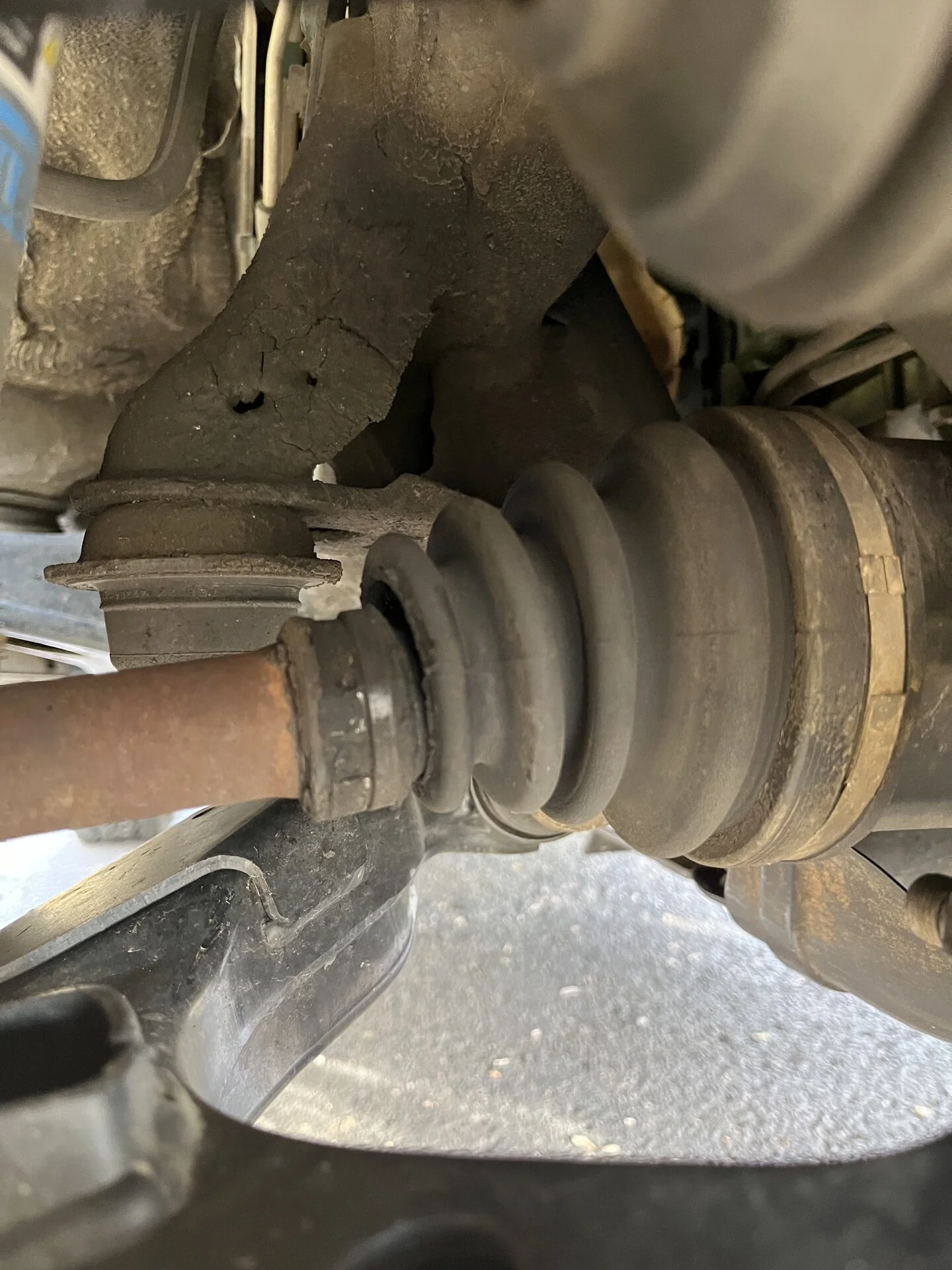

You'll definitely rip stock or reman CV boots lifted, but a diff drop will lose some of the ground clearance you just gained and can also damage things due to diff having extra leverage against the frame. The actual CV angle should be totally fine, mine is just as steep if not more so and I have had zero issues (other than boots) on and off-road with the CVs.
I kept ripping CV boots prior to switching to All-Pro high-angle CV boots on my original OEM axles around a year-ish ago. No problems since and I've been very happy with them, and have almost 12" of ground clearance under the front of the GX.

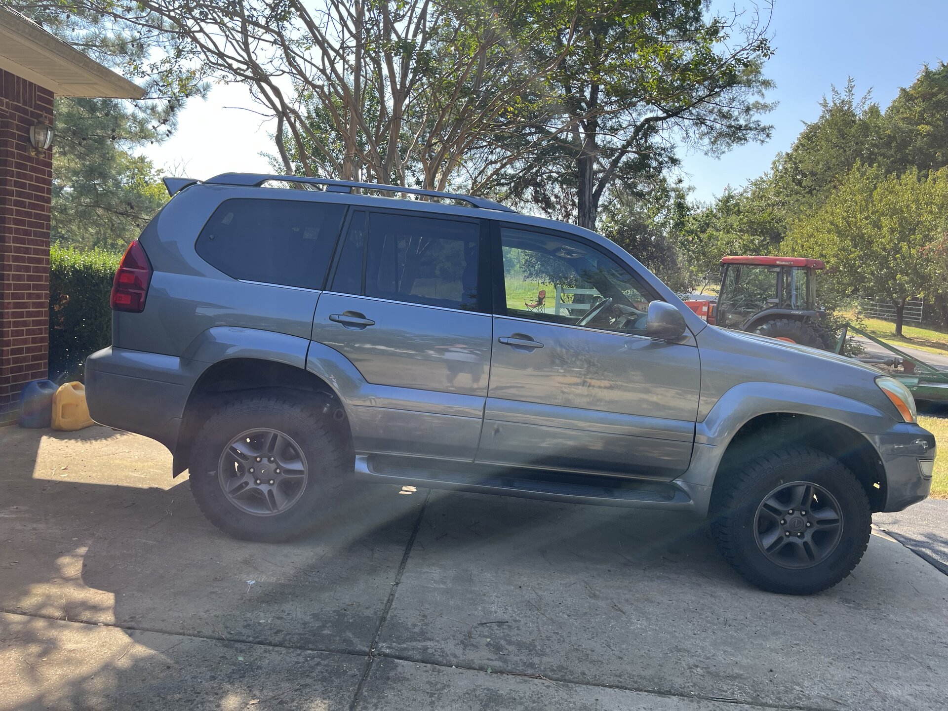

I finally , got the iron man airbag delete kit with the iron man 2" coils installed today. $200 for the install. I haven't measured anything yet, but it's got the rake back. I feel like it rides better, haven't been on the interstate yet either. I'll take another photo later today. I got 25% off for labor day sale. I looked up instructions yesterday and it looks like the sale is still going
Tom
Rides better than stock ?
That's hard to believe
Well, I have 300,000 miles and a 2 inch lift on the front. Actually never ridden in a new gx. I'm just saying I think it rides better than mine did before
This is from today, looking at the photo from March; I think it was already torn. ( there is no grease in either pic). I'm getting ready to let my son take my gx back to Denver after he overheated his v8 4runner. Putting in new radiator tomorrow. I guess cv axles Thanksgiving weekend. I think I'm going to order the 5th gen 4runner/gx460 axles. Supposed to have the plastic boots on inner and outer joints.
