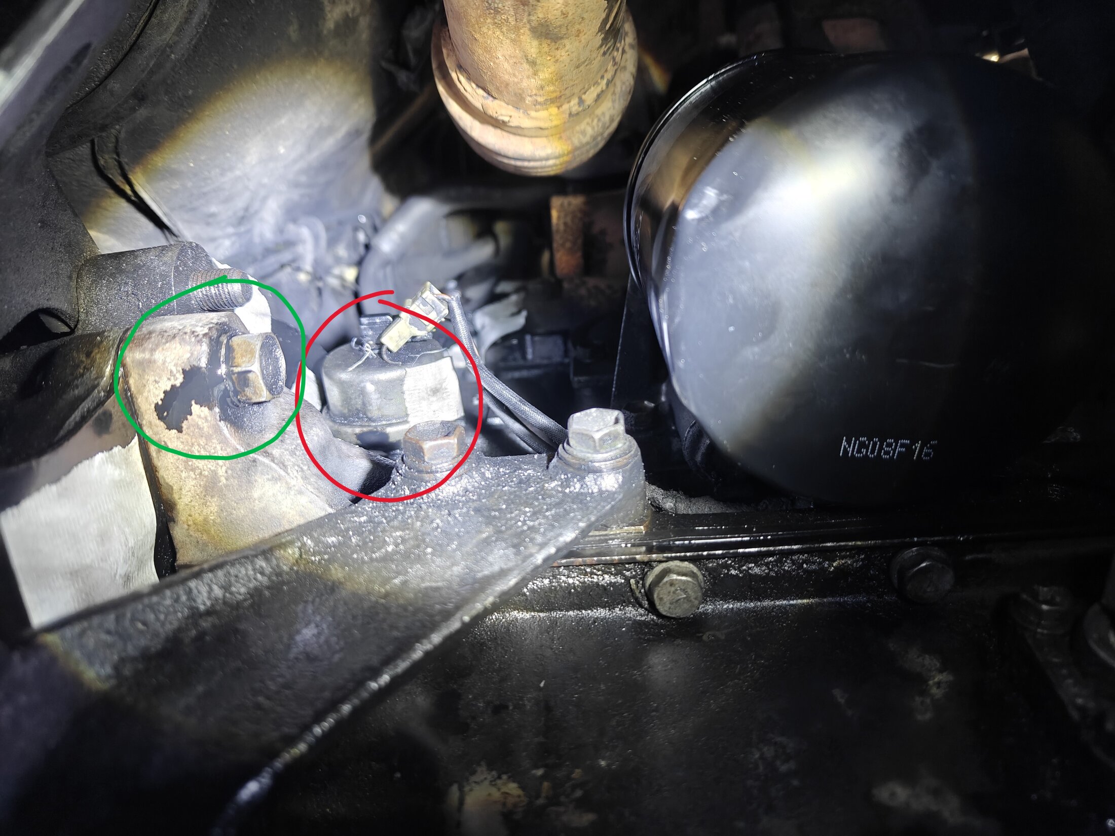

Dealing with a couple of oil leaks... one (in green) leaking through the bolt that fixes the clutch housing to the engine block. Will aim to replace the bolt with the proper sealant coating.
The other leak, in red appears to be sneaking out of the seal around that sensor. Will probably replace the seal but maybe the entire sensor while I'm at it. I'm new at this, does anyone know what sort of sensor that is? Can I hope for any help on a part number for either the gasket seal or the sensor itself?

Looked at mine and I think you’re showing:
GAGE ASSY,OIL PRESSURE SENDER​
Part number: 83520-60011​
