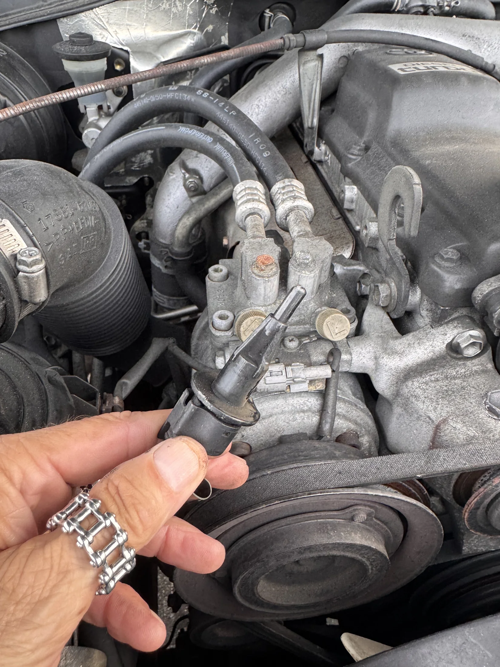

Does anybody know what this (looks like a sensor) is for? I just found it hanging around in my engine bay by the ac compressor

It looks like an air temperature sensor for the EFI system.
You are lucky. It appears to be intact. They have a tendency to fall tip first into hot things like the exhaust manifold, melting in the process.
There should be a port in the intake duct where it fits in.

I can’t seem to find the place where it goes ??? I don’t see a hole anywhere within the wires reach
Hello,
Check the intake duct, namely the rubber section between the air filter and the intake manifold. There should be a port there. Sometimes it is near the resonator.
The sensor needs a grommet to fit in the port. It is possible that you may have to order or fabricate one.
