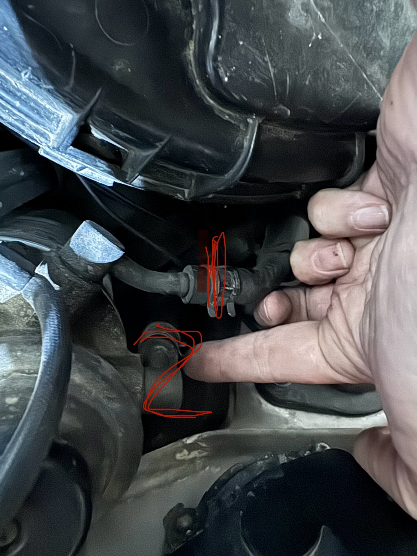

I think I can use either of these lines to tap into fuel. One should go to the engine and the other to the tank. I don’t want to run a new pickup to the tank (actually if it comes to that I won’t install it)
I was planning to tap the water pump into either of these. Are the flow directions right? I don’t want to work against the water pump. Probably just tap into the top one for ease of install
