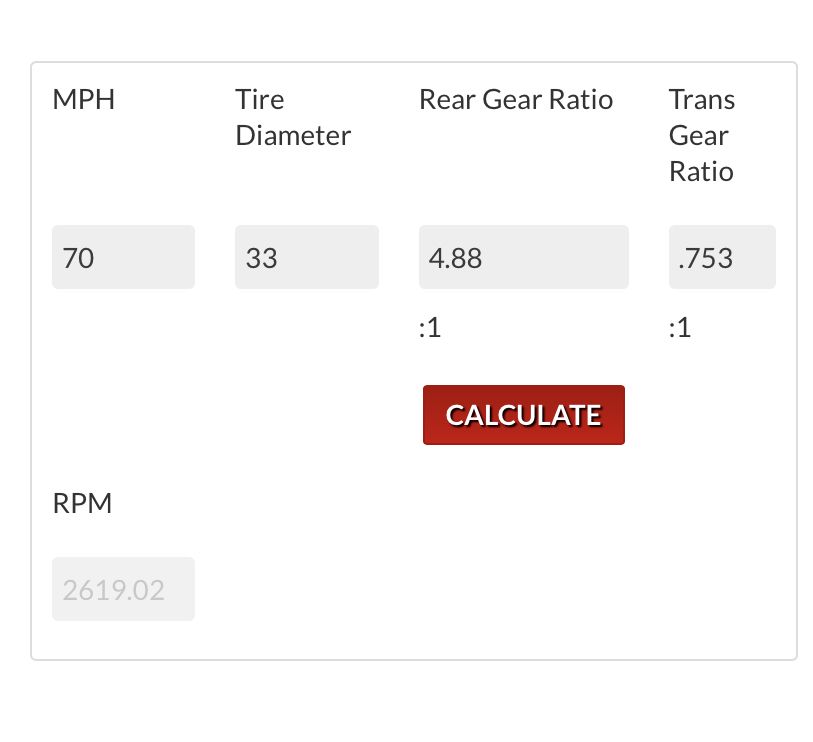

I’m needing to rebuild my diffs, as after 370k I’m starting to get a pinion growl. I tow about 2k pounds worth of off road trailer when I’m headed out on trail. I’m not interested in any tire bigger than 33’s, I’m not doing rocks. I’m torn between 4.56 and 4.88 for gears. I’d love to hear what kind of mileage and rpms folks are getting on 4.88’s. I’m supercharged and have about 70gal of fuel capacity, so unless the mileage drops bellow 12mpg, then I’m thinking the lower gears and 70mph cap would be about it?
lmk your experiencea please
thanks

I have exactly the setup you are thinking about.. 4:88s and 33’s. Personally I love the setup. RPM at 70 is not concerning nor is the sound harsh to my ears. Generally stick around 65 tho. Fuel,mileage went up slightly.. I don’t remember exactly how much. Maybe a .5 mile to the gallon. Uphill grades not as much work for the engine. Ever decide I need 35’s.. gearing would be close to original. Would I do it again.. YEP.

I'm running 4.88s on 33's - but I have a 3fe rig.
It runs at 2700 RPM on the highway at 70mph.
In my opinion 33's and 4.88s are an acceptable solution - BUT there's so many variables. How do you drive? How much highway? Are there hills where you live? Is 70mph fast enough for you? What's your weight? Do you tow?
For me, doing very little highway, and living in a hilly environment 4.88's work. I also like the idea of having a little margin left in my gearing if I decide to go larger. 35's with 4.56's just won't work for my rig.

If it’s anything like 5.29’s & 315’s (34.5”) - at sea level my limiting factor was not wanting to run over 65-70m-h max due to extended RPM range on motor.

That’s kinda my concerned about running about higher rpms. The 4.56 would still be 6 or so percent lower than stock with the 33’s. I don’t wanna spend this chunk of change again. Lol. I tried running in 3rd gear about 2600-2700, it runs smooth and actually quieter? Dunno

Lots of things to consider here I suppose. IF your Cruiser is used only for recreation and you don't travel hundreds of miles to get to your destinations....then I'd say 4.88's might be the way to go.
IF you also use your Cruiser to daily drive or use it often without pulling a trailer (extra fuel, etc) then I'd be content with 4.56 gearing. You are already SC'd which is primarily an advantage in High Range. Unladen.....I expect you are satisfied with the power you have now (on 4.11's). Going to 4.56 would give you an extra margin of torque without putting you at the upper end of the flat spot in the torque curve.
The 1FZ-FE has a very nice torque curve between about 1800 rpm and 2600rpm. Personally...I have found 2000-2200 to be the 'sweet spot'.
If you can achieve the power you want/need at 2200 rpm (highway speed) why spin the engine faster for no noticeable gain? IF you really, truly will NEVER go larger than a 33" tire, you don't rock crawl and you use your Cruiser for purposes other than off-roading....then carefully consider 4.56.
Either gear set (at highway speeds) will have you in the 'flat part' of the torque curve (which is amazing with this engine). Being SC'd only helps with this. So bottom line is: What type of driving do you do and under what conditions. Forget about off-road, you'll be in Low Range for anything serious there.
