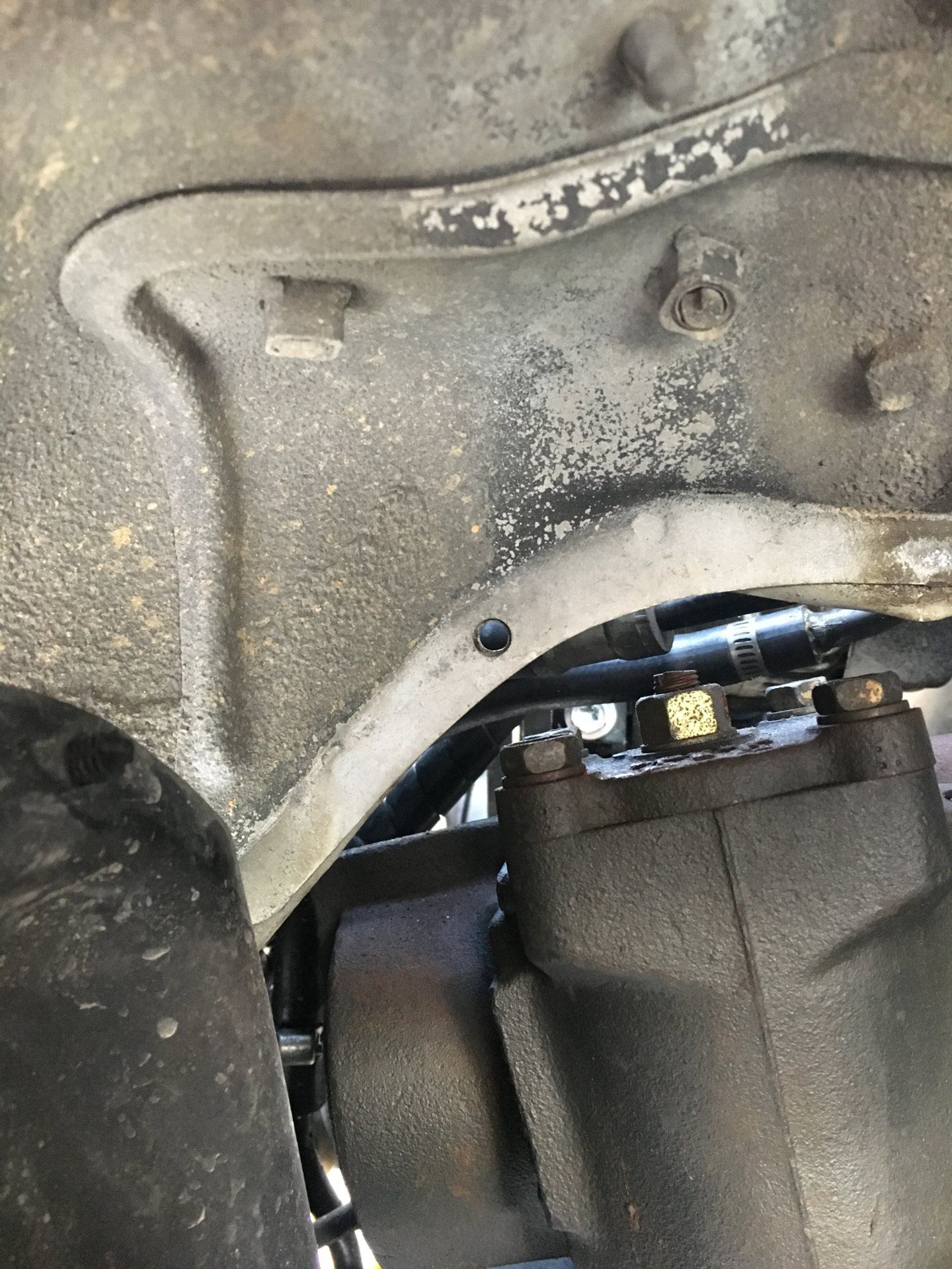

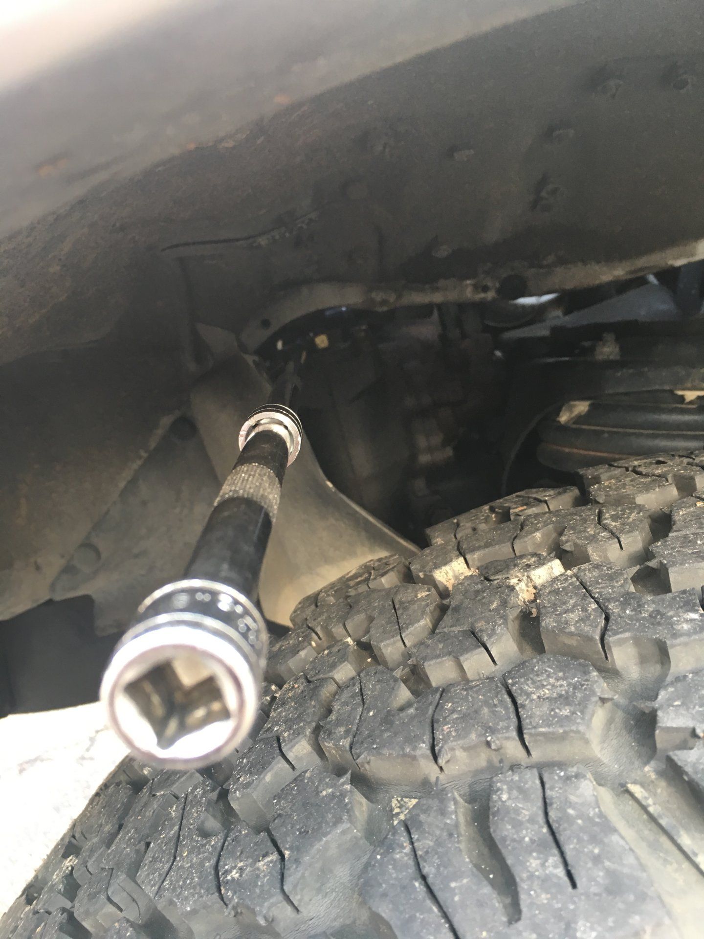

Easier way to get to the adjusting bolt. Long and medium extensions and either 12mm or 25(?) torx socket if your bolt has that head. Leave the battery where it is.
Round silver thing beyond the hoses in the pic (between the nuts) is your target
