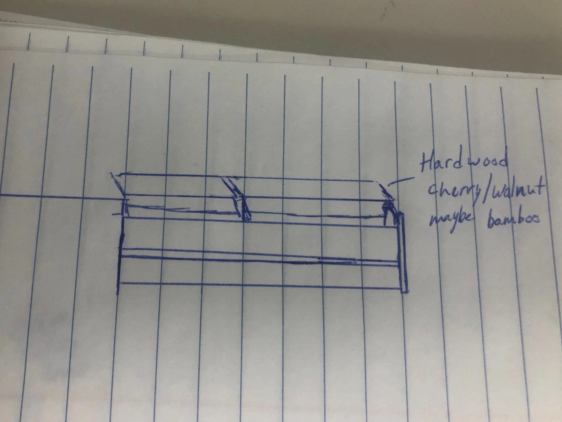

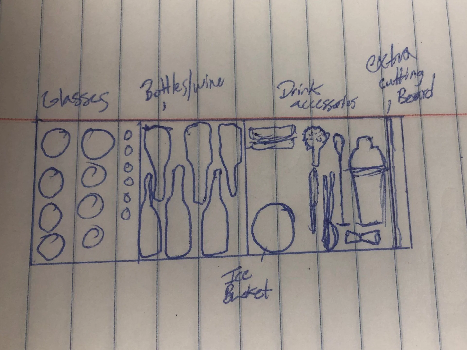

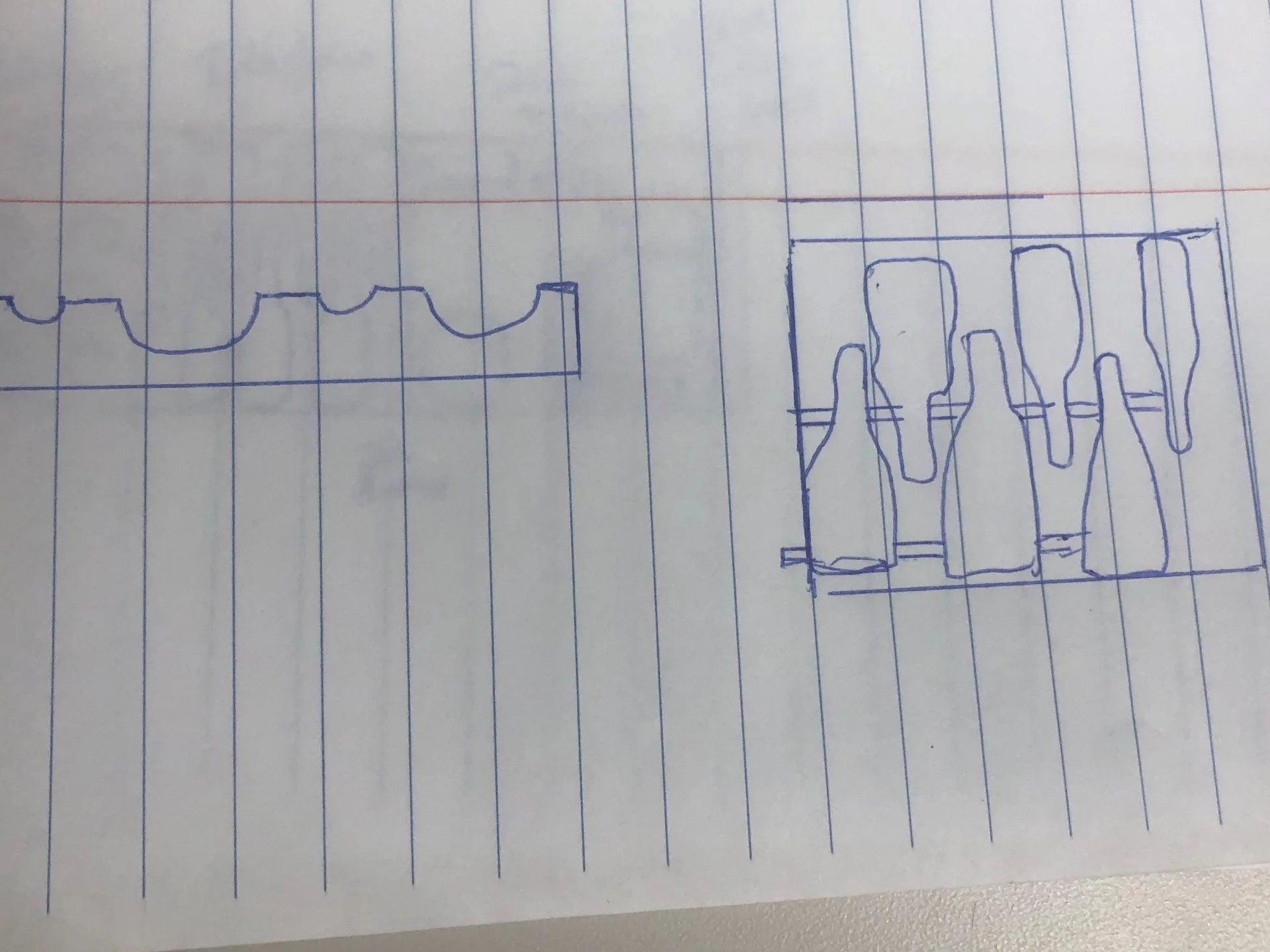

What are the dimensions of the inside of your ARB drawer? Not knowing your dimension here's what I've come up with in a brief not-to-scale crappy hand sketch.
A three piece modular system removable system.
First, if you can install heavy duty lift top hinges (like on some coffee tables) and have some hardwood cutting board/counter tops. I would split into two. These lift up and out of the way providing access underneath. These could be hardwood (cherry or walnut is best, or possibly bamboo). Could be custom designed with whatever you want or an inlay and juice trough or just flat sleek and nicely finished. Either way this would be the main thing people see, it gives that safari look, and its very functional serving/prep/and can double for cutting board, and its an actual bar for them to come up to and hang out while you get people their drinks.
Bottles could lay flat alternating on both sides and rest on wooden tracks with grooves for them to rest in. These probably already exist could probably be cut and changed to work for what you want. Only thing is bottles vary a good bit, but if you alternate the bottle have a track on both ends for the fatter bottom of the bottles and a track for the skinnier neck of the bottles in the middle it should work and they dont have to fit perfectly. Place these on thin piece of hardwood with edges. Could do leather snap button straps but probably not even necessary. Again depends on drawer height, you might be able to do two layers if you wanted to to maximize space. If this part had a mirror bottom that would be absolutely baller and look sooooo nice.
Glasses put in 2-3 inch deep foam insert with cutouts for the different size glasses if you want one layer. Or if your drawer has enough height that you could have two layers of glasses in foam inserts. I'd use a black dense foam inserted into 1/4" walnut with a handle in the middle to lift up to get the other glasses. Black and walnut with a darker finish looks good together. This is actually very cheap to do.
For the drink accessory stuff, I'd do a removable caddy with custom pockets for an ice bucket, mixing untensils, pairing knife, etc and custom pocket for your shaker with a leather snap button strap would look really nice.
If Its fitted together tightly enough you'd have no need to strap anything down, you could have a modular 3 or 4 part bar system nothing permanent.

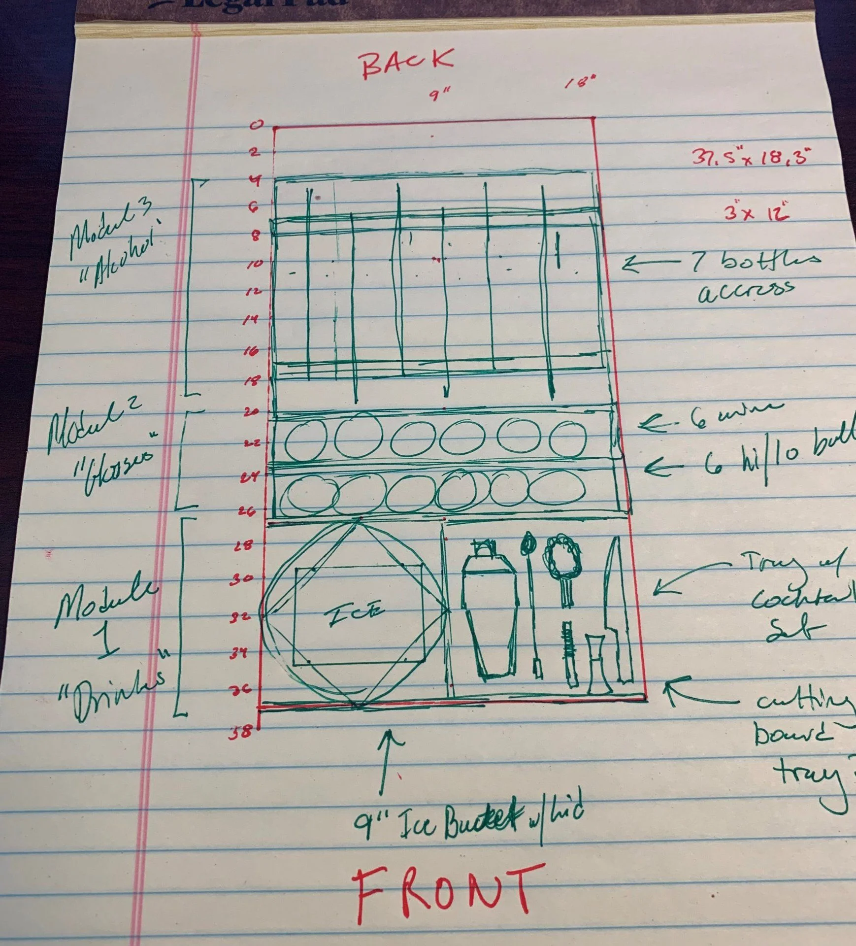

Really appreciate your insight here, think you 100% understand what we are aiming for in terms of form & function. I would love nothing less than whoever I partner with to make many times over their time and labor invested by selling a ton of them, but happy to eat the development cost to be first and get exactly what I want. Great point too on being "Kiboko" themed (gotta "ride for the brand"!).
In terms of dimensions, I have one ARB drawer fixed top (External specs 41" x 21" x 11" Internal specs 37.5" x 18.3" x 8.7") and one ARB drawer roller top (External specs same but the interior space ~1" shorter). Being modular helps here especially b/c the drawer doesn't slide 100% out of the frame when fully opened, so you can likely get more length out of the Safari Bar by put 1-2 pieces in and sliding them back before the final section gets dropped in.
Aesthetically, leather pulled over furniture foam might also be easier/cheaper b/c you can trim a block of that stuff fairly easily w/ a heated knife. Then you'd get the double protection for the glass of foam and leather. Could frame in a nice finishing wood, and that would look especially cool if the "lid" opened as you described into a bar top. In general though, I think trying to do more w/ foam and leather would be cheaper and better that predominantly wood which you point out gets expensive quick and is more limited shape form wise. With leather, I could also emboss the ranch cattle brand or Kiboko or whatever.
For the bottles, variation should not be a problem b/c always the same bourbon, vodka, gin, tequila, and rum. And wine bottles much more standardized. Probably have enough room for the bottle tray to be removable w/ the mixer can underneath it?

Interesting idea with the furniture foam, that would look incredibly sharp in a nice cognac/light brown midcentury leather framed in by wood. I think that would be super sharp for the glasses. Does the drawer pull all the way out to where you can see everything in the back of it? I still think bottles suspended on wood supports on each end over a mirror would have more visual effect than sitting on leather (though could be less practical), but mirrors and bars go together and mirrors add depth and lighting to small tight spaces. Between the wood/Leather/Glasses/mirror it would look like somehow stepped into an African hunting club.
I like the bottles over a mirror, agree that adds nice touch. The "wood" support cross beam though I would want to be covered in at least leather. Wood wise I would like it to just be the lid/bar-top and decorative outer trim of the 3 modules (and the frame i suppose). Rest of it leather/foam for look and protection.
