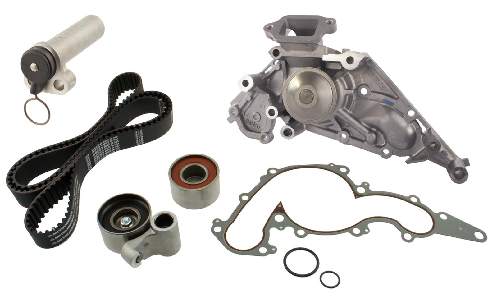

There sure is a wide variation in price in these kits:
Rock Auto: $165
Amazon:$174 (sounds like consensus is to steer clear) Amazon product ASIN B008EEYWKI
Summit (who I've always trusted): $202
NAPA: $285
Amazon can be sketchy and eBay of course is full of counterfeit stuff, but the others are legit sites, that's like a 72% jump from Rock Auto to NAPA, what's the deal?

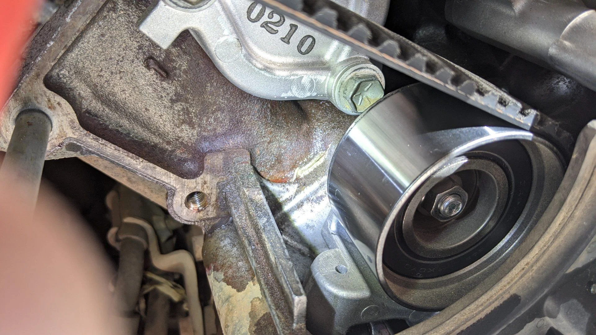

I used an Amazon-sources TKT-021 (Aisin) timing belt kit. The pump looked a little off but I didn't think anything of it. There was also the chance that maybe the gasket got roughed up in skipping.
In either case, it appears that I've had a failure of the gasket after 1,000 miles since the replacement. Hopefully I can find a smoking gun when I have it all apart, but I'll be replacing the Aisin stuff with Toyota.
