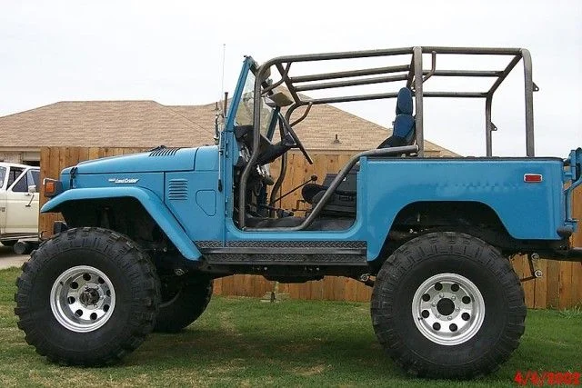

Also - the height in some of those pictures is downright scary. I really liked the low profile I ran when SUA. I'm in the middle of my SOA with stock springs with the 46" Man-a-Fre add a leaves on order and my goal is going to be to stay as low as possible.

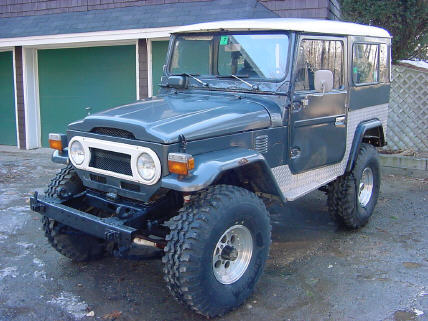

pbgbottle said:
heres mine ,body tub trimmed , stock springs , extra stock leaf added to all 4 packs , 38.5 swamps ,and a 3 inch body , i know everybody hates body lifts but it works for me , did not flip rear springs , just drilled a new hole in the spring perch and move axle back 1 1/2 inches , for the front ,shackle reversal , flipped springs , new hole drilled in perch to move axle back a inch or so to stop the tire from wacking my fender and stock length shackles
