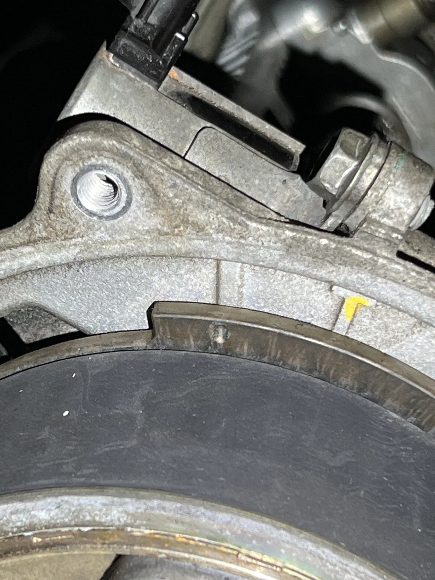

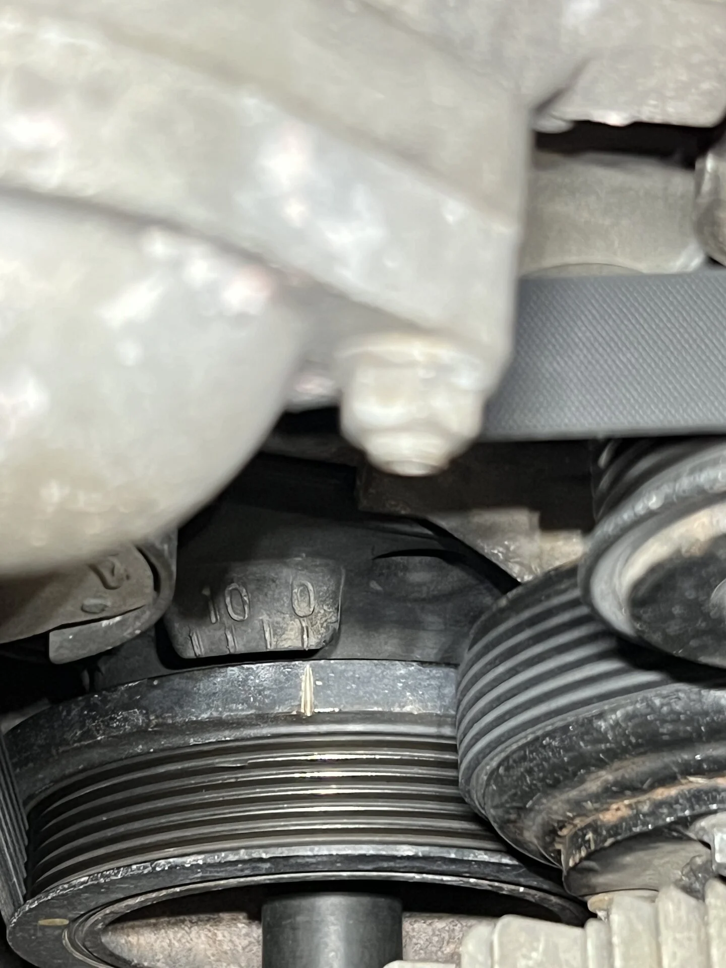

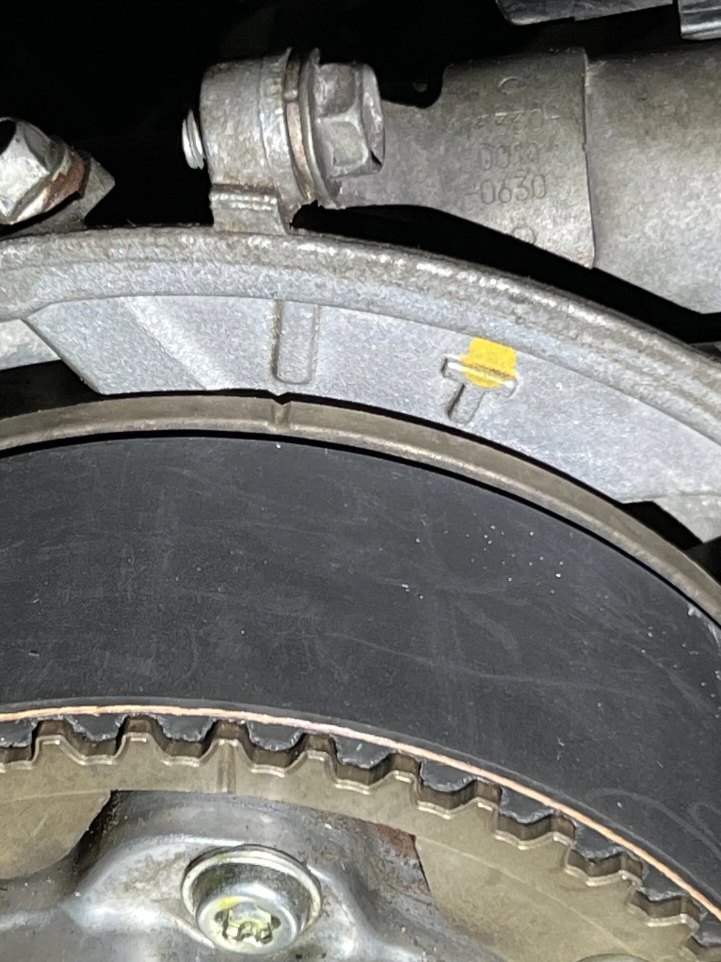

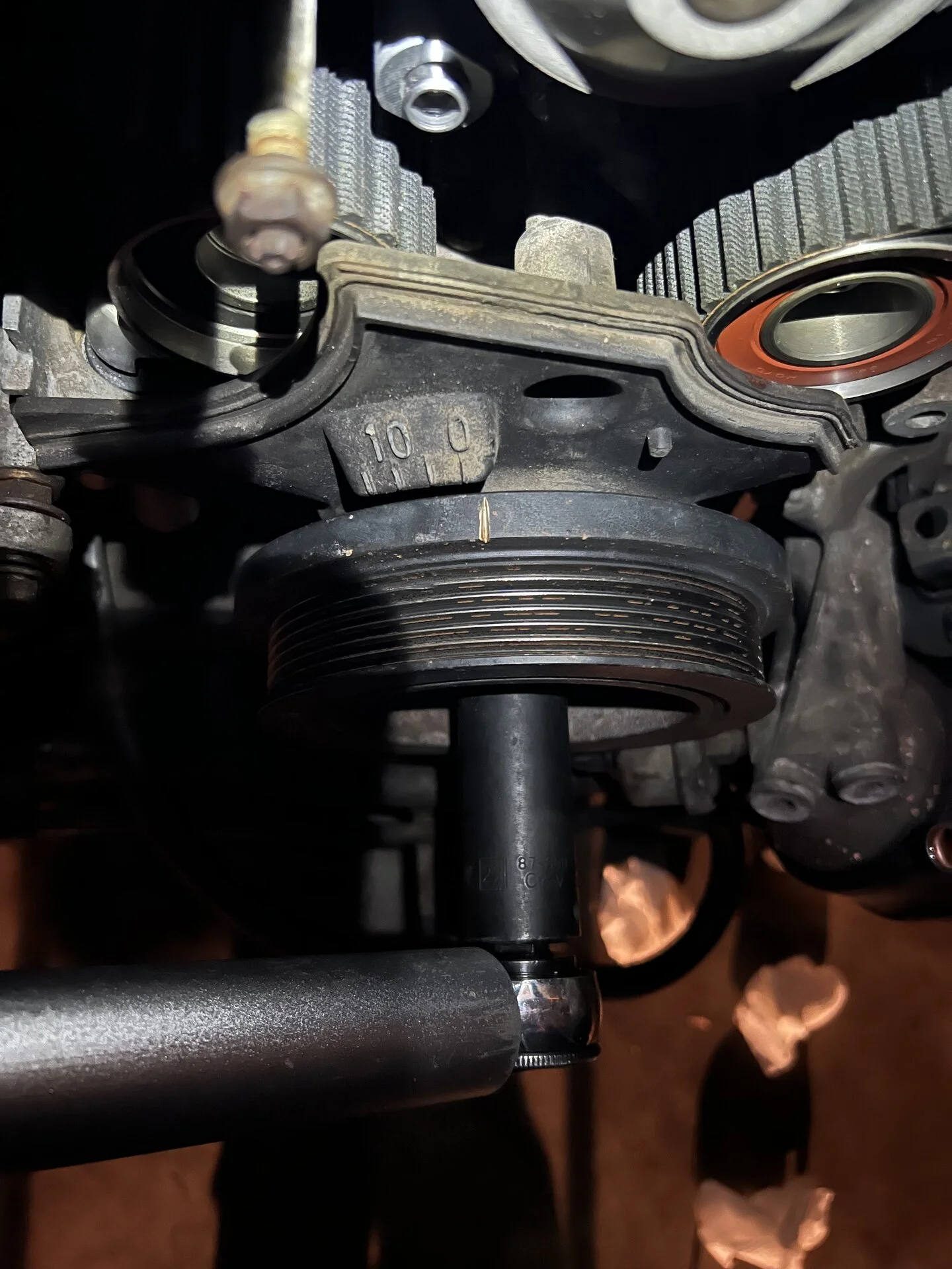

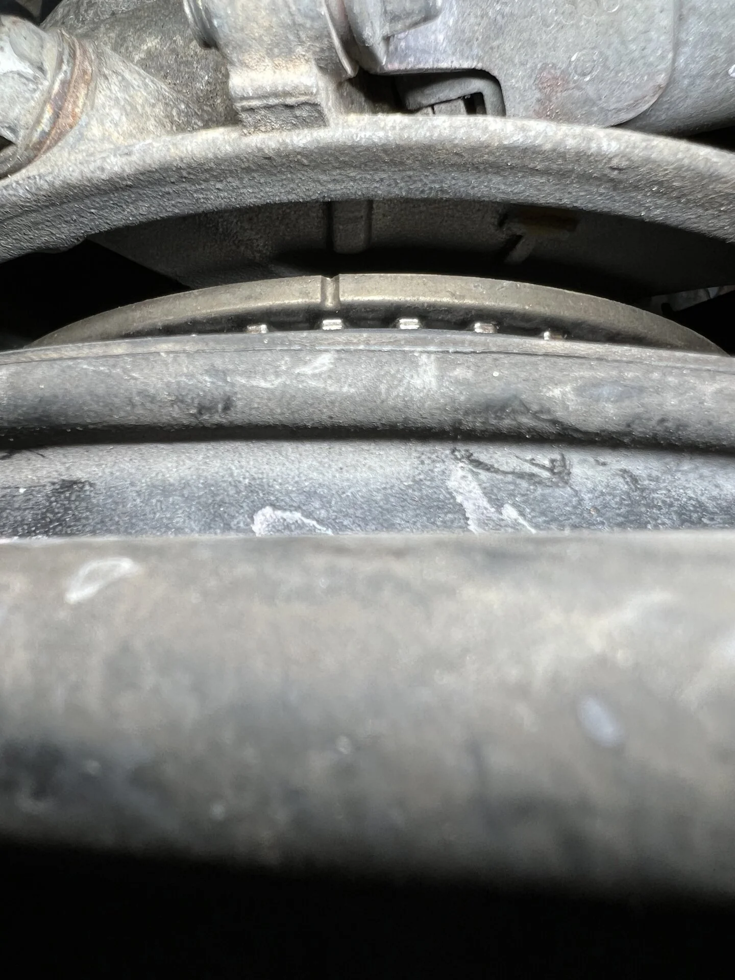

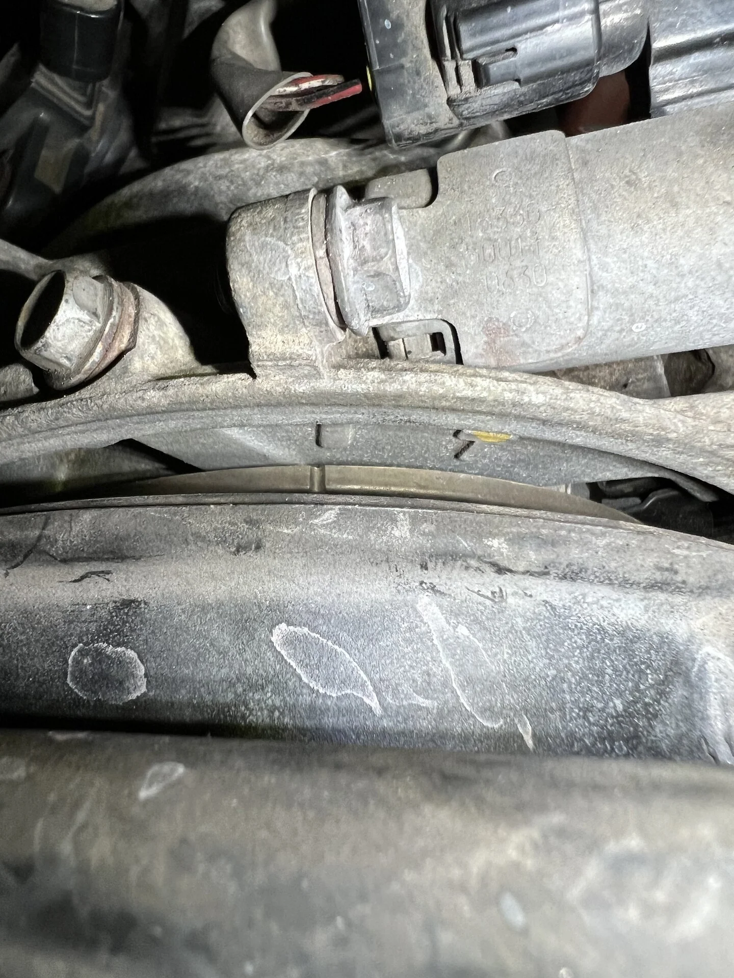

I posted on here before about my 3 dots lining up but when putting the cover back on it was off a bit on the plastic cover “0”.
So now that everything is back together, I figure let me check timing with it lined up on the 0 even though I was lined up on oil sump when I installed.
Anyway, please see pics and tell me how I would fix the half a tooth off if this is my problem? Why would it only be bank 2?

It does look like something is one tooth off in the timing assembly. Could be the result of tension settling in after installation.
Has the engine been compression- and leakdown-tested?
That’s is based on the plastic timing cover but it is still dead on with the divet on the block
