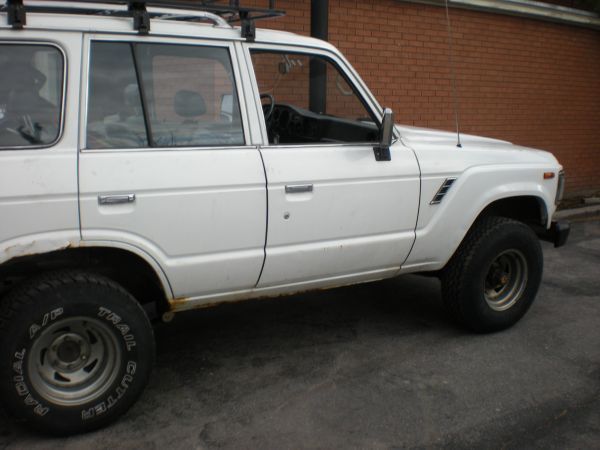

It will be exciting to finally put a face to mudders at slickrock campground, I'm really looking forward to CM. Here is another before shot in Uwharrie national park in NC with my brother in law. Totally stock except 31's. Man, one winter in UT has definitely brought the rust on, it doesn't look like this anymore:crybaby:.

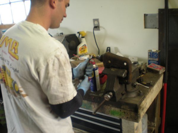

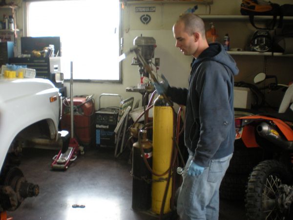

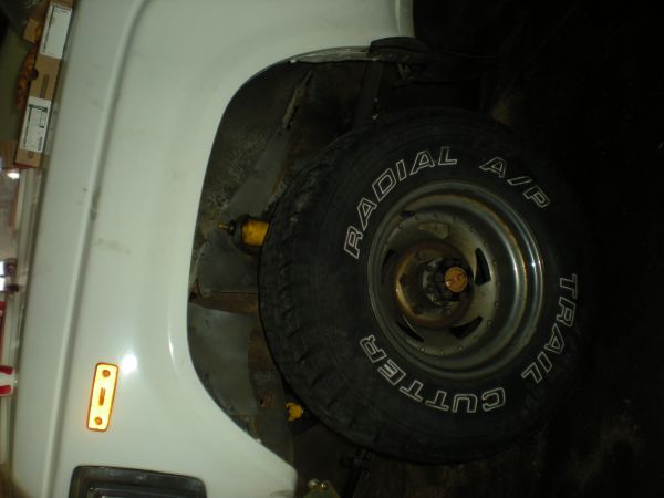

I soaked everything in PB blaster for two weeks straight before the install, so the bolts came off pretty well (all but one...). But the bushings were toast. After pounding and chiseling to no avail Christian broke out the torch and burned the old stuff out.
When removing the rear shocks we broke a bolt. We tried welding another bolt on and unscrewing it but it didn't want to budge, so we just welded a new bolt to the remaining portion, threaded it, and called it good.

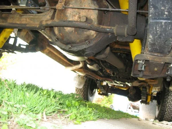

Next came the locker install. I wish I would have taken more pics. It wasn't too bad, we put in a lock-right and the worst part was the second c-clip. We used black permatex for the gasket and put in a heavy weight oil. The first few times I drove it it clicked, but I haven't heard it since! I do get the occassional tire chirp, but nothing too bad. We'll see how it does in the snow. You can also see the new muffler in this shot, it's tucked up nice and tight. The previous muffler was more swiss cheese than muffle. It also now exits behind the driver's rear tire instead of the back, hopefully I won't squish it coming off of the fins in Moab. And yes, that's a bad bondo job in the wheel well, I had an enterprising guy follow me home one day and offer to do body work in our parking lot. He had all of the tools in his trunk and said he would replace the rust with metal. I left him for a little bit to work on it (bad mistake), came back and he was actually using tinfoil (no I'm not making that up) as his "metal replacement" under the bondo. I was pretty mad but it was already on there. Another project for later this summer.
