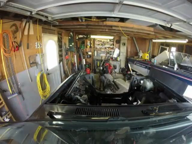

Wow he has changed it kit up completely. Making a bell housing in stead of adapter plate. Interesting.
Do you have the engine sitting in the truck. How much room over on the driver side with the p-pump? Phil and I debated going p-pump on his but like the small simplicity the VE offered. Either can get you lots of power adders with some screw turning and light grinder massaging.
Looking good so far
Ve pump has it limits where the p-pump it's endless. Though we don't really need 800hp and 1200ft lbs of torque :D.
Man I can't wait to do mine!! Feeling jealous right now :)
Only one way to find out the limits and how far you can take her. Then when it breaks you make it stronger. My goal is going to be 450-500hp already have an upgraded turbo, injectors and a fuel plate. OP you need some vids when you get her up and running :)
Looking good so far
its really tight at the power steering pump to power steering gear box, I also took the vavle cover off closest to the firewall, only way I could get the motor mounts on.
Did you have to reroute heater valve hoses at all? My bottom hose, coming off the "u turn" fitting kisses the back valve cover. I have deleted the rear heater.
Sweet! The trans cooler hard lines won't work there. I did the same thing. The inter cooler pipe runs along there and bolts to one of the motor holes. I ended up using soft lines all along there and ty-rap them to the intercooler pipe.
Glad you got all those parts at least!
I might do that, I ripped all the hoses apart all the way to the rear heat under the cab. Do you just plug those pipes and call it done?
oh man thats gonna suck to do now, funny thats how the instructions say to run them.
