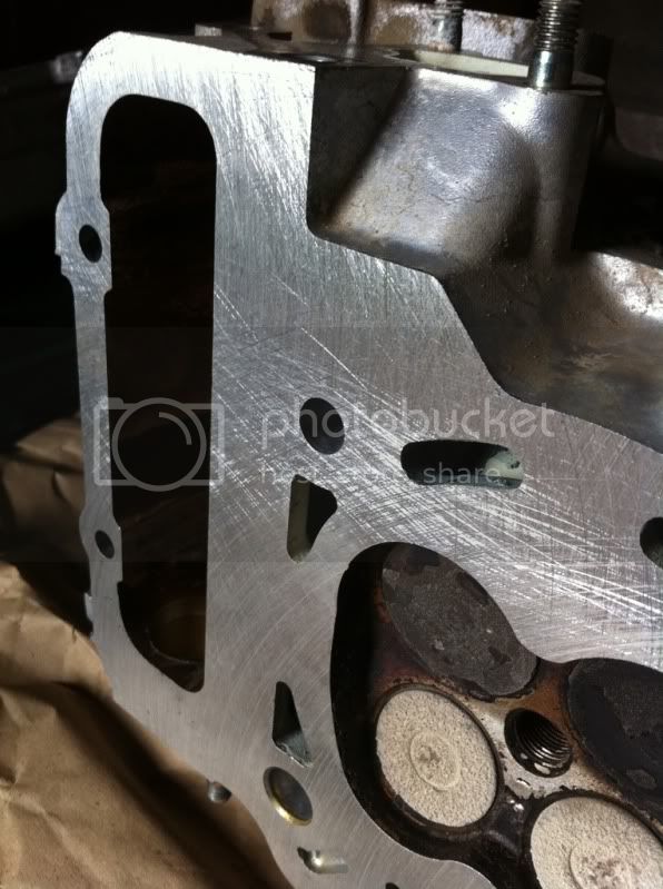

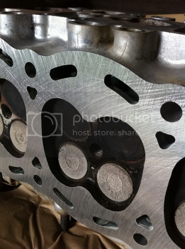

I got the head back from the shop. The machine work on the surface seems very rough, is this ok? I don't want to put it on and have another HG failure.
