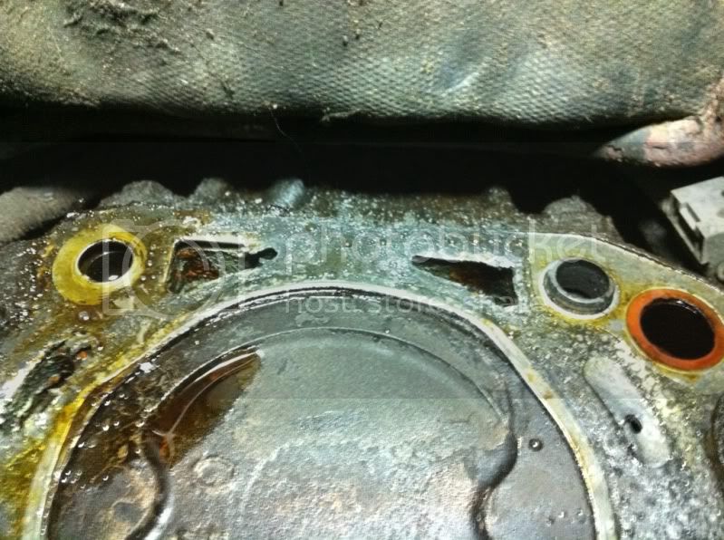

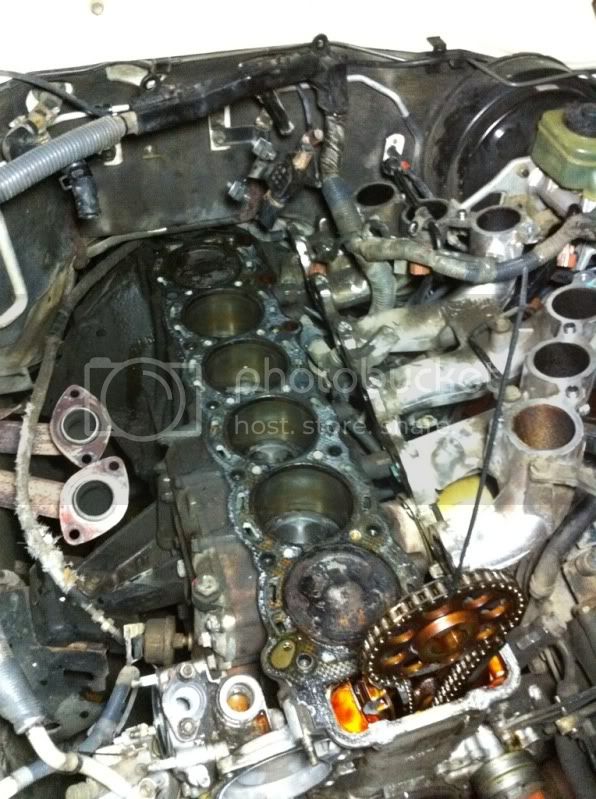

Here are a few pics of the leaking LC:

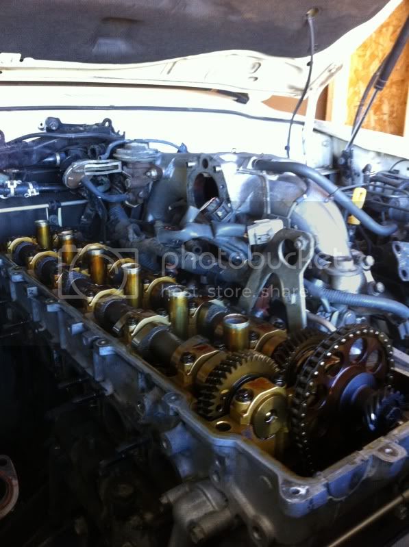

Tear down in progress

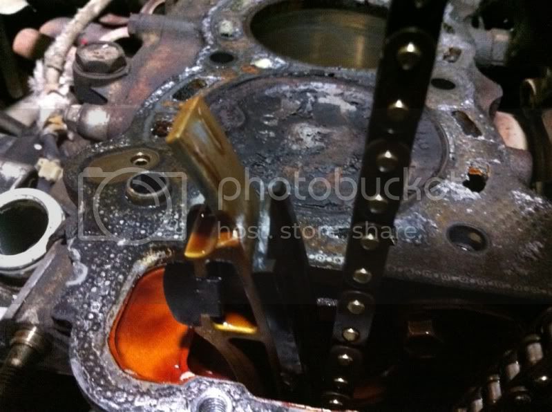

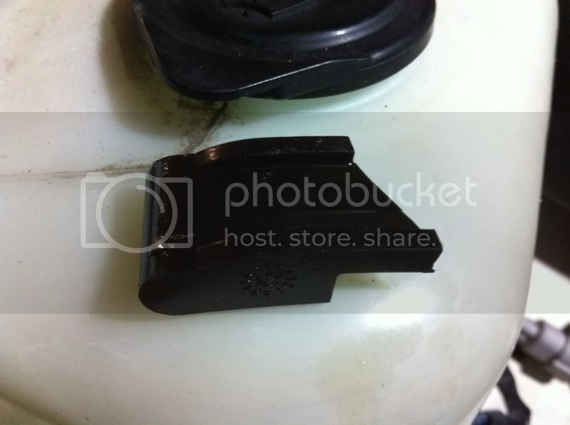

Well, got the head off tonight! What a PITA! So, looking at the gasket I'm not seeing the carnage on #6 as I was expecting, must have caught it very early. While man handling the head off the block, I must have broke the tip off the PS slipper, is this going to mean a mandatory timing chain replacement? I'm sure I did something wrong, probably should have zip tied the whole thing...I bet 10 bucks that was covered in the DVD that I don't have yet. I also broke a sensor off the block with the loose intake manifold! Good times! Will post some pics tomorrow

A couple of threads here point out the zip tying of the timing gear - I ended up with three: 10 o'clock position, 2 o'clock position, and a tight one at the tip of the slipper to hold everything nice, tight, and high so you don't slip a tooth. Can you find the bit that chipped off? Gonna let stay in there? How big of a piece (pix perhaps)?

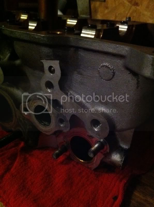

Are you going to have a shop evaluate the head? That might be why you don't see too much carnage on the gasket; the head may be warped - that was the culprit on mine. I also notice you don't have a Mr. T # plate on your head (pix #2) near the water inlet. Is this the truck's first HG job? Aftermarket casts (like mine) will not have these and the machine shop found my head decked so far before that it was indicative of a poor aftermarket cast or from a head/cylinder exchange. I hope you don't find the same results as mine.
Yes, I will be having a shop check out the head, hope all is well with it...
I missed the whole zip tie all over the place...I found the piece that broke off.
Here is one of the gasket....
Not sure about the Mr. T number plate, this is above the coolant bypass?
and one parting shot of the whole damn mess!
1. The big question of the day is, because I snapped that piece off of the slipper, would you change the timing chain?
2. I do have some leaks down below so that would be a good time to fix them, pull oil pan, front crank seal.....anything else while/if I'm down there?
IMHO - front of the motor would be coming off. It may be extreme but the "What if" factor would consume me. Others will probably have differing opinions I'm sure. New slipper and chain would be on order
If you're that far (taking front off), I would definately be replacing the front main seal, oil pump cover gasket, and dizzy o-ring. Some may even suggest if you're going that far (front off and pan off) to think of checking bottom bearings, etc.

I just read through your HG job, I sure hope my head is OK, will find out tomorrow. Is that hologram deal a known fact (original head)? I added a pic of that area, (earlier post) it's not on mine. I sort of work with the PO of mine and he says, no engine work had been done, nothing that major anyway...
