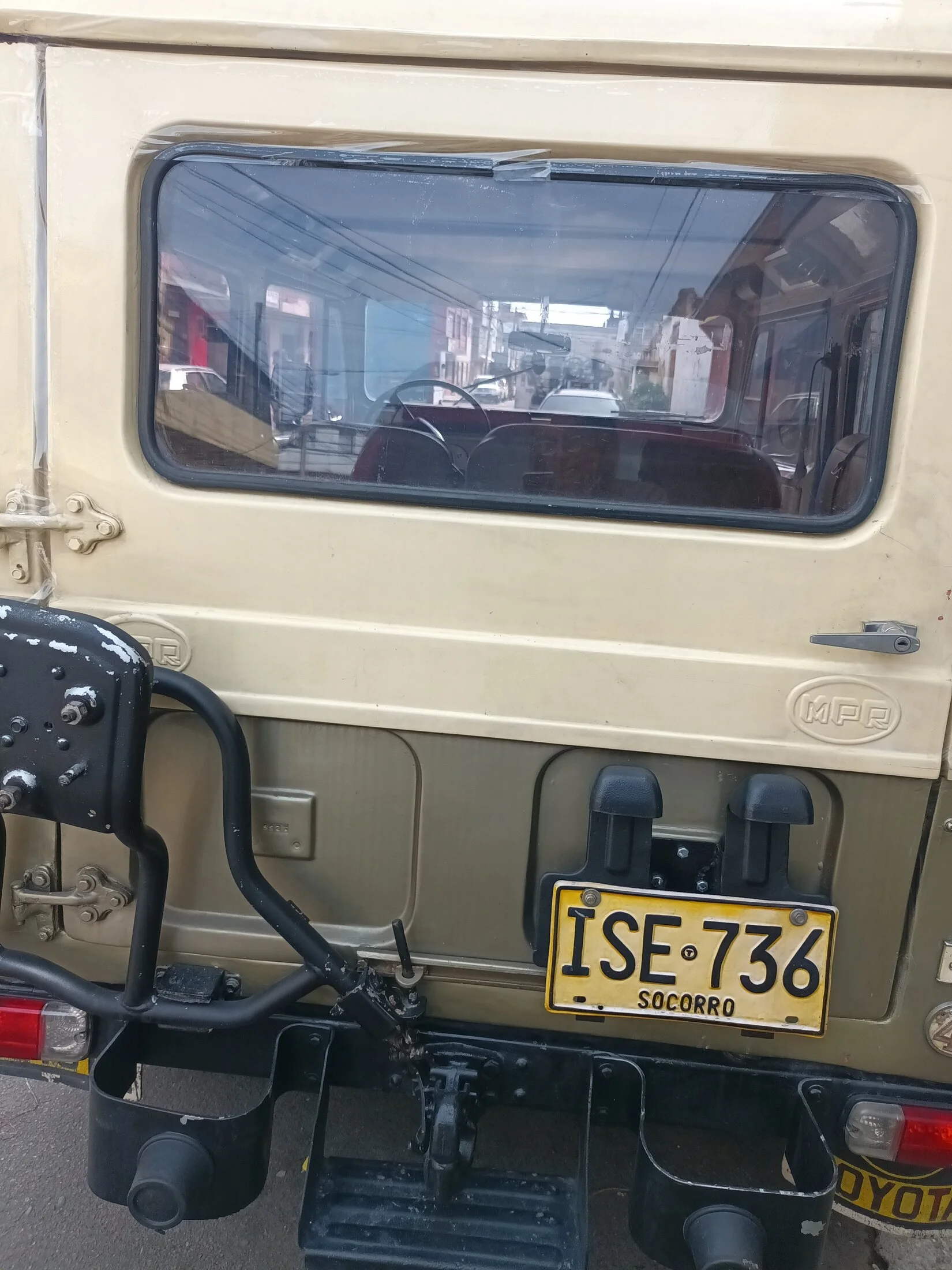

Best of the season to everyone in toyotalandia. Quick question for you customisers, I wanna pop the top and cut my rear ambulance door to a gate, moving the latch down a foot or so. Is this feasible, or am I entering a world of pain trying to refit everything..?

Ok cool thanks, I have a single right to left swing door so it's a lot less complicated. Good luck, can't wait to see how it turns out.

You may have never seen a door like that. These FJs came to Colombia without tops or back doors, they were manufactured here and fitted by one of two companies in Bogota. Mine's an MPR, with a single door that swings out horizontally,. you can see the brand in the photo. The spare's on a rack bolted to the frame and hooked to a runner at the bottom of the door and swings out with it.

I misunderstood. I thought that you were asking about factory ambulance doors. I didn’t see the picture of your MPR top when I posted. I agree that your setup looks a lot less complicated. I’ll be following along if this thread turns into a build thread.

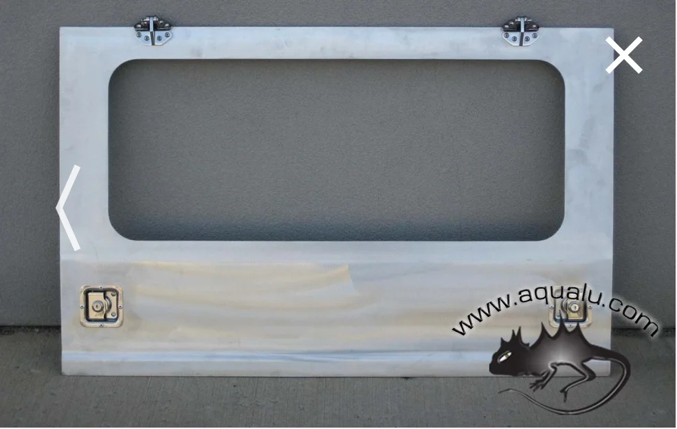

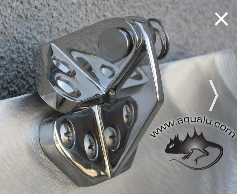

If I was doing it I’d probably do something similar to this…
The pictures are from Aqualu’s site. The hinges they use would likely be easier to source than original Fj40 hinges. Alternatively, you could keep your one piece door and build a custom tailgate. I’ve always thought the one big door would be convenient. I do, however, like having a tailgate/tire carrier and a hatch. Unfortunately, I’ve never quite got to designing weatherstripping/hardware to seal the hatch to the tailgate. Over the last 20+ years I’ve had several different ideas. Hopefully 2025 will be the be the year to fix all the weatherstripping on my 40. Even the foam in the heater is worn out. After decades of a breezy 40, I don’t know what I’d do if it was no longer a wind tunnel inside my 40. 🤷‍♂️
