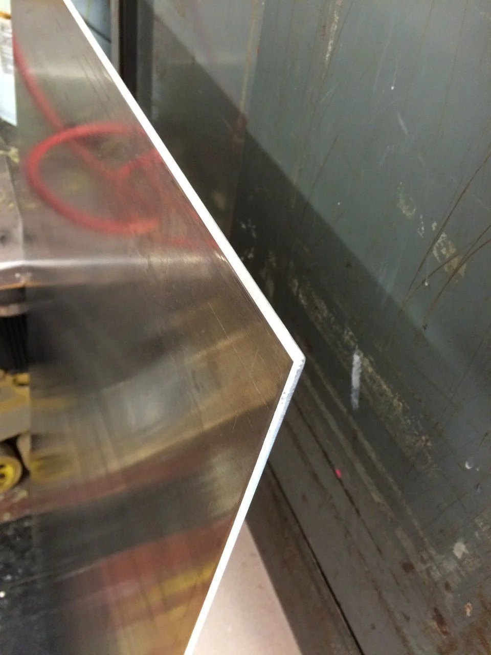

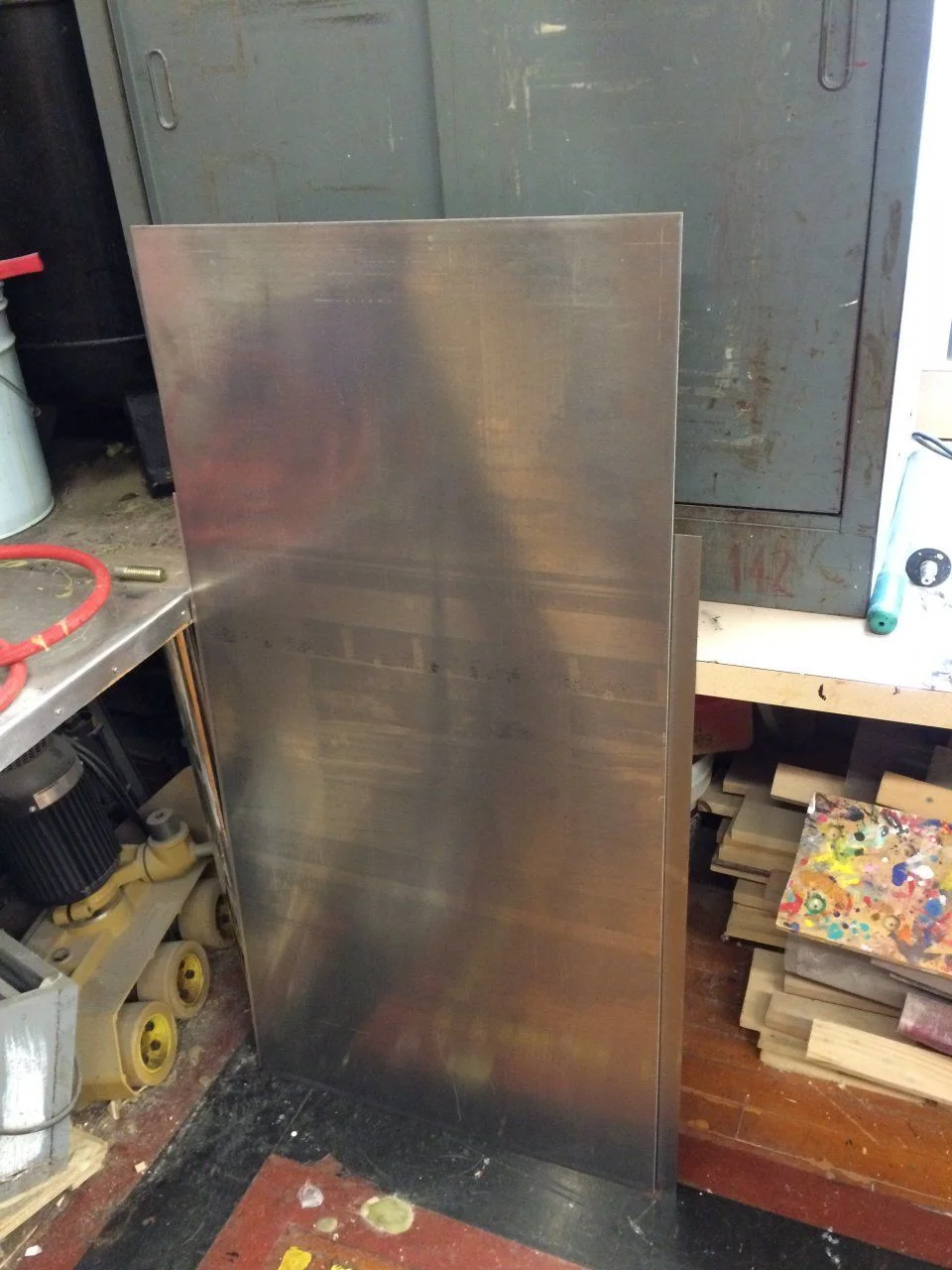

Well it's much thicker than I thought... Buddy brought it down to me the other day... Has a few minor dings... Very hard to see
I'm thinking I may have an issue bending a lip for the doors to overlap

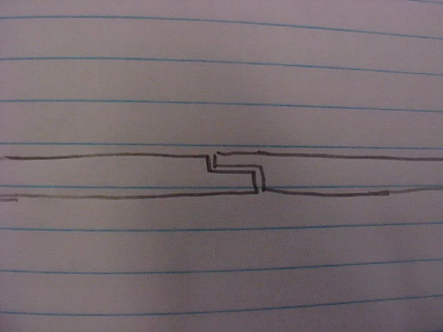

i was thinking that I could just do this for the doors to overlap
Do you have a good heavy duty router? A good router, such as the Porter-Cable 690 1.75 HP, or the Porter-Cable 691 1.75 D handle (same motor different handles), a straight edge and clamps for a fence, and a double flute carbide bit with preferably a half inch shank would do the job. Start with a fresh bit, go slow and easy, and do the cut with several passes. Aluminum can be worked with carbide cutters by going slow and easy, but the sharp edge on the carbide will be dulled much more quickly, so be vigilant about the cutter condition. Again, the flying shavings will be hot, so be dressed appropriately.
Your .190 (just over 3/16"I) thick aluminum will end up thin after doing the rabbit cut. You will end up with a maximum of 3/32" thickness for each lap cut. This is not allowing for anything between the two overlapping surfaces. I'm a cabinetmaker by trade, not a metalworker, so I'm not familiar with the strength properties of the aluminum. I just know from experience that aluminum can be milled with the proper woodworking equipment IF you are set up with good equipment, and IF you are very careful doing the work.
You COULD do this on a table saw IF you have a good saw and blade, are experienced with using a saw, and know how to properly set up for the cut. However, in my opinion the router would be much safer as a saw blade will tend to catch the work piece and draw it into the blade in the blink of an eye.
Don
Great idea for using the router ... I have a table top router at work :)
We have used our table saw before for cutting a friends 1/2" aluminum that he was using for his race sled ( can't recall what it was used for ) it cut very easy
For just cutting to size you can't beat a table saw. But, to do a clean rabbet a router will do a much better job.

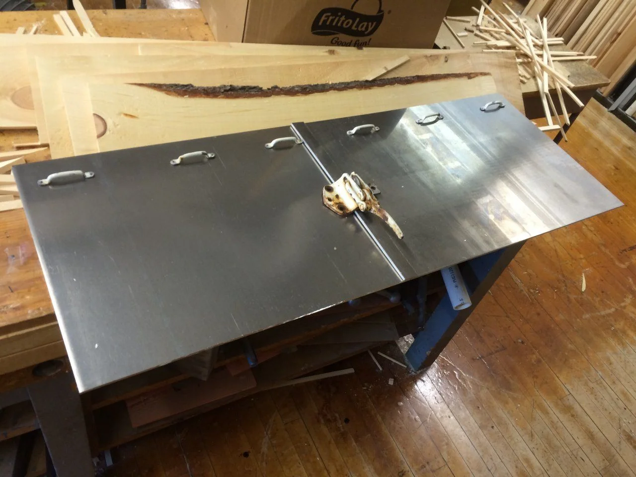

i made the same style doors from 1/4 " steel plate always thought they looked ok and after 26 years on the truck the still didnt rust. aluminum would have been a better choice and will be my next set if i ever need to make more, some nice ideas on here
nice wood planks , is it white pine ?
about the doors ,i like the idea of keeping a stock look by cutting the center , with hinges and a lock , it could be a quick access door for recovery gears like a tow rope without the need of openning the soft top rear window.
Interesting idea for sure... I like your idea :)

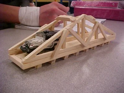

Yes pine... It's cheap wood... Many knots ... We rip it down to 3/16 strips for miniature bridge building
Some student work :) with test vehicle as part of the criteria 'to allow Mr Cs car to drive across'
