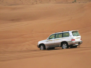

Momentum is the name of the game on soft sand. Even though your 4WD may be horizontal, the tires have ‘sunk’ and you are actually driving uphill. These conditions require smooth, uninterrupted power to maintain your progress. It is better to run in low range, even if you think you can get away with high range. When soft sand suddenly appears, you are then in a position to pour on the power without the need to stop and move the transfer case lever to low. In a manual vehicle, try to make the gear changes as quickly as you can, so that the vehicle has as little time as possible to drop off the pace.
If other vehicles have been using the beach, it is generally best to follow their tracks. Chances are that, if they made it, so will you. Experience will help you to choose the firmest sand, but even the experienced drivers sometimes get it wrong.

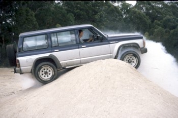

When ascending or descending steep sand hills, drive straight up or straight down. Don’t try to drive across the face of a dune, or try to turn around. There is less chance of rolling over if your vehicle is facing straight up, or straight down. Making a decision to deviate ‘just a bit’ can easily lead to a rollover and the resultant trauma that entails.
When descending a dune, drive down. Even though the descent may be steep, the vehicle will want to bury its front wheels, and you will need plenty of power to get you down. The driving wheels will also help to keep the vehicle straight. Braking in these conditions is unnecessary and may cause the vehicle to slew around to a dangerous position.

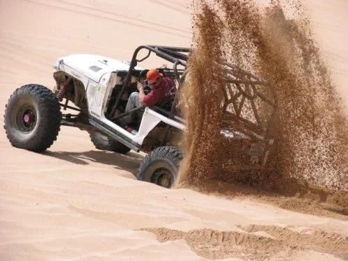

At the sand drags low profile (small diameter) paddles (aggressive thread) work best. Front drive don't matter 'cause those wheels should be in the air. Go figure.
Riding in a Northstar powered buggy with WIDE paddles is amazing. Looking back over my shoulder I saw we were throwing a solid stream of sand. Imagine a continuous stream of sand bags being launched by a heavy duty pitching machine. It reminded me of a jet boat. I did some quick F=mA calcs in my head as we launched over a dune and realized if you can throw enough sand behind you, you will accelerate in the other direction!
