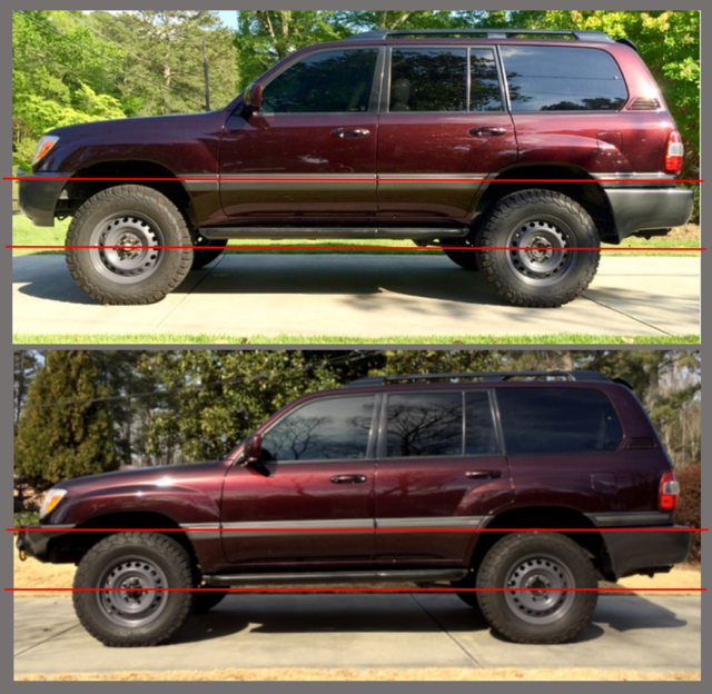

Front: 22"
Rear: 23.25"
23,000 miles and all's good. However, very soon after the lift was done, the axles went. But the new axles seem very happy. As has been stated a bunch - it's not the lift, it's the change.
Also, that 1.25" difference b/w F and R is hugely important. Initially, my 100 was damn near level, and holy $%#* did it suck - rode like a brick, the steering was vague.. it sucked. Dropped it about .75 up front it felt like factory. Gotta have that rake.
(the Dissent Offroad bumper and Warn 9500ti only dropped the front about .25"; the other .50 was from backing off the bolts)
Front: 22"
Rear: 23.25"

Front: 22"
Rear: 23.25"
I know its' not loaded up or anything, but purely from an appearance standpoint I think you nailed the perfect ratio of front to back & clearance above the tires.

I agree that a number of newly lifted 100 series can be "fixed" with adding some "rake" back to the vehicle, but I don't think that the "rake" is what fixes the issue, so much as it is lowering the front to an acceptable level.
I accept that I am in the minority on mud with my opinion on "rake". To me, the "rake" argument seems to be a simple/polite way of saying "you got too excited with a wrench, and cranked the front end too high", without having to explain the limitations of the 100 series torsion bar IFS.
I don't think it's that simple. I'm convinced it's more about the geometry. Caster changes when rake changes. Have you driven a 100 with no rake? It's odd... totally different feel, and odd behaviors like weak or total lack of self-centering wheel, e.g. not unwinding when you let go of the wheel. Weight-transfer may play a part too - at least in the ride. Either way, dropping .75" was magical.
