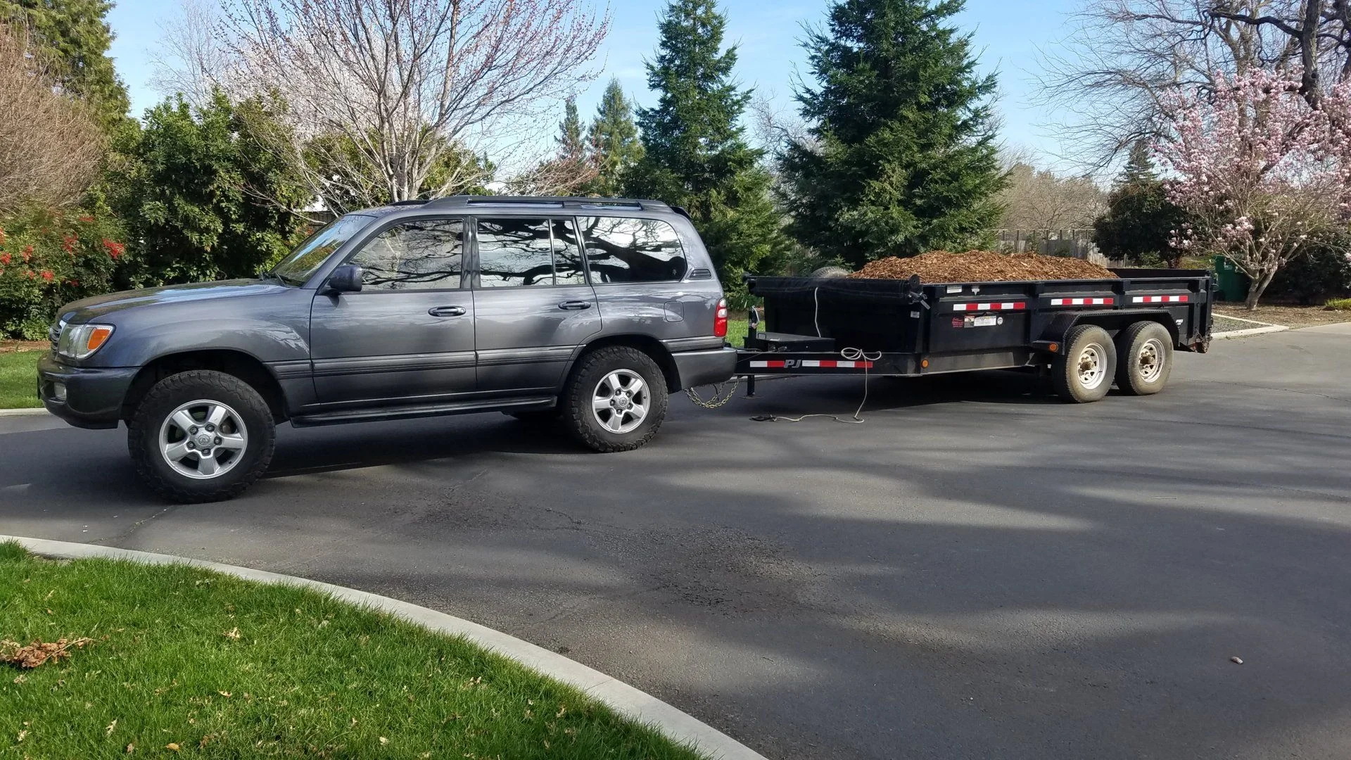

I've hauled a dual axle hydraulic dump trailer full of mulch with mine. I'm guessing total weight about 8,000 lbs but only for a few miles. I tow this trailer with 35 psi in the bags and haven't had one rupture. I've towed it a lighter weight (6K?) for 60 70 miles without problems. I tow my boat which is somewhere around 3-3,500 lbs with 25 psi in the bags.
