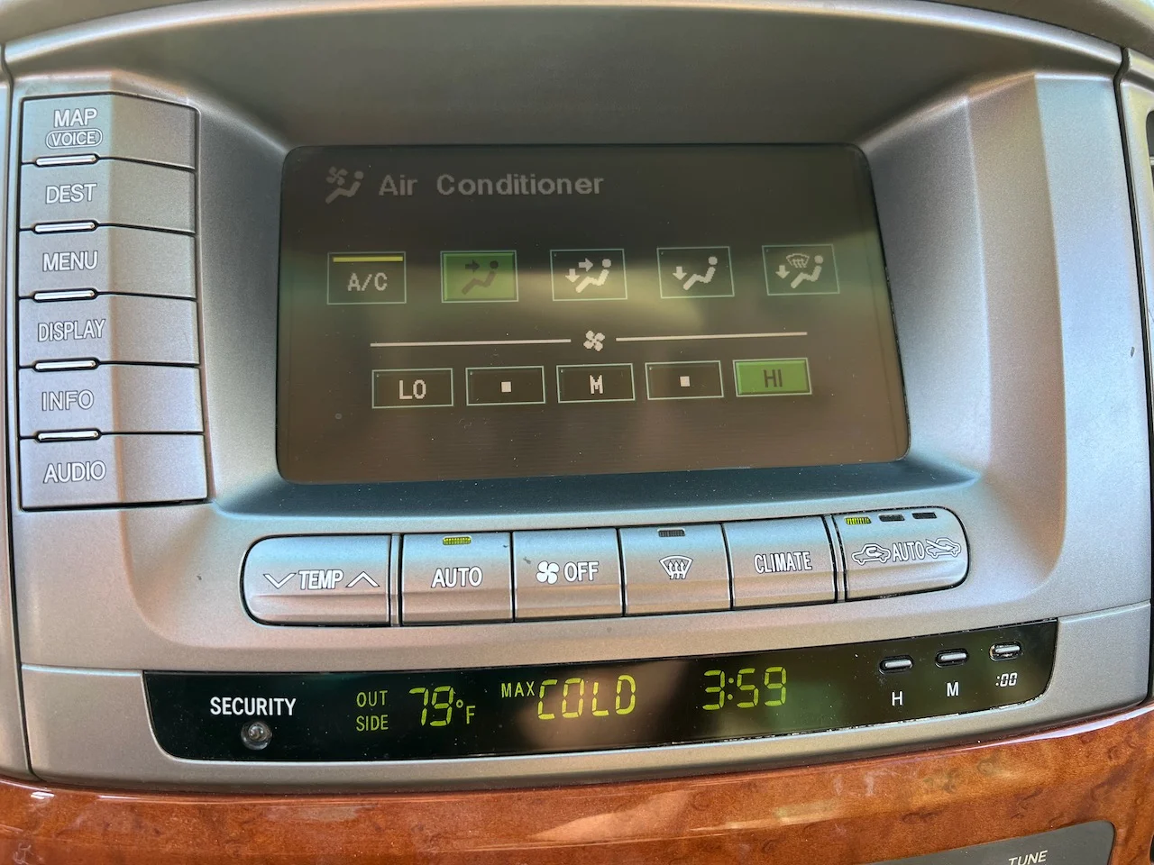

Well anyway... Took it into a shop that knows Land Cruisers and they ended up finding some leaking O-rings so replaced those and recharged the system. All good, right? No... The AC does not blow cold except when in MAX Cold... I touch the TEMP button to go up 1 degree and the system switches to heat mode... Take a look at the following photos.

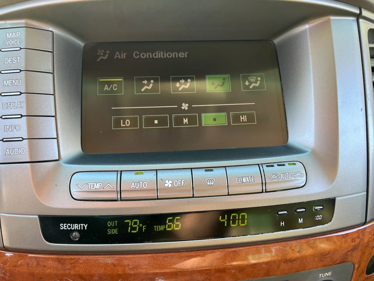

When I first start my 2006 LX470, this is the mode the AC starts at... Blowing really cold but note that the AC light is Yellow and not green.
I can touch the AC button and it will turn green with no noticeable change the the MAX Cold setting. Still blowing cold air...

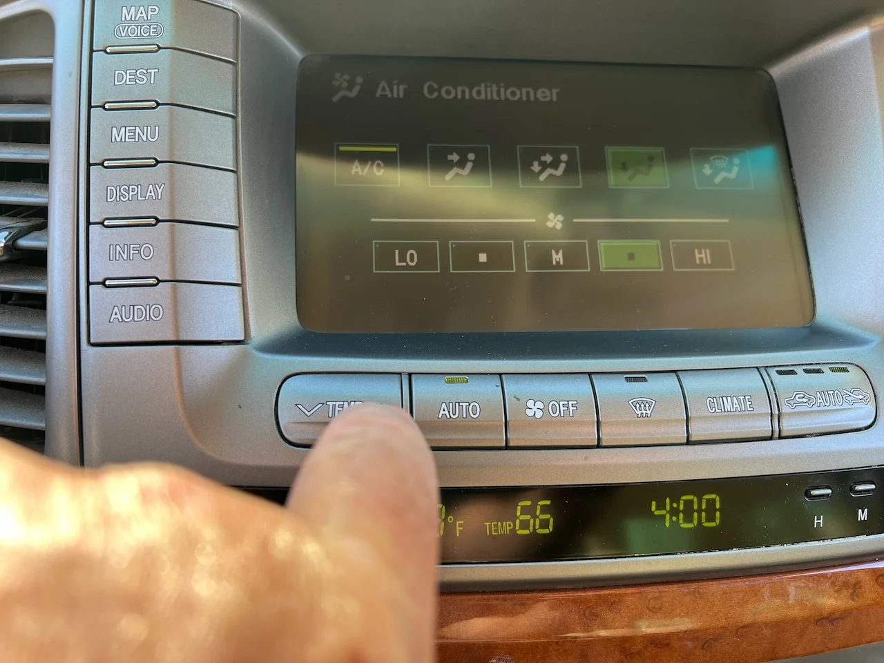

I hit the "UP" side once on the TEMP button and the system goes to full heat (and note AC is now Off indicated by the yellow light)
Blowing hot air at my feet... I can switch the Air Flow Control Switch to other exit ports but it is still blowing Hot Air.

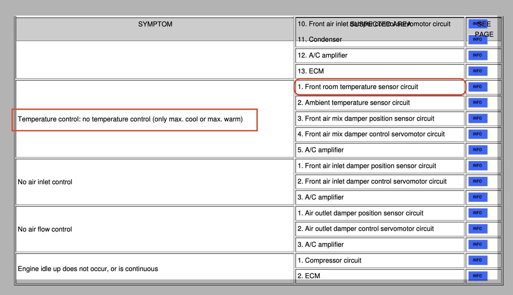

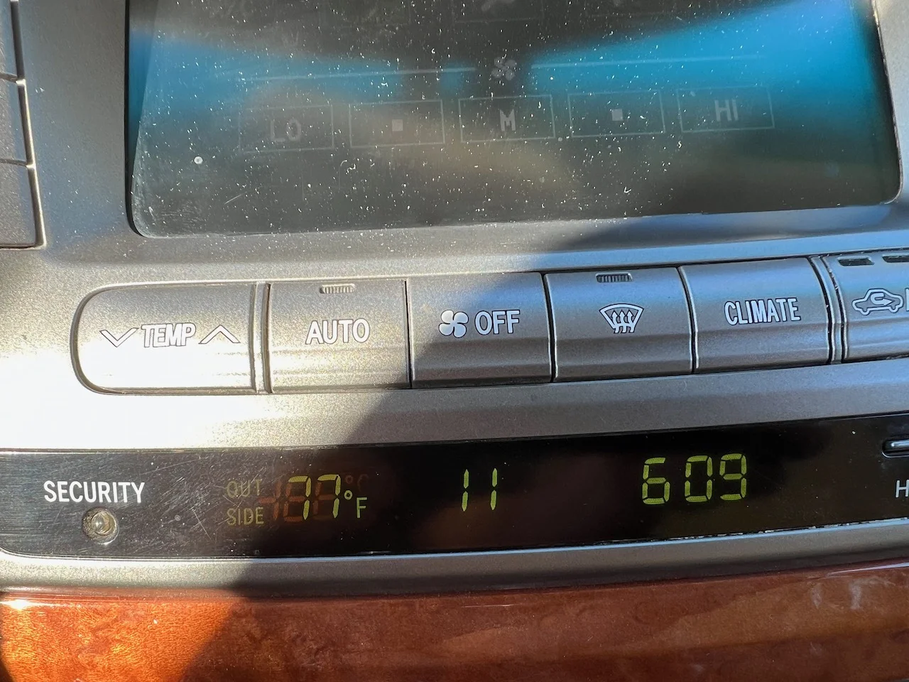

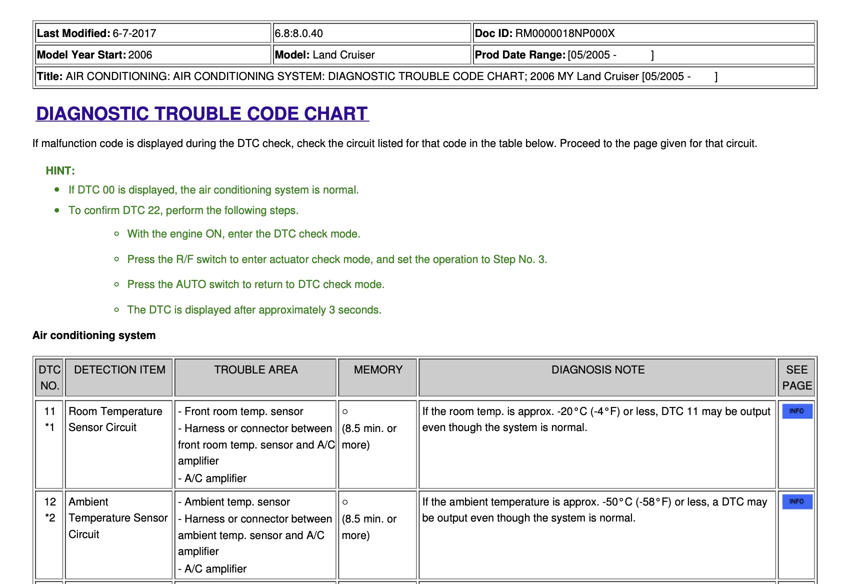

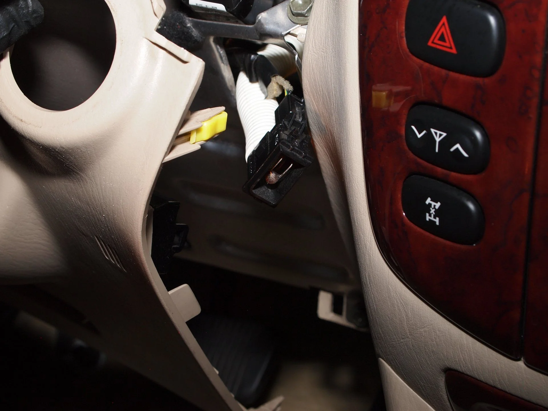

Here is what I came up with... I was able to access the in-car diagnostic. I watched a short video and saw what I was doing wrong.
The code came up #11 : In-Vehicle Temperature Sensor .

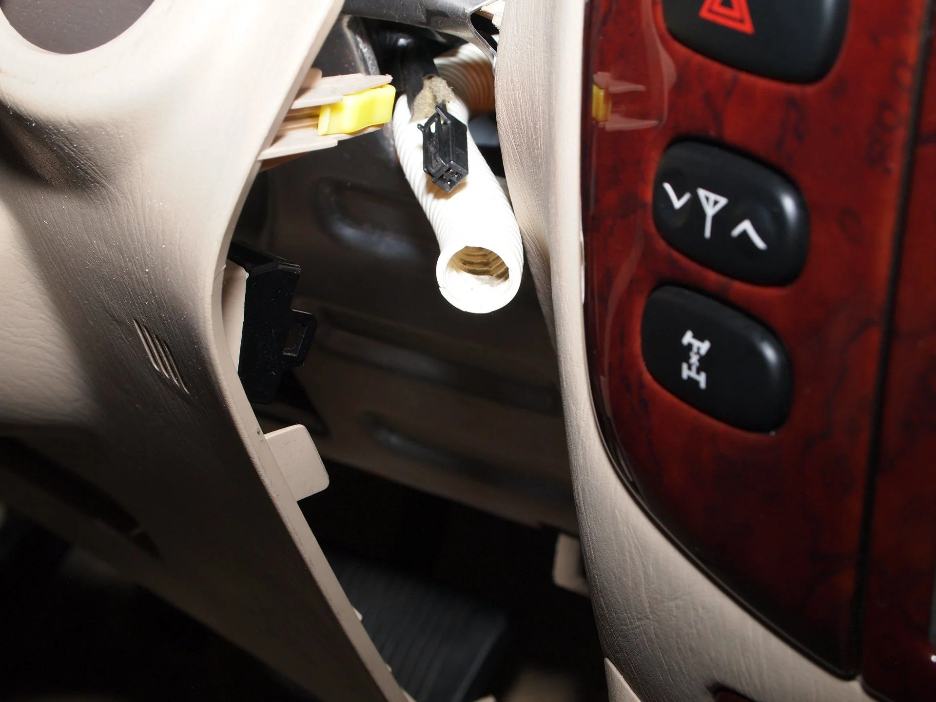

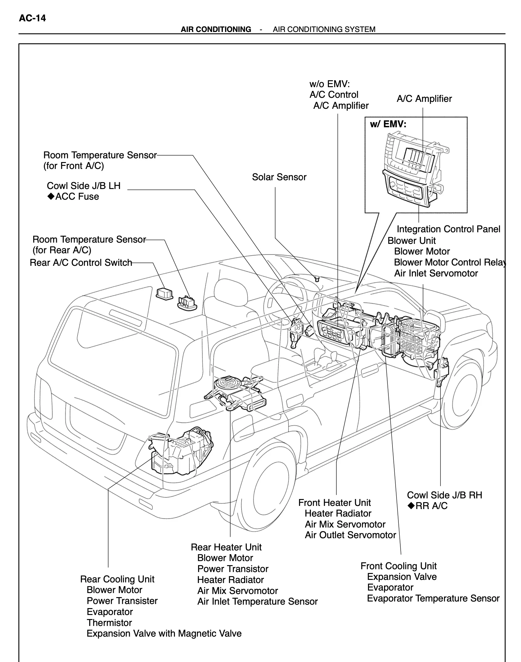

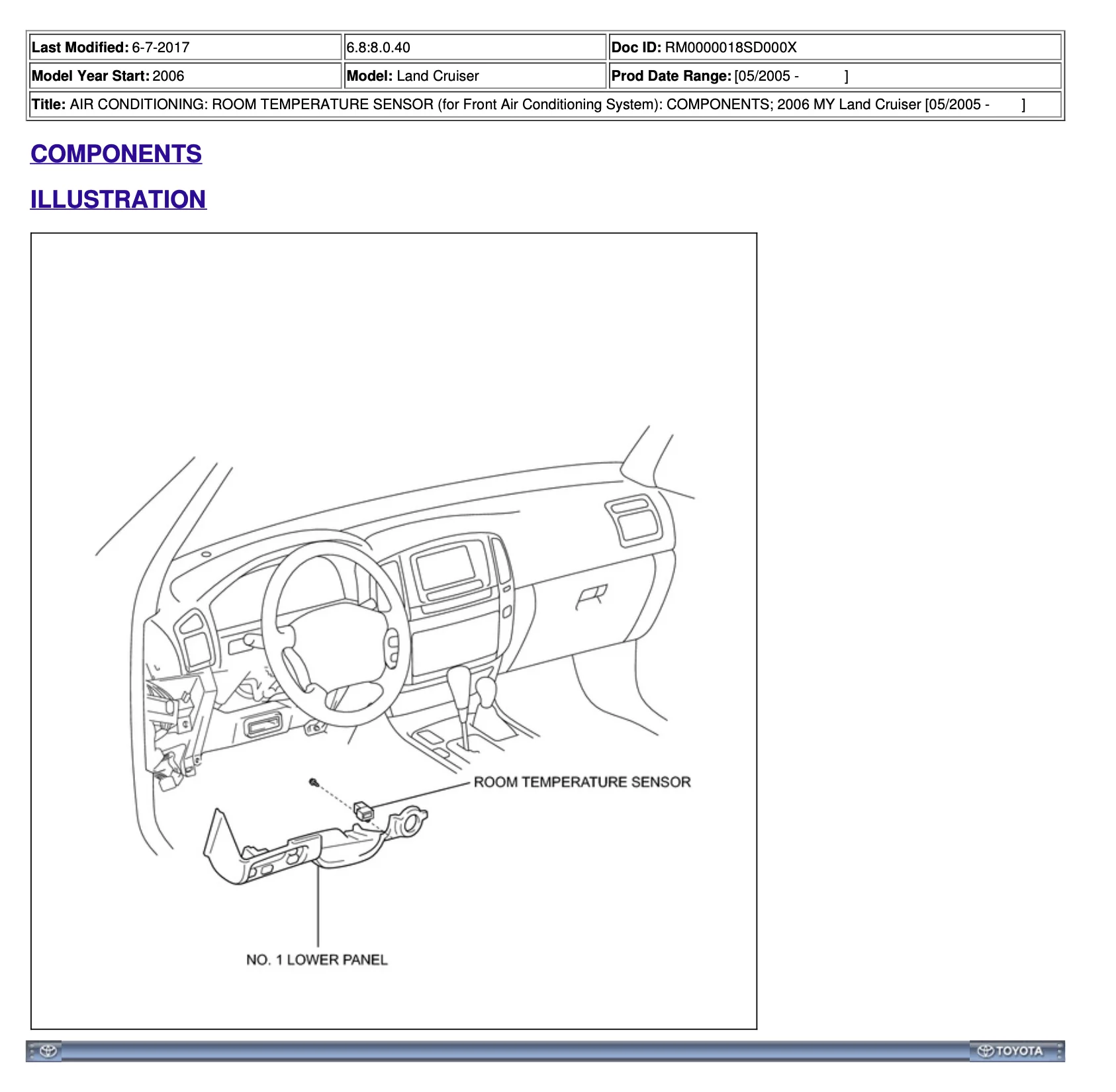

I located where that was... an lo-and-behold, it is behind the No. 1 Lower Dash Panel. I had the shop also install my Telescoping Steering Wheel Motor since my back wouldn't let me twist into a position to do it. I think they unclipped the Temperature Sensor when they removed that panel for access and didn't clip it back together when they reassembled the dash.

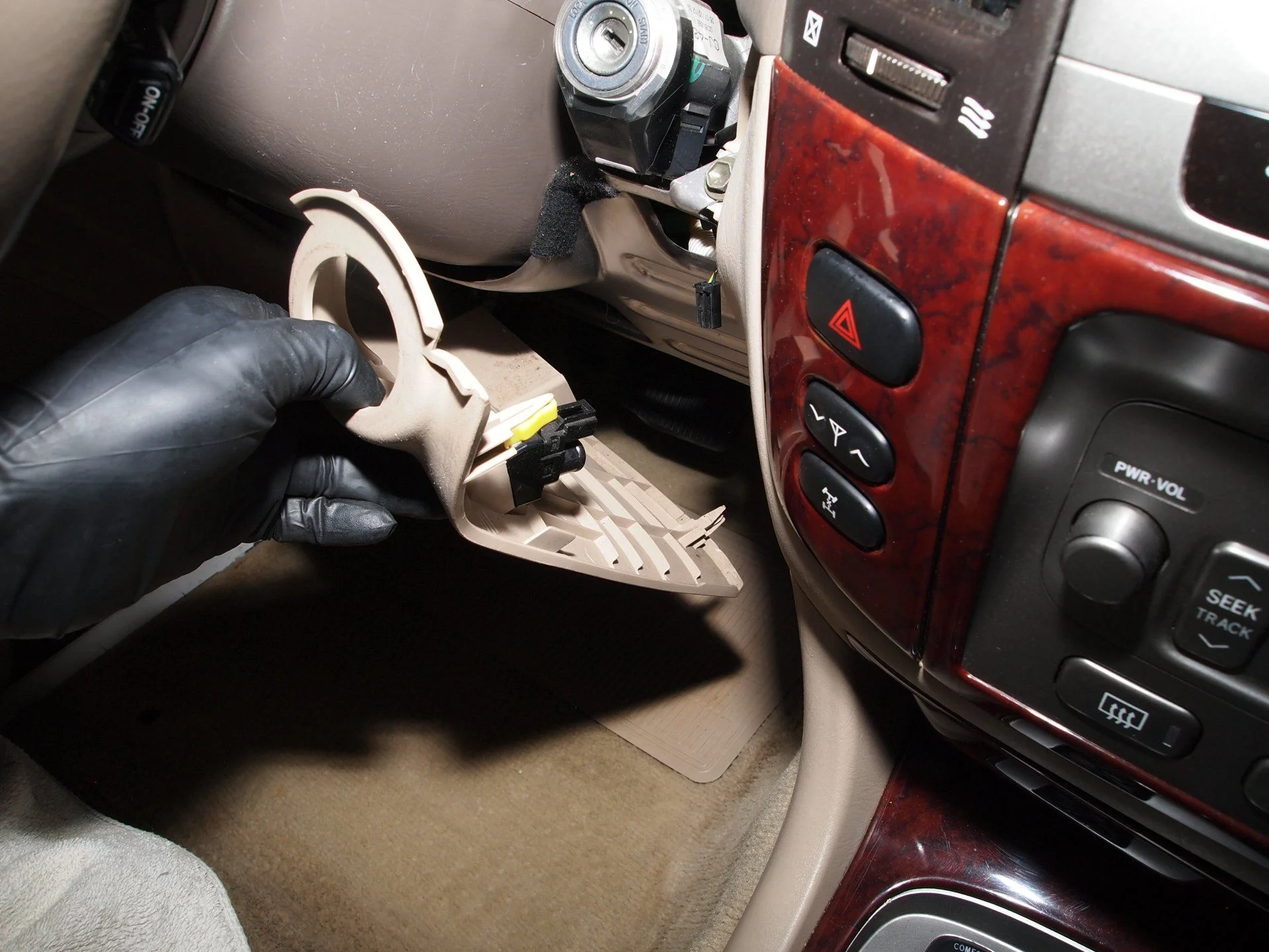

I noticed that #1 Lower Panel wasn't sitting flush when I went to see the location of the sensor. Turns out the lower clip is broken...
Thanks to all of the information available of this website, I was able to spend a couple of hours figuring out the problem. The shop wouldn't do it...
I had this exact same problem once, i forgot to plug that back in after doing some work under the dash. glad you figured it out
Took it back to the shop. Tech took the panel off and plugged the sensor in. All works. He apologized profusely for missing that. It only took me 3 round trips at about 45 minutes each way…
