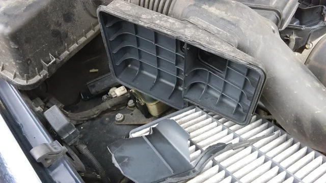

Air cleaner blew up, won't start now. Oh god...

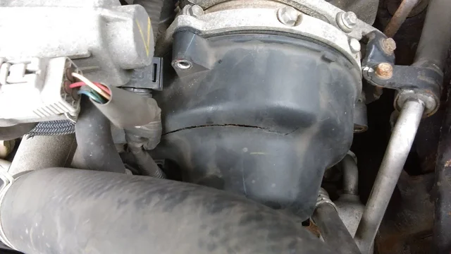

Ok so just talked to the mechanic. He says so far the timing belt broke and the cover on the front is cracked and the sprocket is off...
Not sure exactly what you/he mean by the sprocket is "off", but that doesn't sound typical of the belt breaking first.
So far, I'm guessing the problem started with a mechanical failure in one of the heads and that lead to the broken belt, not the other way around. There's just too much non-timing belt type of damage? intake valve failure? Cam bearing failure? Cam pulley failure? Pics would be interesting.

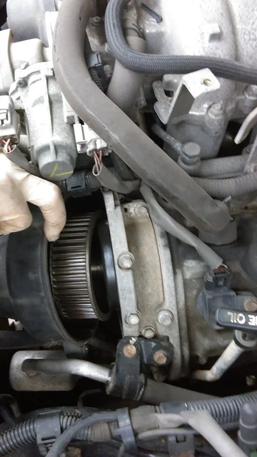

Wow, with the cam sheared off like that I'd start motor shopping. I do wonder what went on in that bank though, if the shaft simply was bad and sheared or if something stopped the cam or cam gears inside the head.

Yikes! I wonder if just replacing the top end and keeping the short block might work. There are a lot of 4.7's out there (if they'll interchange).
I think those pictures answer the interference engine question!
Very impressive carnage.

I'm dense, but don't get how that means interference engine. If the belt broke first, I don't get how a valve interference would shear the cam shaft, since the belt wouldn't be holding it fixed. If something else let loose first and froze the shaft, you'd think the belt would give before the shaft? I don't see how the shaft would shear with the force of an unbroken belt against interfering valves? Again, I'm an engine internals newbie, so maybe I'm missing something. But it seems more likely that something caused that cam to sieze first, then broke the belt, causing misfire, etc.?
Still inconclusive. Anyone in guessing until the heads are removed, and then opening up the oil pan if the heads don't tell a story.

Is that a designed shear plane that I see? Looks like it fractured there because it was designed to fracture there. Or are those bite marks from a press trying to get it out?
I wonder if the gear kept spinning but the cams stopped? The cam sensor pickup is on that side, right? If so, the ECU may have thought everything was fine and it could have been pumping air/fuel mix through an open valve into the intake which could explain the explosion on the intake side.
I'm with you on this. I think you're going to find a problem deeper in. That's an enormous amount of back pressure to splode the airbox like that.
