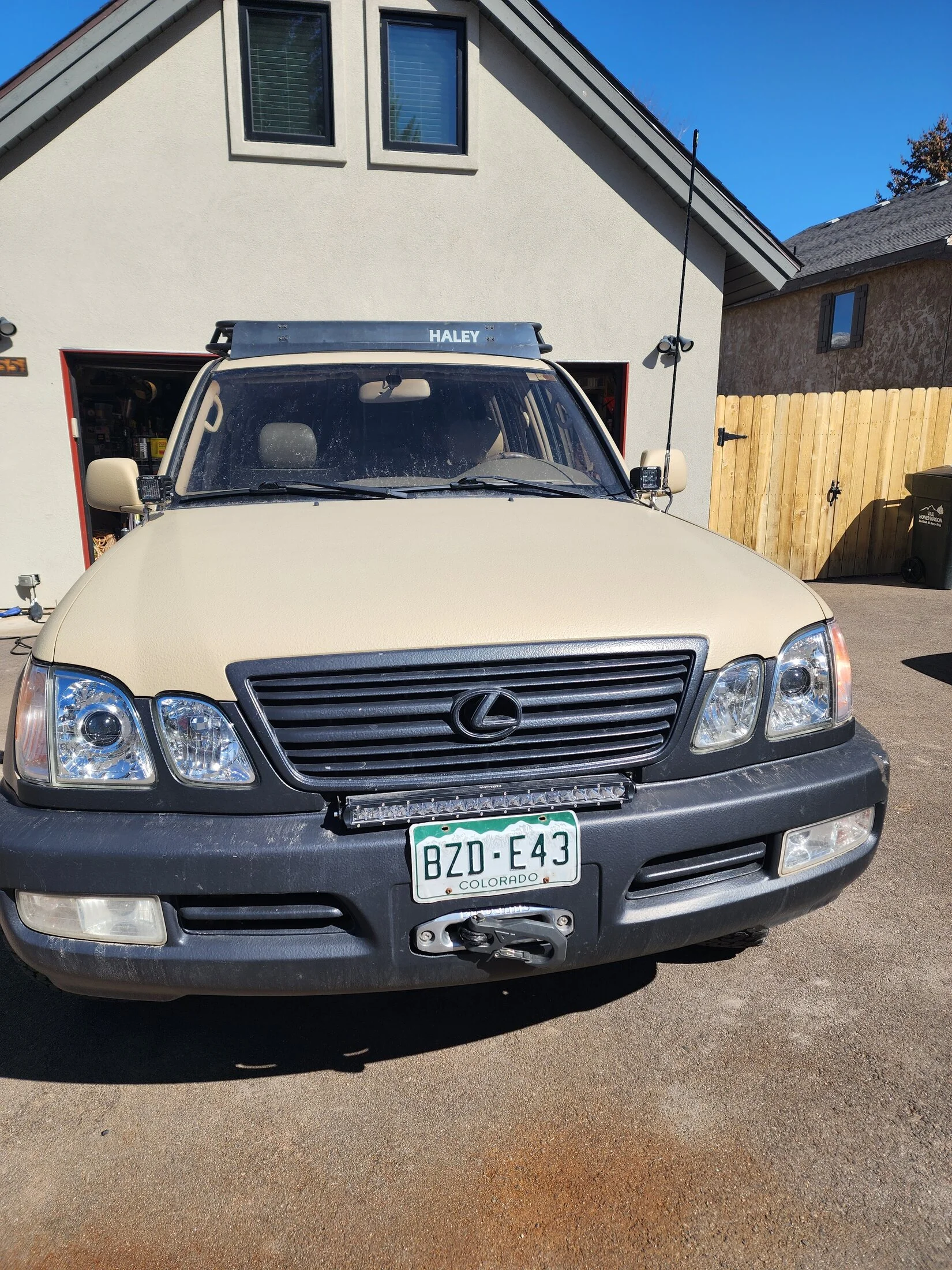

Hello everyone,
I'm looking for recommendations on shops who know and work on AHC systems. Mine is running fine, and I don't want to get rid of it. But I do want to try to get the most out of it both in longevity and performance.
Anyone have a recommendations either front range or western slope?
Let me know.
(Pic, because why not!)
