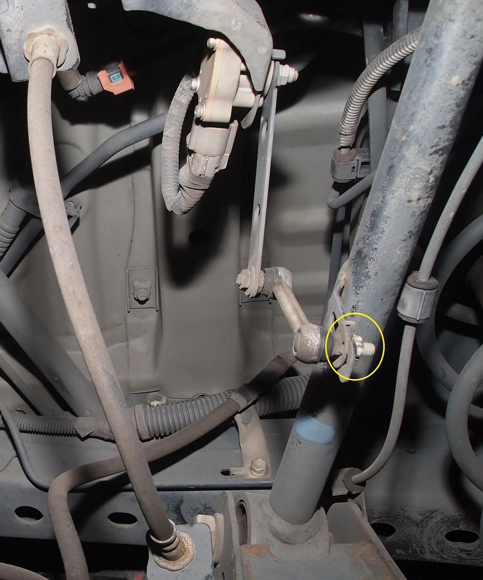

After a lot of struggle with my helper mechanic, I decided to go under the car to see what was happening. It was obvious that the rear sensor lever was facing the wrong direction (facing directly down actually). My helper had put if the wrong way. I flipped it over and the car immediately rose to High.

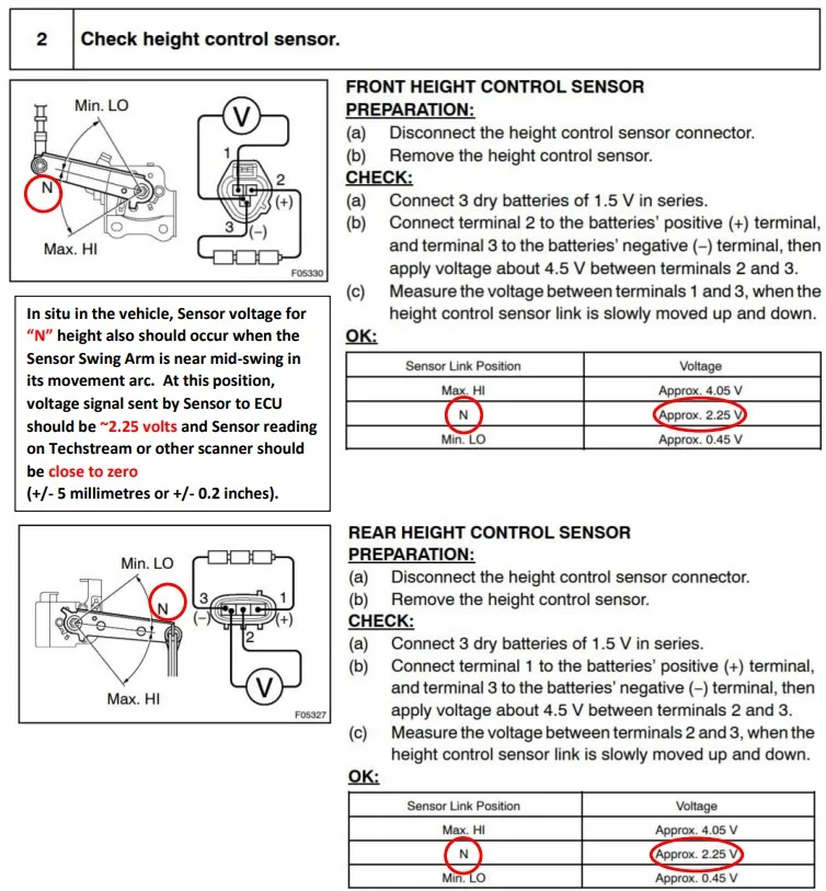

To start from the begining .....
The point is that if the AHC system and all Height Control Sensor circuits are healthy (no faults), then when the centre console switch is set at "N" height setting, and the engine is running, the Suspension ECU will cause the the AHC Pump and the Levelling Valves to operate, allowing the vehicle to rise or fall at Front AND Rear, until the same signal of ~2.25 volts is received by the ECU from EACH of the three Height Control Sensors (Left Front, Right Front, and Rear). Based on these signals from the Height Control Sensors, the vehicle then settles at "N" height, Front and Rear.
Similarly, when the centre console switch is set at "LO" height or "HI" height, the Suspension ECU will cause the AHC Pump and the Levelling Valves to operate, causing the vehicle to rise or fall at Front AND Rear until until the correct signal is received by the ECU from EACH of the three Height Control Sensors (Left Front, Right Front, and Rear), for "LO" or "HI" height -- whatever has been selected.
These voltages are not shown on Techstream or other scanner. Instead, the read-out on Techstream for EACH of the three Height Control Sensors should be close to zero +/- 0.2 inches (or +/- 5 millimetres) at "N" height setting, as set out in the Factory Service Manual.
There is no way to set different individual voltage signals for any Height Control Sensor. The signal voltages for "LO", "N" and "HI" heights are permanently set inside the Suspension ECU. There is no way to adjust them (without re-designing the internal circuit boards within the ECU).
The 'ride height' of the vehicle at "N" height setting, measured hub-to-fender, should be about 19.75 inches or ~500mm (Front) and 20.50 inches or ~520 mm (Rear) to be close to the Factory settings for "N" height setting. These heights at are achieved by adjusting the Height Control Sensor adjusters at each Sensor.
The Suspension ECU then sets the 'ride height' for "LO" height setting and "HI" height settings.

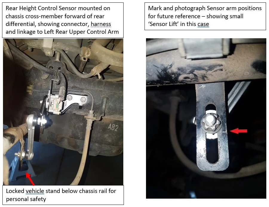

An Owner can choose a different 'ride height' of the vehicle at "N" height setting, measured hub-to-fender, by adjusting the Height Control Sensor adjusters as desired at the Front and/or Rear (such as for a so-called 'sensor lift') -- but being careful of other changes this will cause to alignment geometry and useable suspension droop. The signal voltages received by the ECU from the Height Control Sensors do not change; they remain the same for the 'new' "N" height setting. The Suspension ECU then sets the 'ride height' for the new "LO" height setting and the new "HI" height setting..

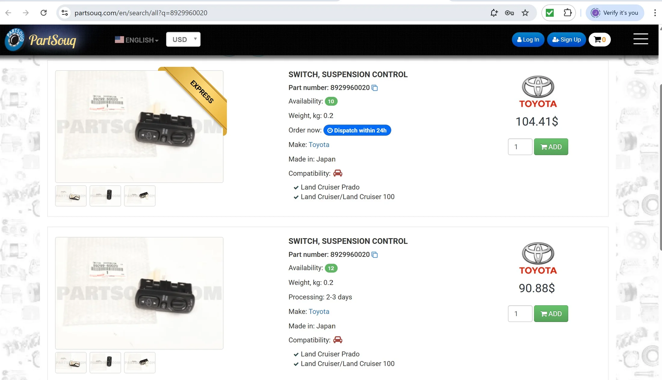

If the combined centre console switch for AHC (Height Control) and TEMS (Damping or Comfort Control) has been damaged as described, then it is most likely that loose or damaged connections will be sending erratic voltage signals to the Suspension ECU and causing the problems described.
To overcome these problems, it would be best to acquire and fit a new switch -- see Part Number 89299-60020 below.
Alternatively, some kind of electrical bypass might be possible with the help of an electrical person, using the attached Electrical Wiring Diagrams.
It would be essential to check that all Height Control Sensor circuits -- meaning the Sensors and the Connectors and the wiring Harnesses -- are free of any faults.
The point is that if the AHC system and all Height Control Sensor circuits are healthy (no faults), then when the centre console switch is set at "N" height setting, the Suspension ECU will cause the the AHC Pump and the Levelling Valves to operate, allowing the vehicle to rise or fall at Front AND Rear, until the same signal of ~2.25 volts is received by the ECU from EACH of the three Height Control Sensors (Left Front, Right Front, and Rear). Based on these signals from the Height Control Sensors, the vehicle then settles at "N" height, Frint and Rear.
Similarly, when the centre console switch is set at "LO" height or "HI" height, the Suspension ECU will cause the the AHC Pump and the Levelling Valves to operate, causing vehicle will rise or fall at Front AND Rear until until the correct signal is received by the ECU from EACH of the three Height Control Sensors (Left Front, Right Front, and Rear), for "LO" or "HI" height -- whatever has been selected.
These voltages are not shown on Techstream or other scanner. Instead, the readout on Techstream for EACH of the three Height Control Sensors should be close to zero +/- 0.2 inches (or +/- 5 millimetres) at "N" height setting, as set out in the Factory Service Manual.
The 'ride height' of the vehicle at "N" height setting, measured hub-to-fender, should be about 19.75 inches or ~500mm (Front) and 20.50 inches or 520 mm (Rear) to be close to the Factory settiings for "N" height setting. These heights at are achieved by adjusting the Height Control Sensor adjusters at each Sensor.
An Owner can choose a different 'ride height' of the vehicle at "N" height setting, measured hub-to-fender, by adjusting the Height Control Sensor adjusters as desired at the Front and/or Rear (such as for so-called 'sensor lift') -- but being carerful of other changes this will cause to alignment geometry and useable suspension droop. The signall voltages received by the ECU from the Height Control Sensors do not change; they remain the same for the 'new' "N" height setting. The Suspension ECU then sets the 'ride height' for the new "LO" height setting and the new "HI" height setting..
If the combined centre console switch for AHC (Height Control) and TEMS (Comfort Control) has been damaged as described, then it is most likely that loose or damaged connections will be sending erratic voltage signals to the Suspension ECU and causing the problems described.
To overcome these problems, it would be best to acquire and fit a new switch -- see Part Number below.

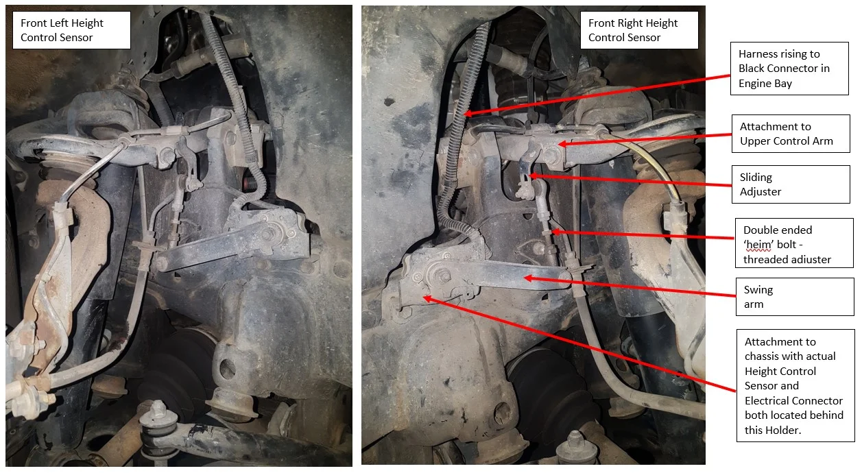

I slightly adjusted the front sensor linkage along the up and down slide while engine was running to understand the effect. I finally got positions that lowered the front to the desired level.

Meanwhile, i will start looking for another height switch with the hope that it can resolve the issue.
Update: in another attempt, we rotated the sensor lever downwards on the sensor splines. Starting the engine, the car came down to the exact height I want. Upon driving, it was perfect on tarmac. I then went to test off road. On a slow deep potehole, the sensor lever and slide gave way and bent, and the rear went completely down. I straightened them and the rear rose back to the same annoying High. I am able to drive slowly and just a little like that at the moment as i look for another lever.
As i look for height switch replacement, could anyone be knowing how I can hardwire TEMS (comfirt/sports) to be on number 3. Currently lt is quite soft. My standard TEMS driving mode has been number 3. And when on highway, number 4.
I can now adjust the rear height to any desired level using linkage adjustment. There is enough room for both downward and upward adjustment. It was a slight bend on the sensor clamp (for lack of a better term) that was causing me all the pain. When i straightened it, all was well. I can now drive on any terrain seamlessly again.
