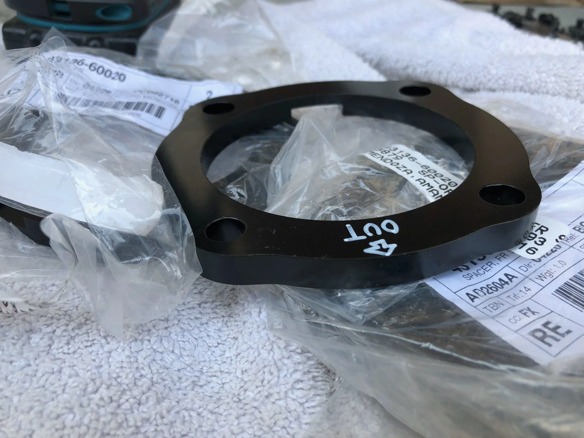

PS: I found the Front Spacers (Toyota part: 43136-60020 ).

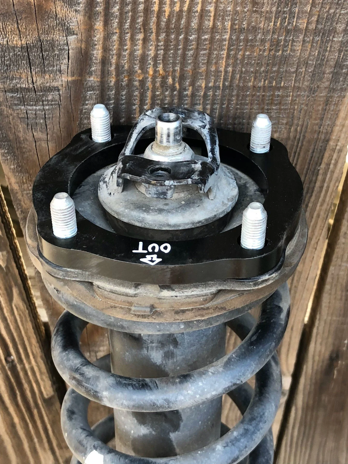

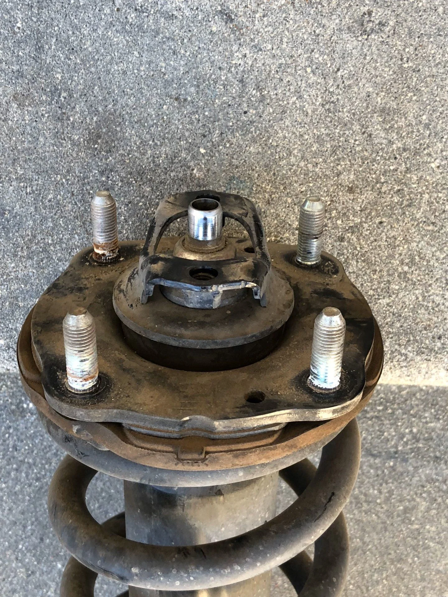

Hi there,
Finally got the front spacers...and planning for the installation.
I am wondering if AHC liquid will spill everywhere when I'll break the line... :eek:
Any recommendation on how to best do the job?
Hi there,
Yes, there will be fluid!
Connect a hose to the bleeder and direct into your temporary storage container of choice. You'll want to have the reservoir topped up so that you don't introduce air into the system from that side. I'm not sure if the correct setting will be L or N; probably L to get as much fluid into the reservoir as possible prior to starting.
If you haven't baselined the AHC fluid yet you'll need get 5 liters to do a full exchange. I saw somewhere on here that the shocks are also a candidate to be pre-flushed as the fluid in them, while new, has some minor contamination in it (don't panic, that's just what I recall, but you might want to search up that thread and see what your tolerance level is).
